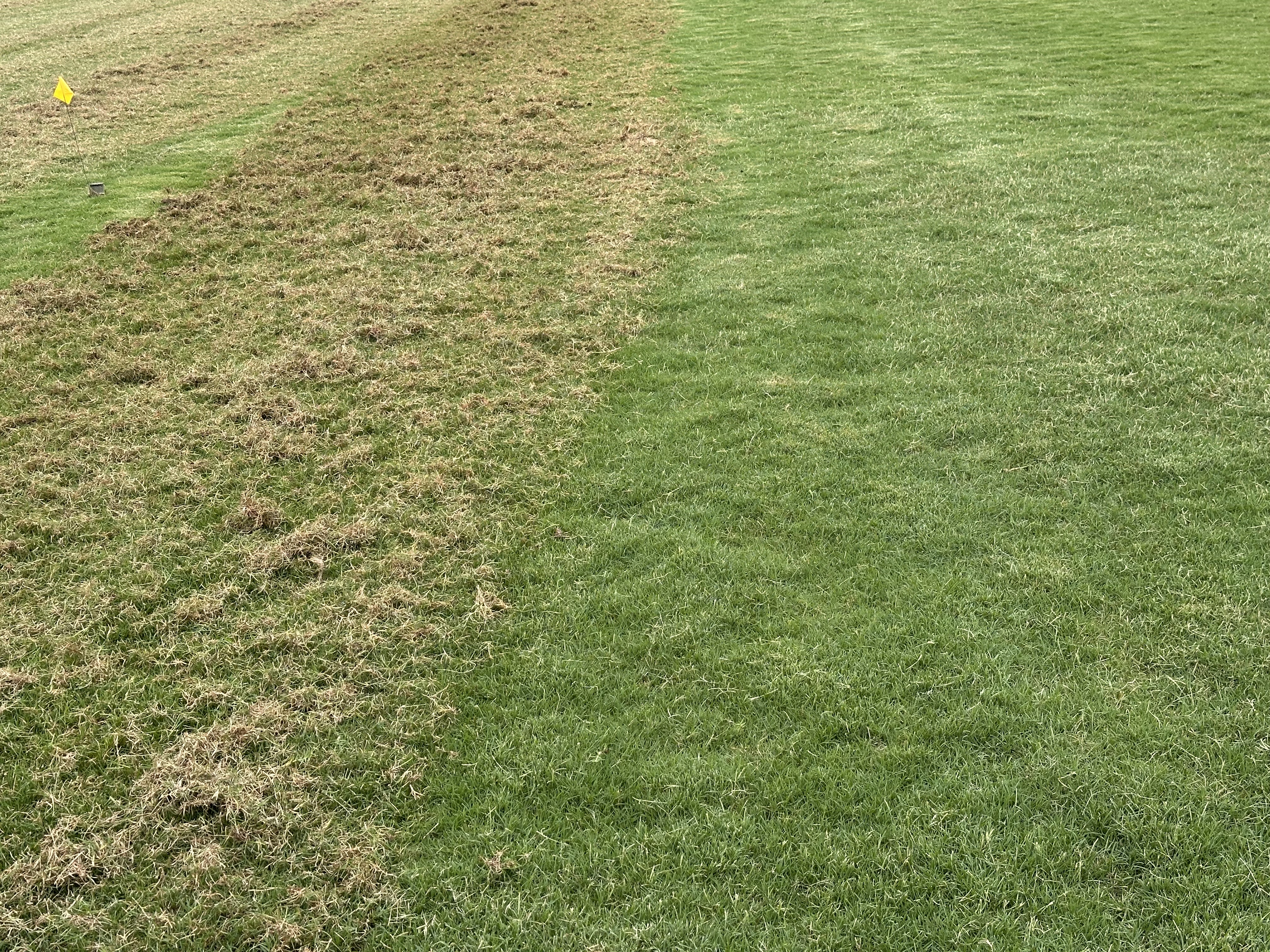

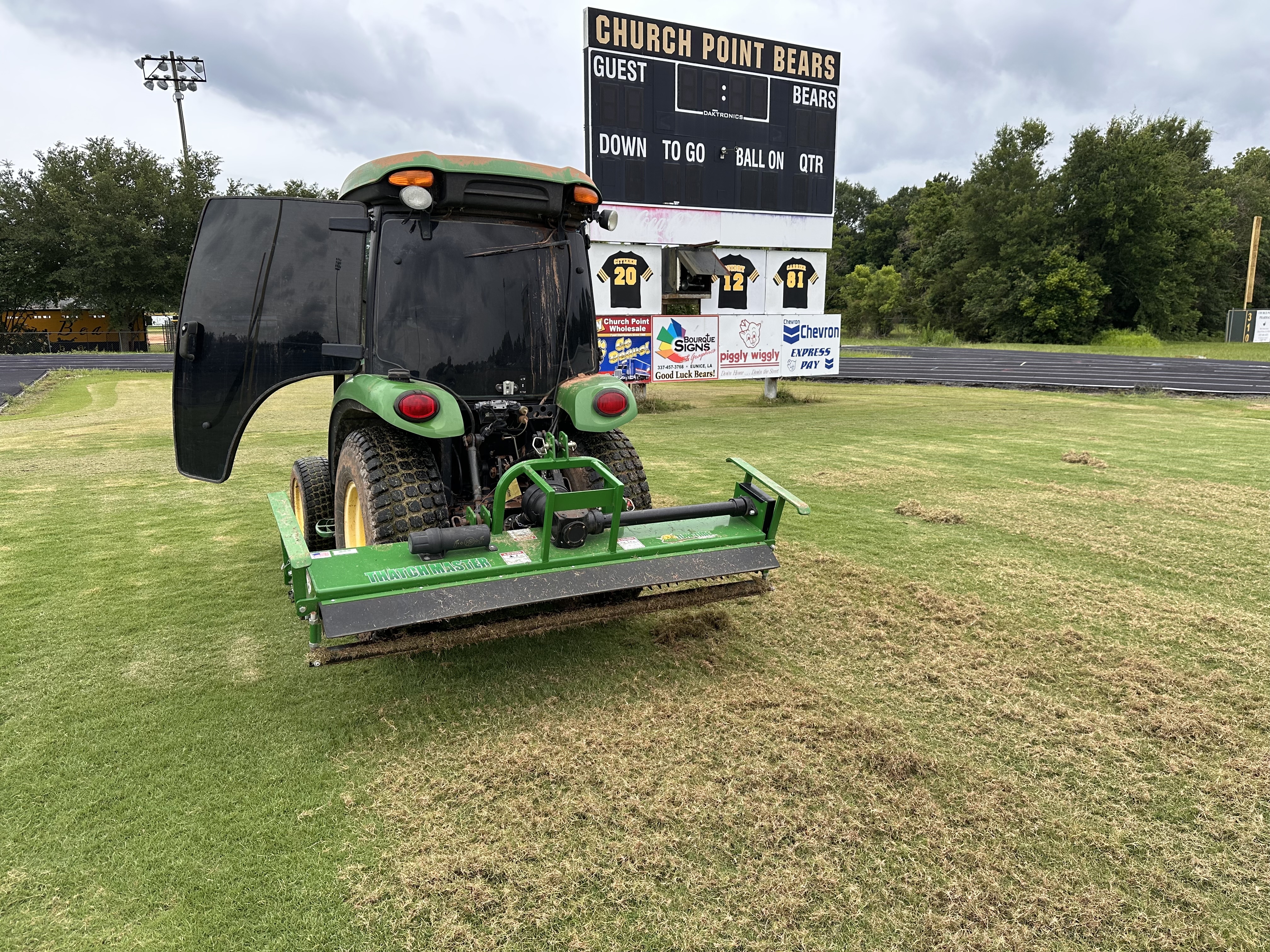

Do you use a finish flail mower with dethatching knives?
   / Pictures from an athletic field contractor
#273

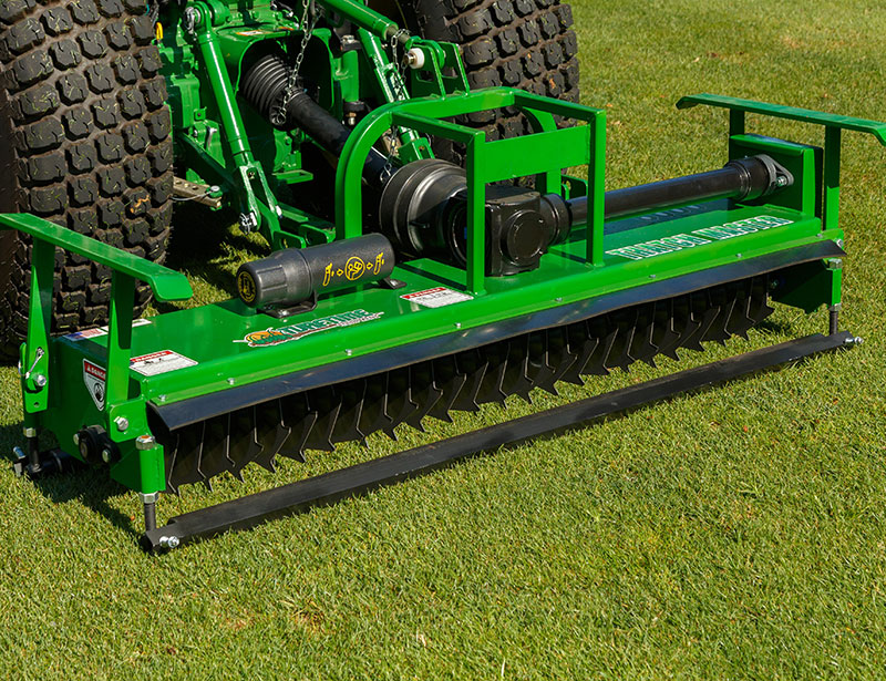

I have a Thatchmaster Verticutter that I use on some fields.

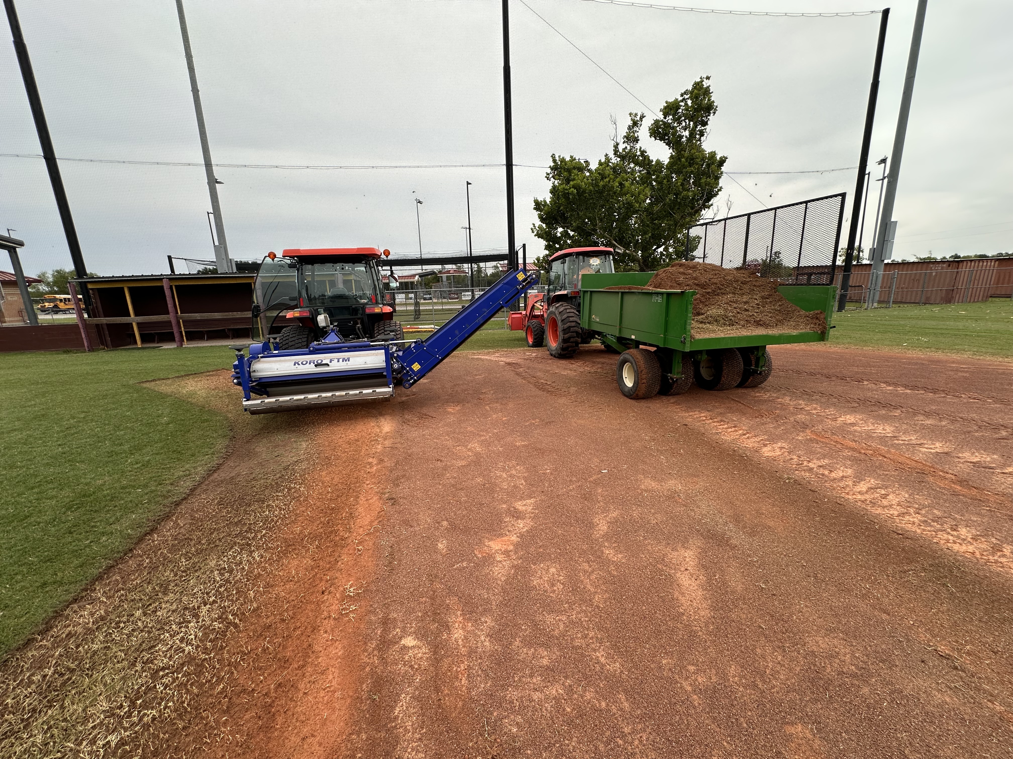

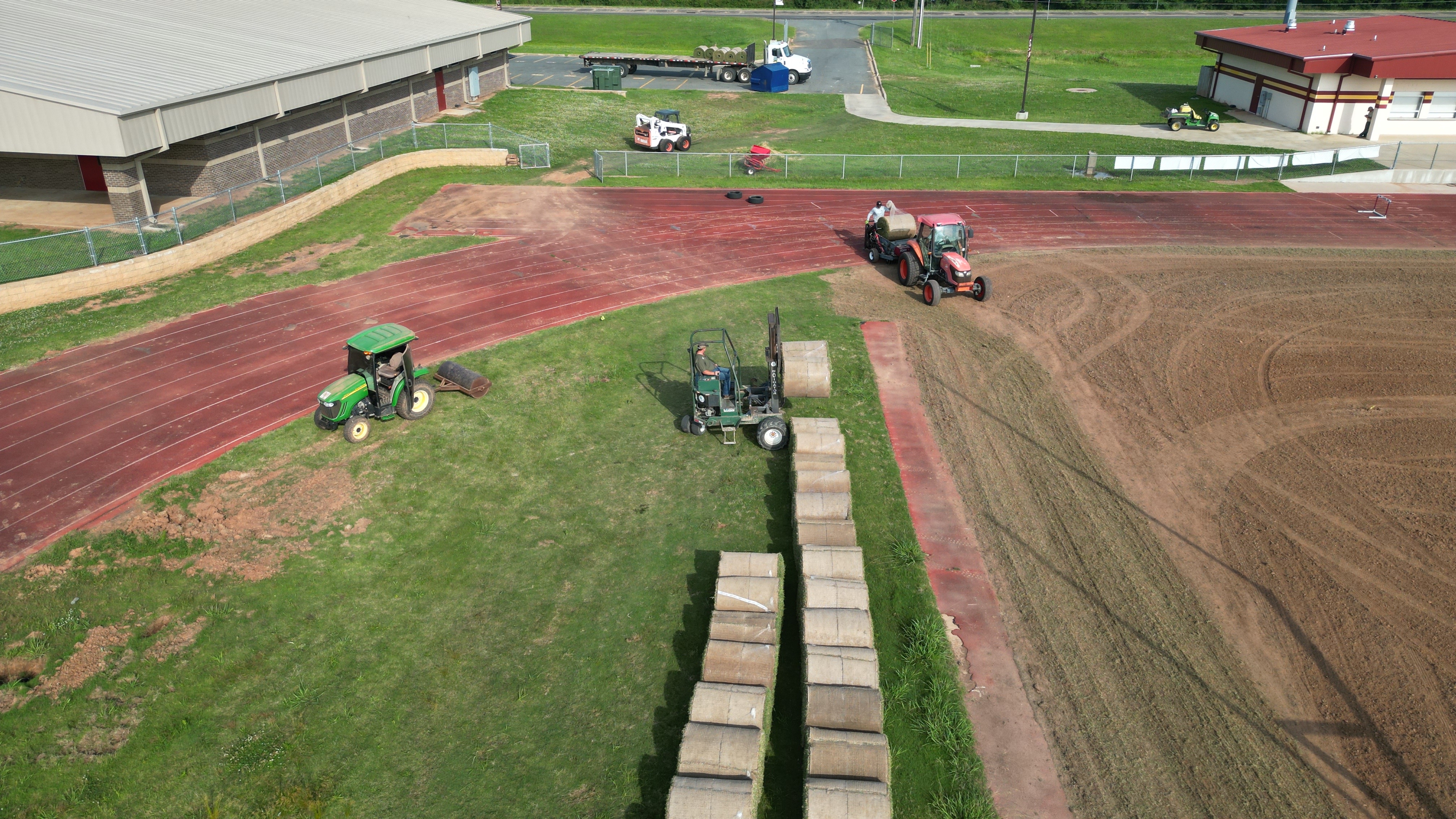

There is no need to cut holes for the sprinklers in this case, because the sod is being shredded as it goes through the sprigging machine.
When we are laying solid sod and not sprigging it, yes, we cut holes for the sprinklers to pop up.
In this case, we used 43 rolls of sod to sprig this field. Last time we installed solid sod, we used about 400 rolls of sod.
The difference is about $50,000, but the solid sod field would be ready for use in about 15-30 days, whereas the sprigging takes about 70-90 days.

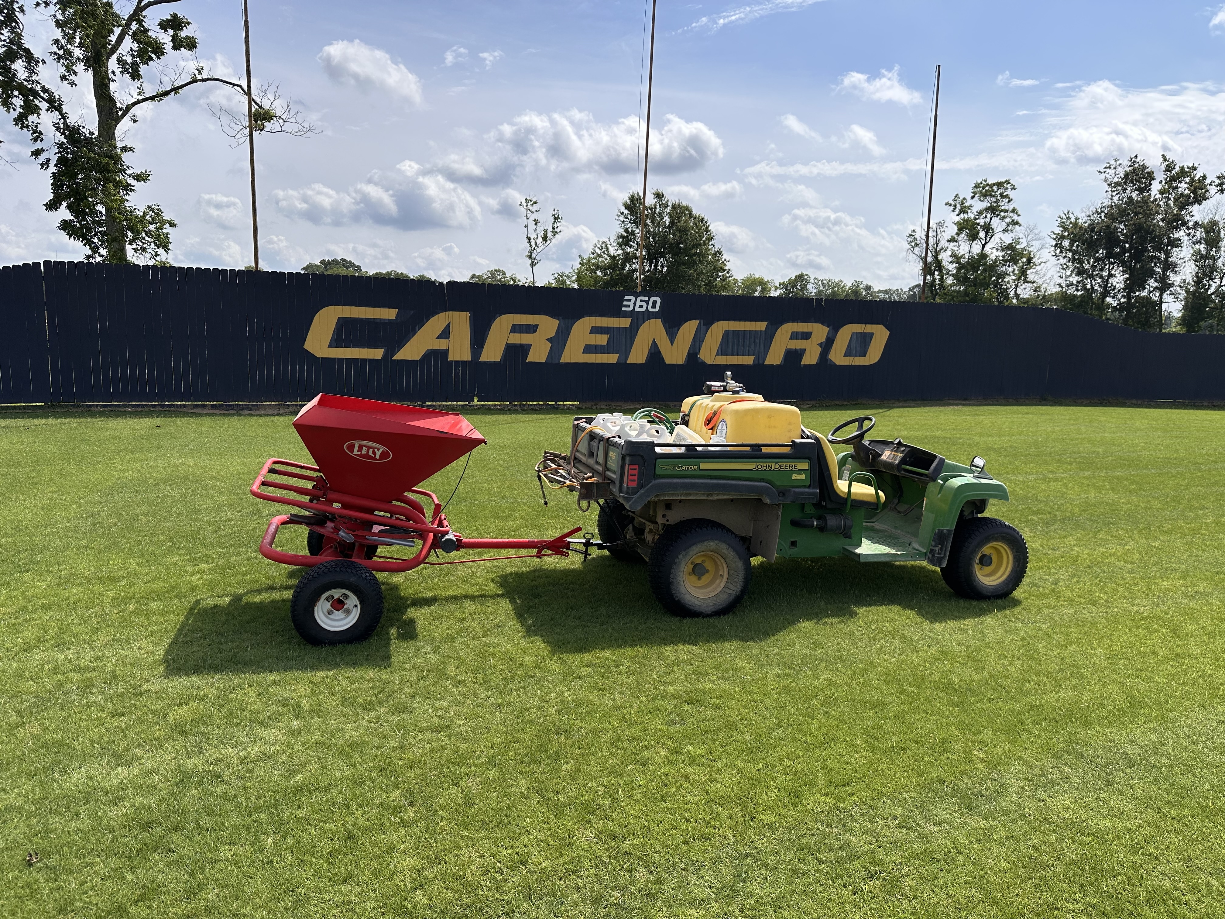

Sometimes we make the decision to work, or not to work, on a holiday based on the weather forecast. Today, I applied fertilizer and herbicide on a baseball field.

I hate lawn thatch, have you considered using a flail mower equipped
thatching knives with a pick up basket that uses a hydraulic basket lift
to dump it to do this job in one pass?

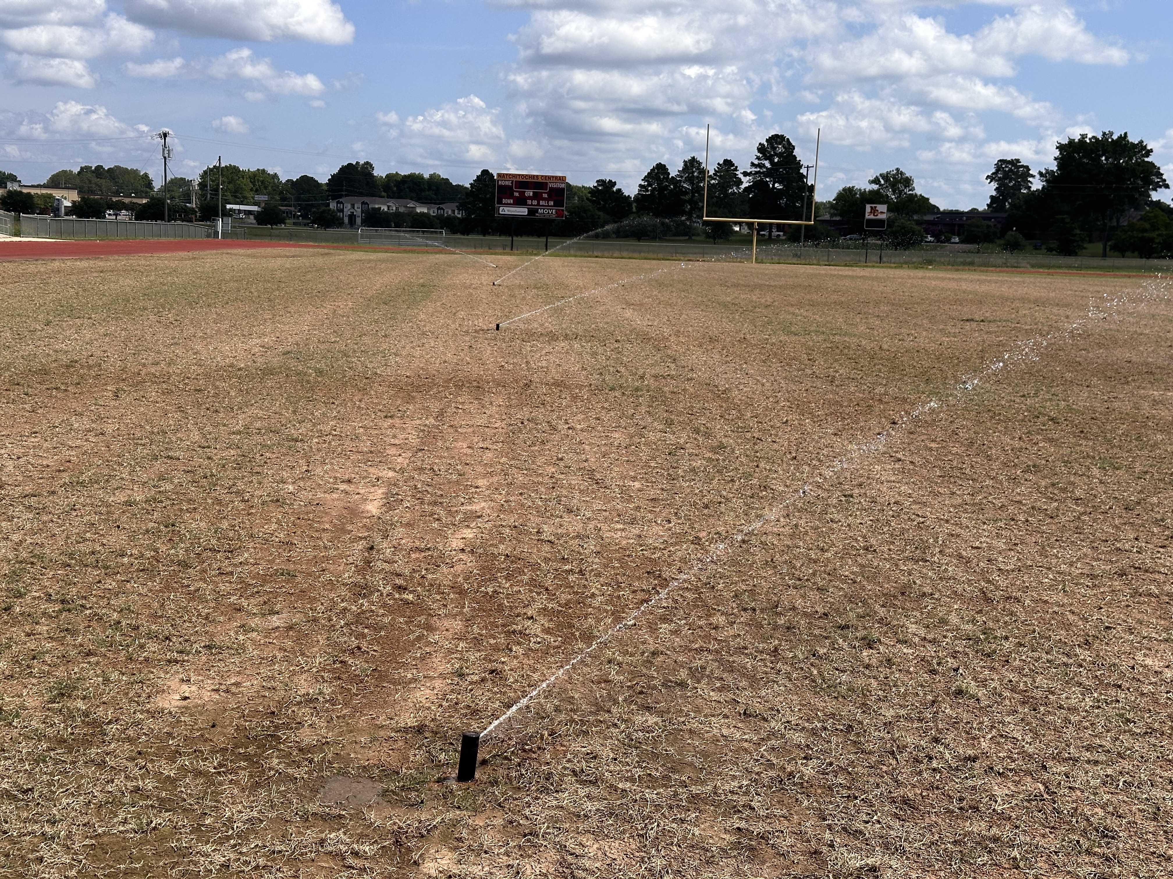

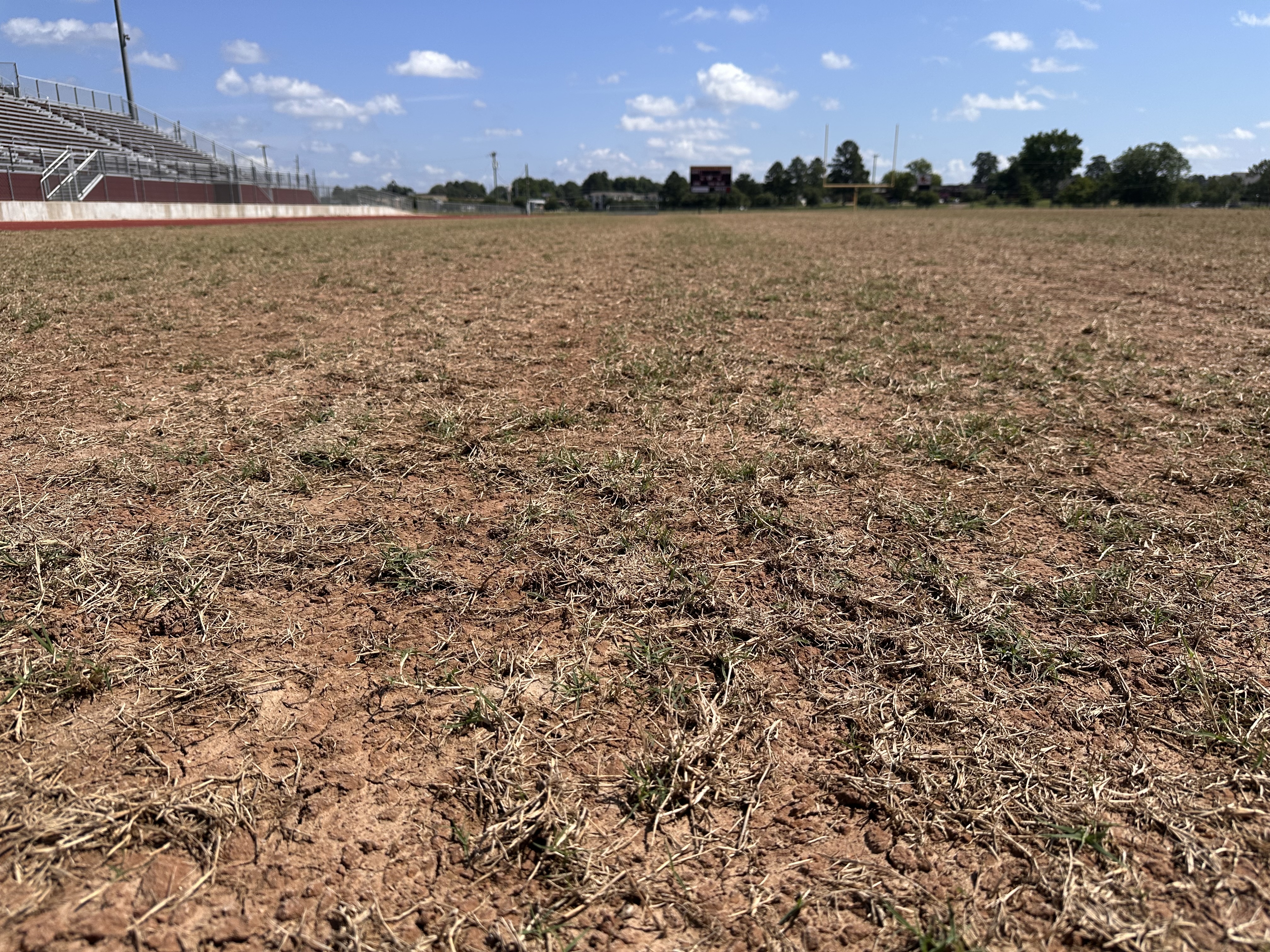

I went check on the field we sprigged almost 2 weeks ago. I'm pleased with the progress. I'll give it about 2 more weeks to get more roots down, then I'll start pushing it hard with fertilizer.
