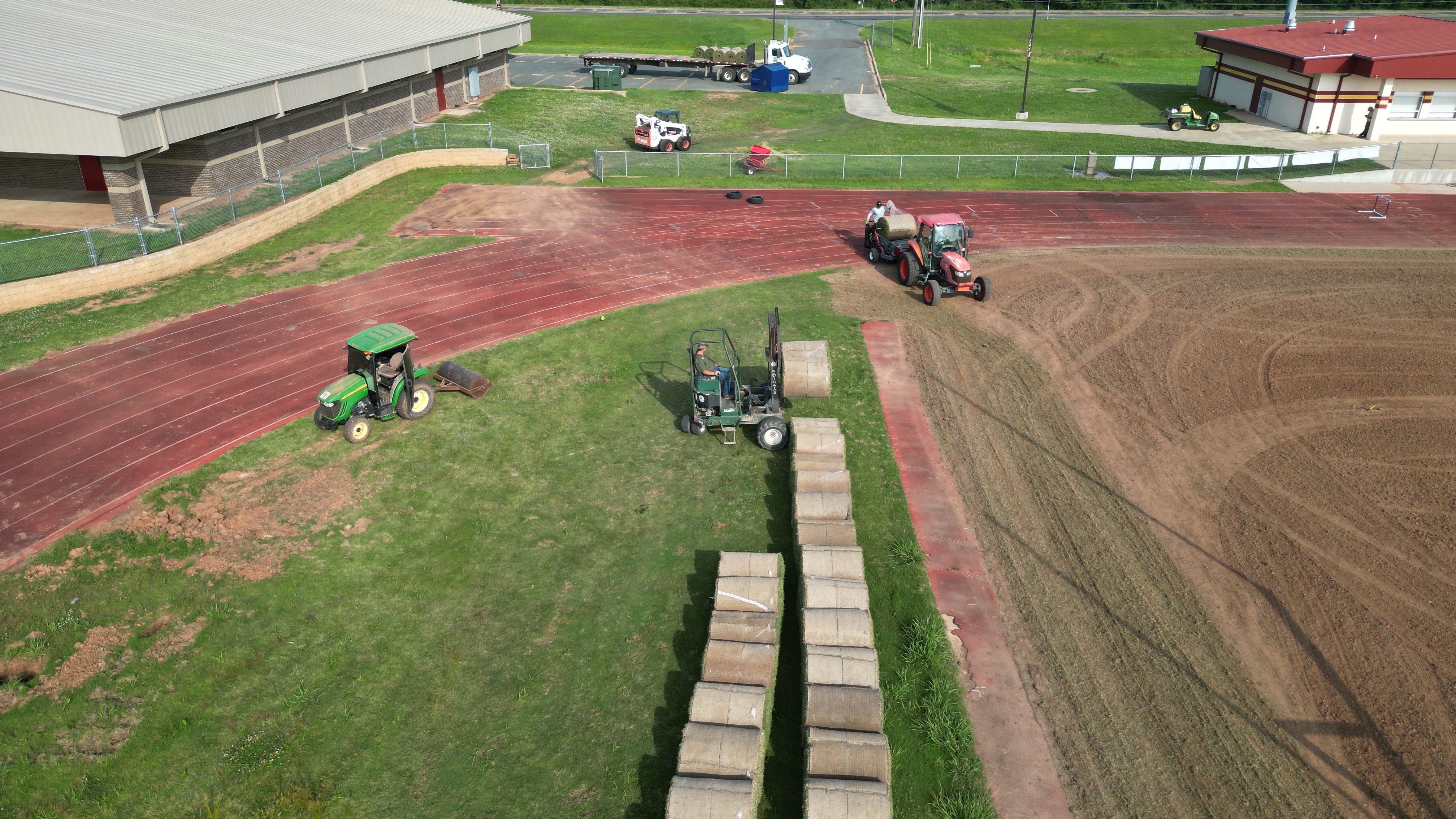

There's a lot going on in this pic, but we getting started with planting.
   / Pictures from an athletic field contractor
#264

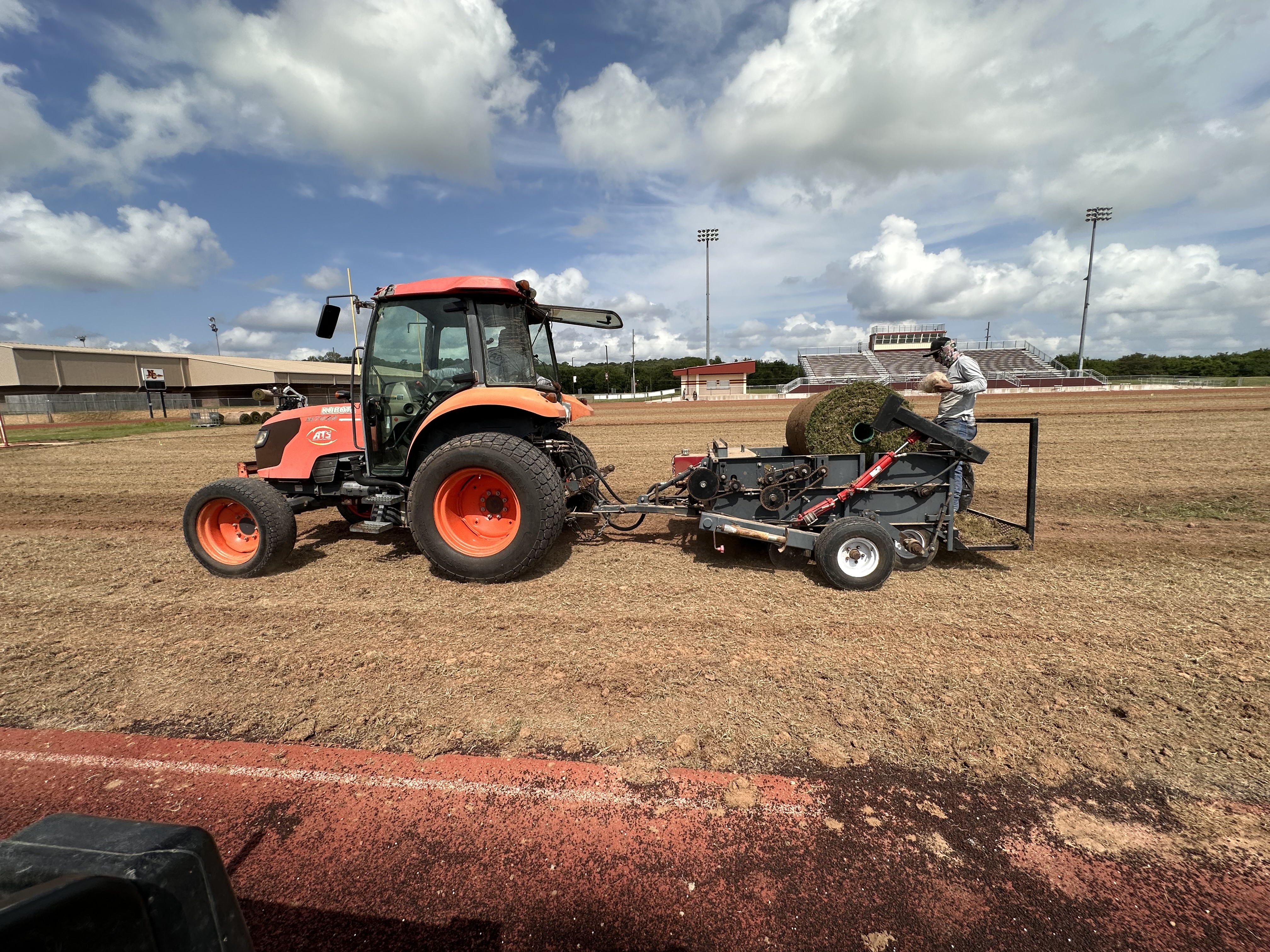

How many workers does the planting take?
Basically 3 men. One on the skid steer loading the sod into the sprigging machine, one on the tractor and one on the sprigging machine removing the netting. I'm on site also to roll the field after planting and to apply herbicide and get the irrigation going. Also in that picture you see the truck driver unloading the sod with a forklift.
