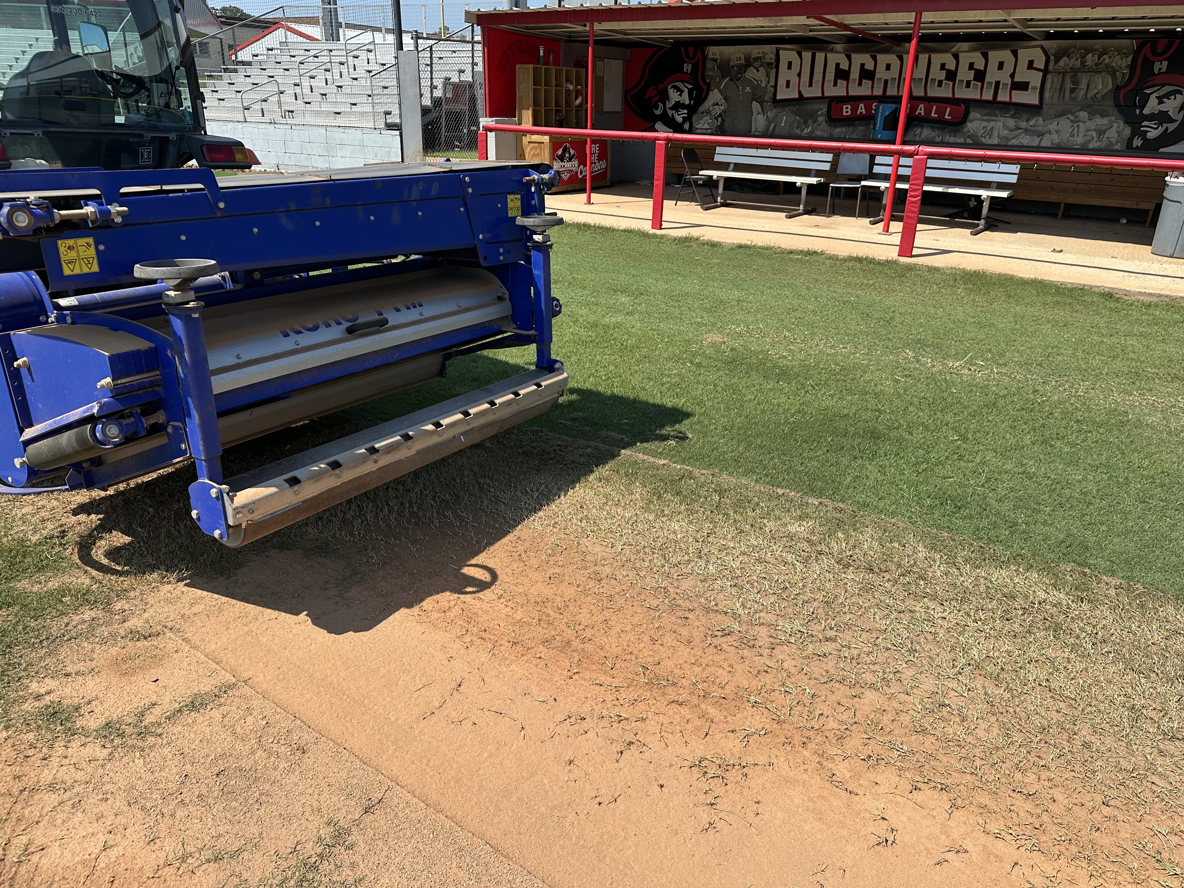

Impressive. Are the wearable parts easy to get? Online?
The Imants machines are made in the Netherlands. The importer is in North Carolina. So that's the only place to get most of the parts. But, on these 2 machines, the blades are the only thing to wear out. And they keep those in stock.

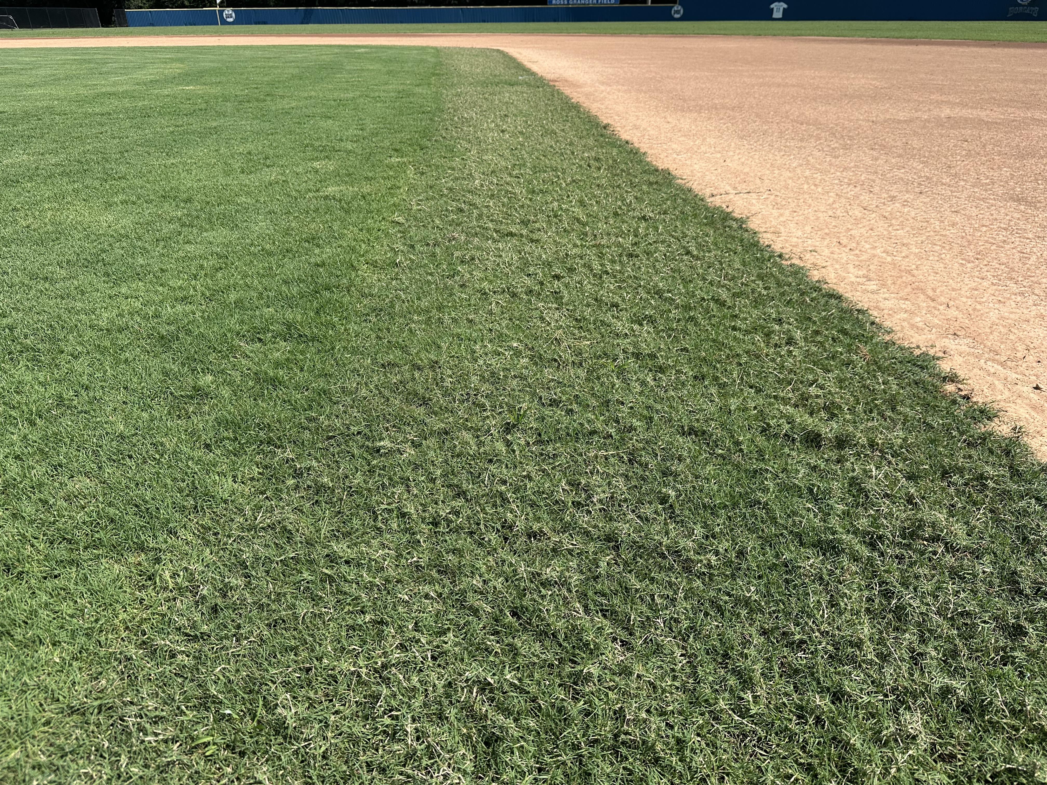

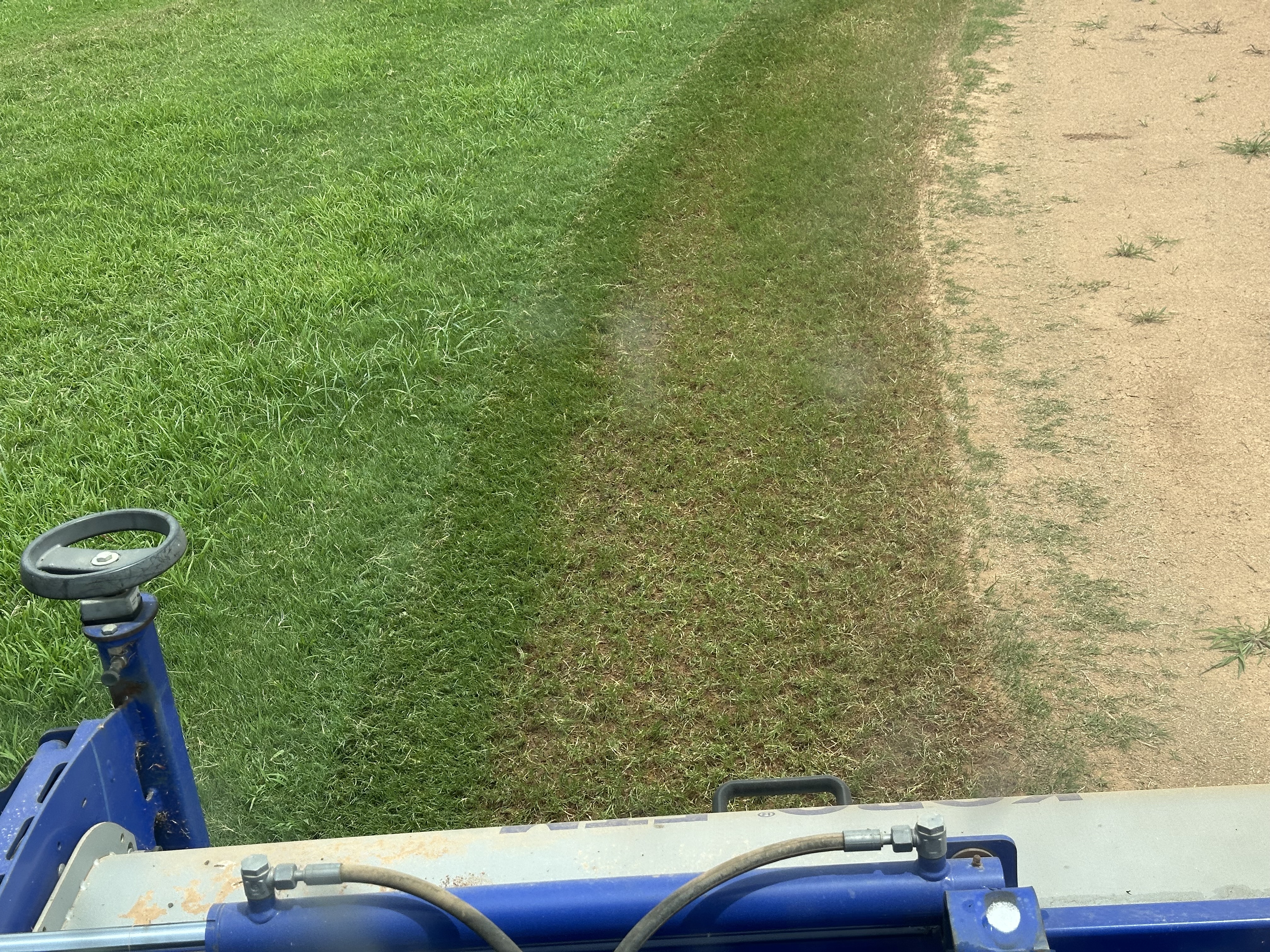

This is a field we did a lip removal on July 16. The first pic was taken then.
This pic was taken today (August 8) and shows how the Bermuda grass has recovered well, as expected. These pics are not the exact same spot, but are on the same field.

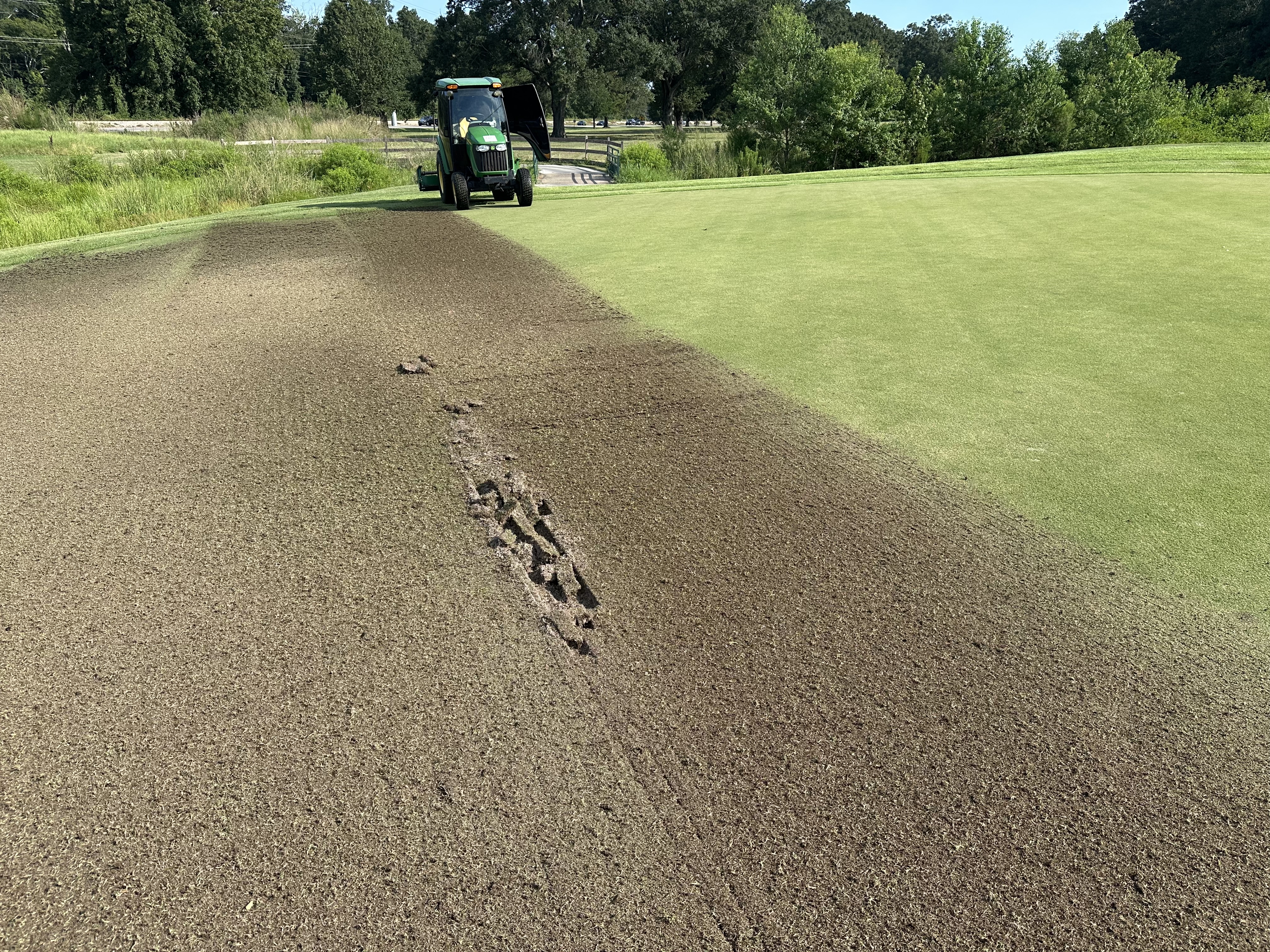

Verticutting the last of 5 golf courses today for BREC (Baton Rouge Recreation).
Things don't always go the way you want.
We created damage like this on almost every green.
We adjusted the verticutter many times, and nothing seemed to work.
The grass did not have enough roots in some areas and would pull up very easily.
   / Pictures from an athletic field contractor #355
Is that when you get the rake and shovel out?

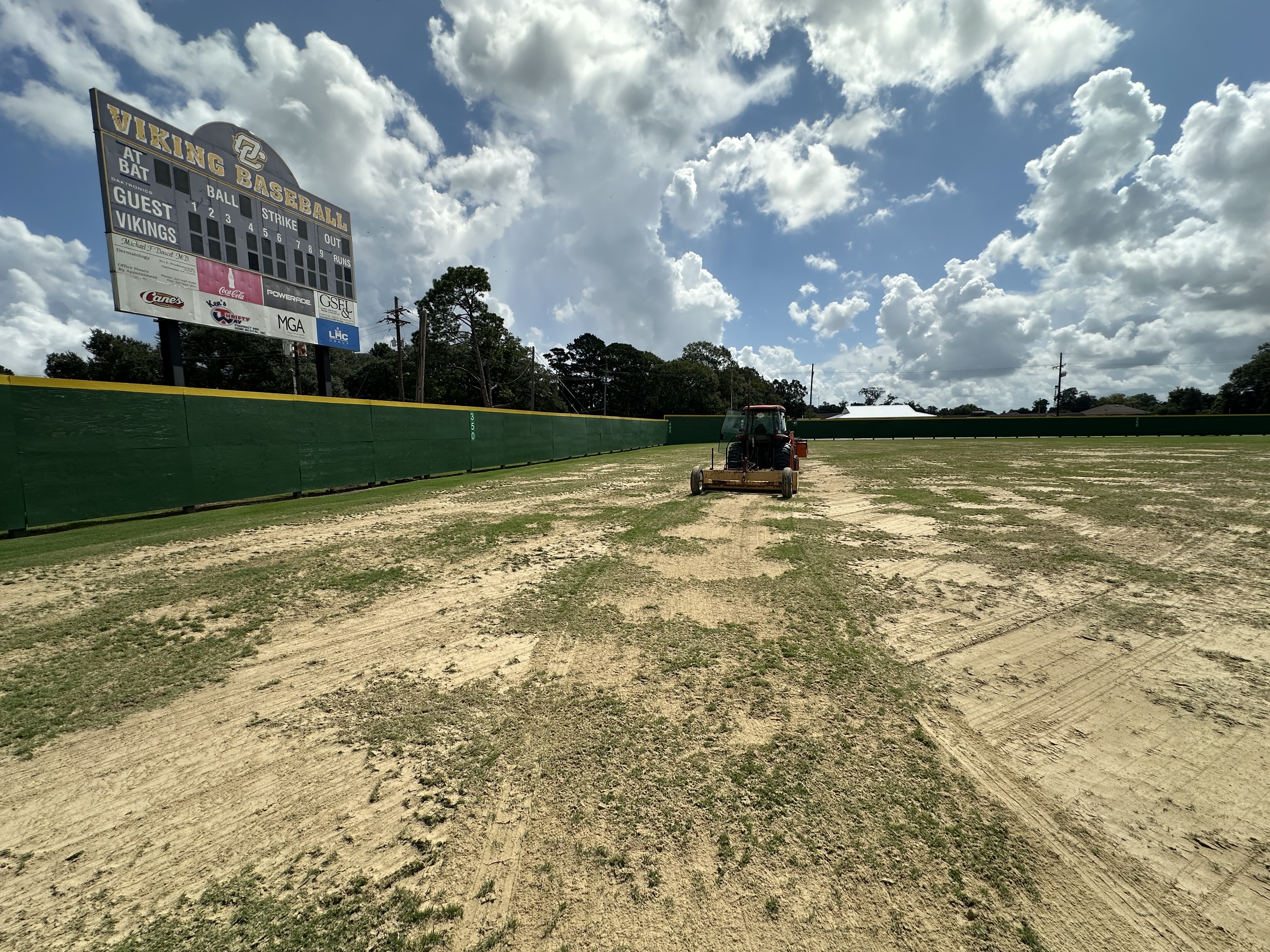

#356

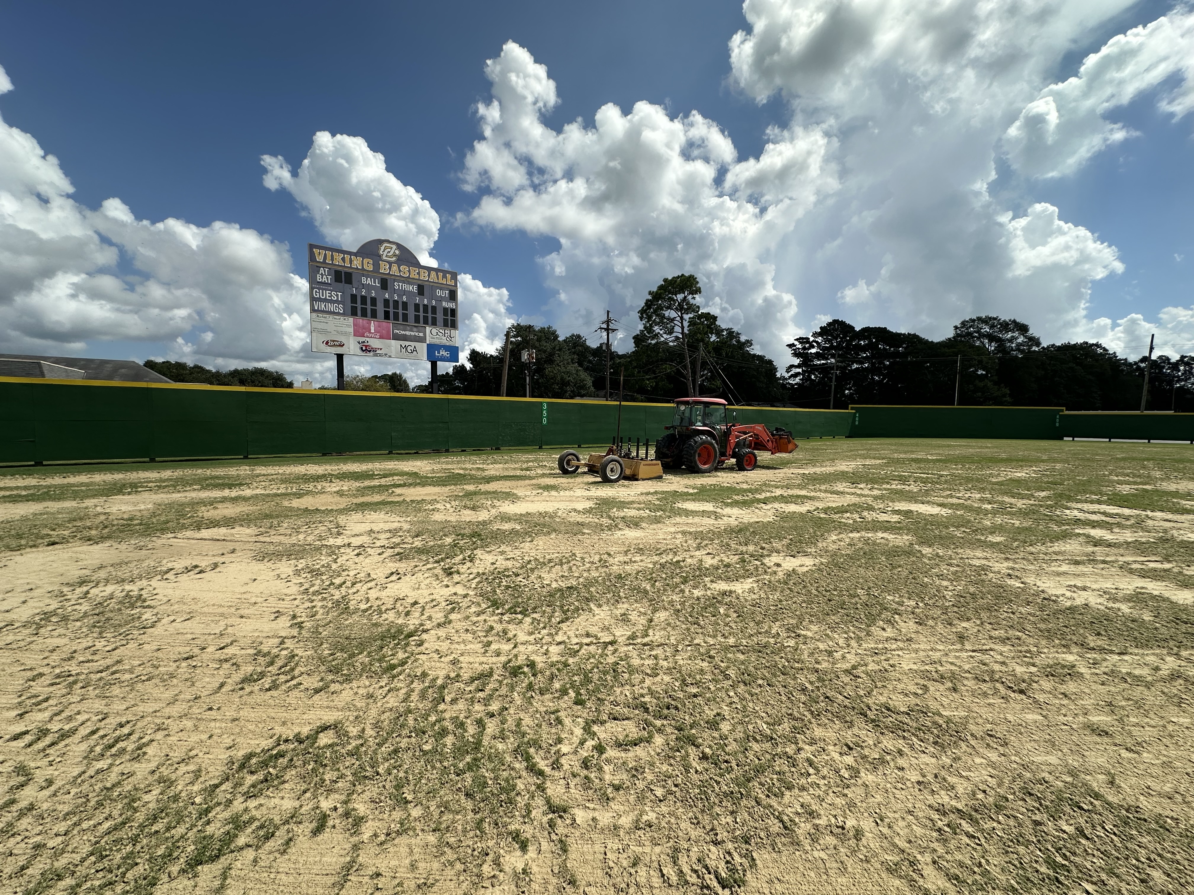

You can see this field had lots of ripples in the outfield. Spreading sand with the blade can sometimes be a lower cost way to fix these type issues. Otherwise we would have to remove the grass and re-grade then replant. This process cost about 10% compared to a complete renovation.
It doesn't work in all situations, but can sometimes be an effective way to create a safer playing surface.

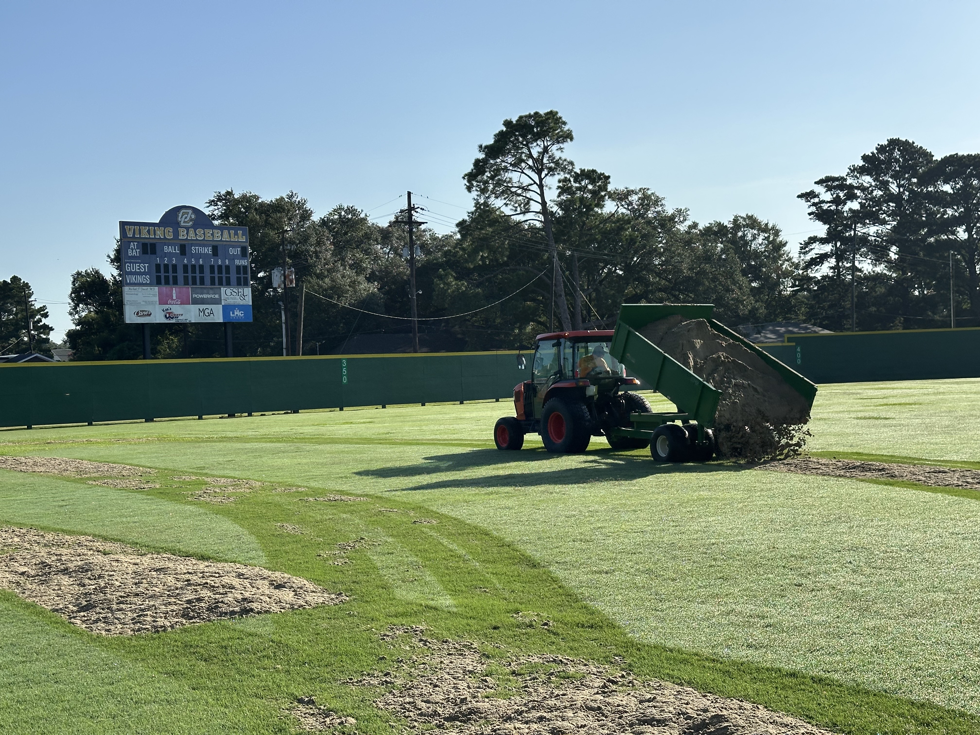

Long day yesterday. Drove 3.5 hours to remove lips on 2 fields that are about 15 miles apart. After that we stopped at another field to fix an irrigation. Got home around 8:00pm.
