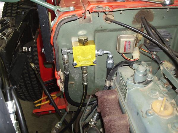

Diverter valve mounted and plumbed. All I like is plumbing return line. Just have to "T" into the one I have for loader.

Got it all plumbed, really works good. All that's left is putting some padding behind some of the lines to keep the wear down where they rub something.
At 1000 rpms the loader and power steering work good together, at the same time. Can't tell that the loader slows down when the steering is working or the steering works less when the loader is raising.

There should be minimal notice on the steering, if the loader is working, since the diverter valve will divert X GPM's to the PS, and anything left over will go to the loader, etc.
If you are not turning the wheel, whatever X GPM's the valve is diverting to the steering, is probably running directly into the sump.
It's my understanding, that when you put a diverter valve in, (for sake of argument, 2 gpm's), you'll never see that 2 gpm's again anywhere but the diverted (Power Steering) circuit. The FEL and 3pt effectively have 2 gpm's less than they did before.
