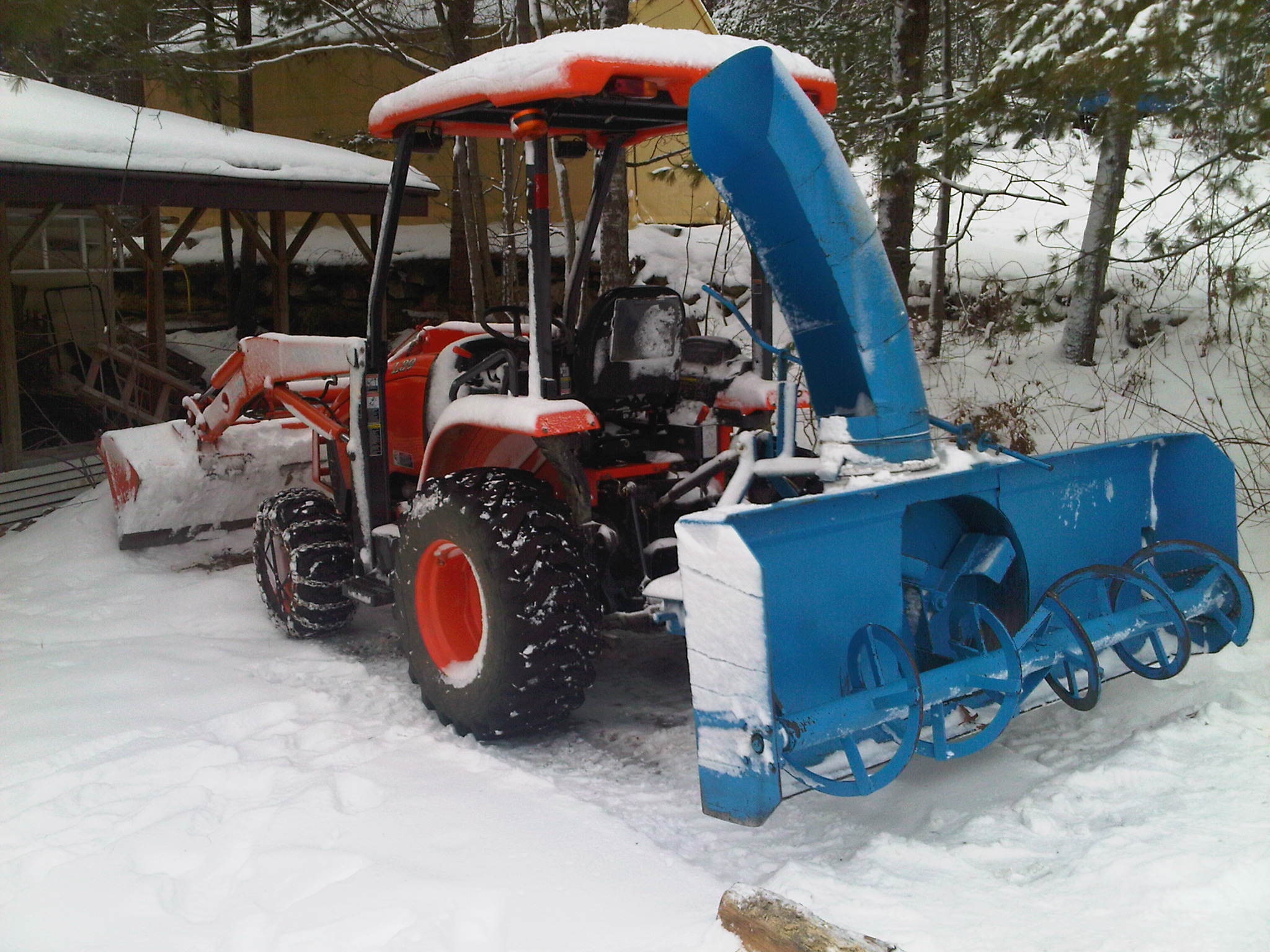

'clip'... Upgraded to the NH TC 33D and after measuring, figuring and more measuring, decided to try and make it fit (tired of looking backwards).
Apologies to the OP for slightly hijacking the thread.
Halftrack, I'm drooling. :) That's a nice set-up and exactly what I've been wanting to do with my LuckNow rear mount on my TC33D. Where did you source the gear box? If it's something easily obtainable, I'd love to pick your brain for some measurements and other thoughts. I can easily fab the frame work. Thanks for posting the pics.

5picker, thanx for the comments. That reversing gearbox and framework were with the original purchase at an auction. Pto shafts (as usual) and any small parts were missing. The Yanmar blower shows the model # YSS-60 and there are no numbers on the under framework or gearbox. You might check japanesetractorparts.com in IL, as they list reversing gearboxes. If you are starting from scratch, I would consider driving it from the front drive shaft with a chain drive reducer and a jack shaft. Check out Messick's NH parts for the 716B blower diagram. A 12 tooth sprocket driving a 42 tooth reduces the 2000 rpm to about 570. The jackshaft above the driveline is a better alignment to match up with the blower drive. Less steel to fabricate, shorter drive shaft, excellent mounting points and frees up the rear end for your blade. I have super steer which required mounting everything low (real low). If you have SS consider running the drive shaft offset to the left or right along side of the lower pivot point. Hope this helps. As usual we expect to see the results. Happy cobbling.
