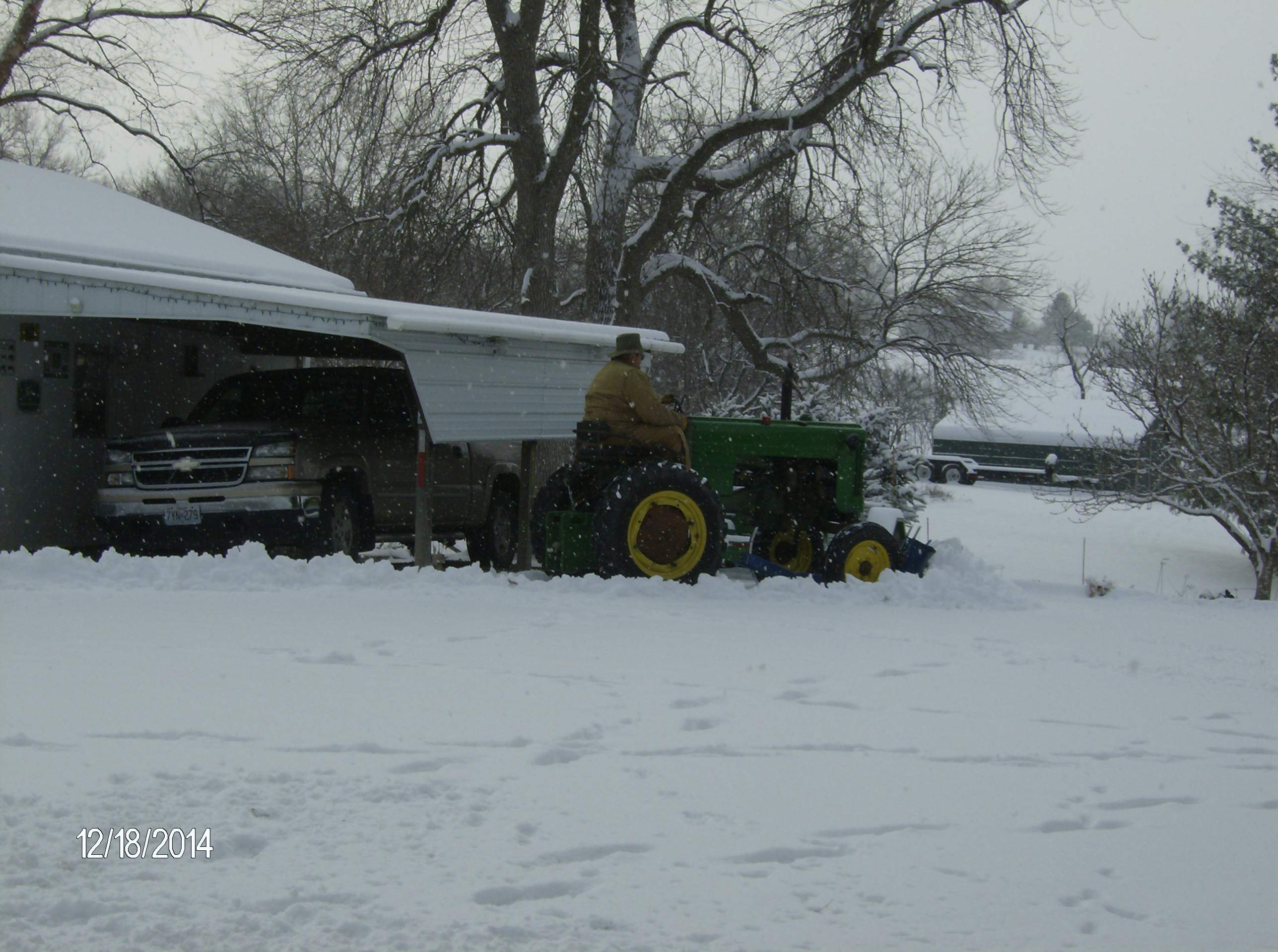

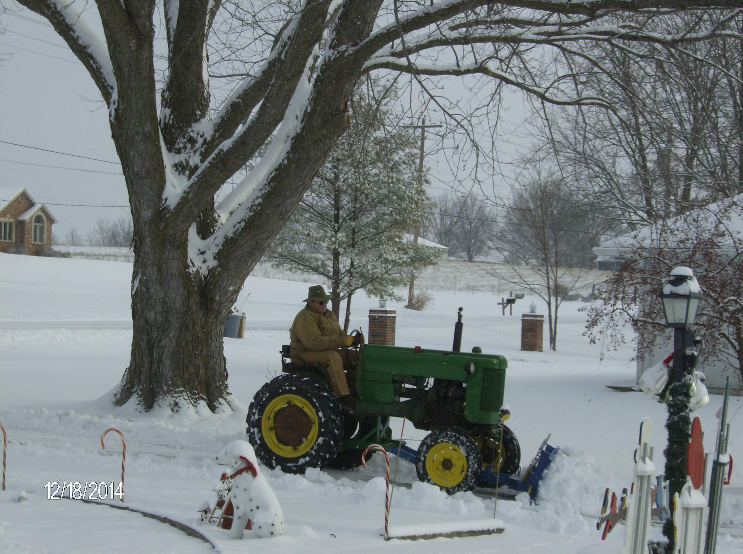

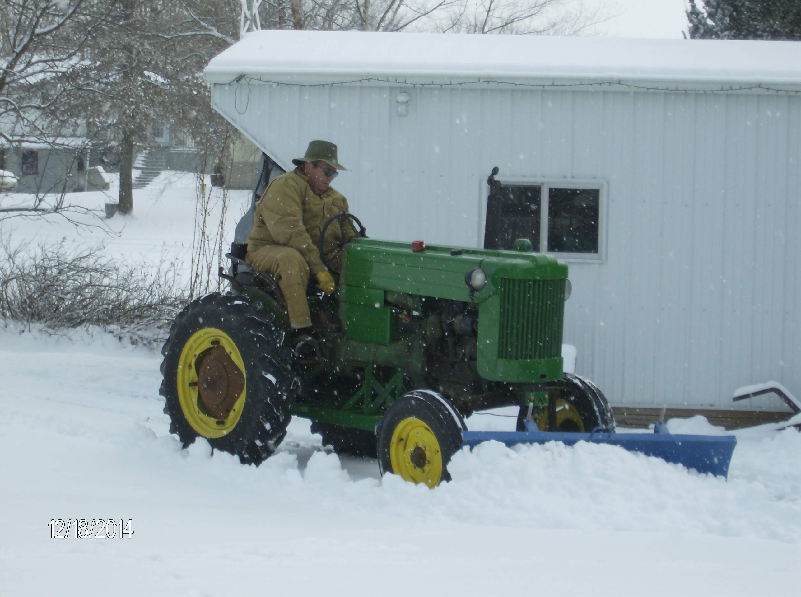

3" of wet snow this morning, time for the NTM 1953-40S to earn it's keep around here: HPIM1432.jpg HPIM1431.jpg HPIM1435.jpg
