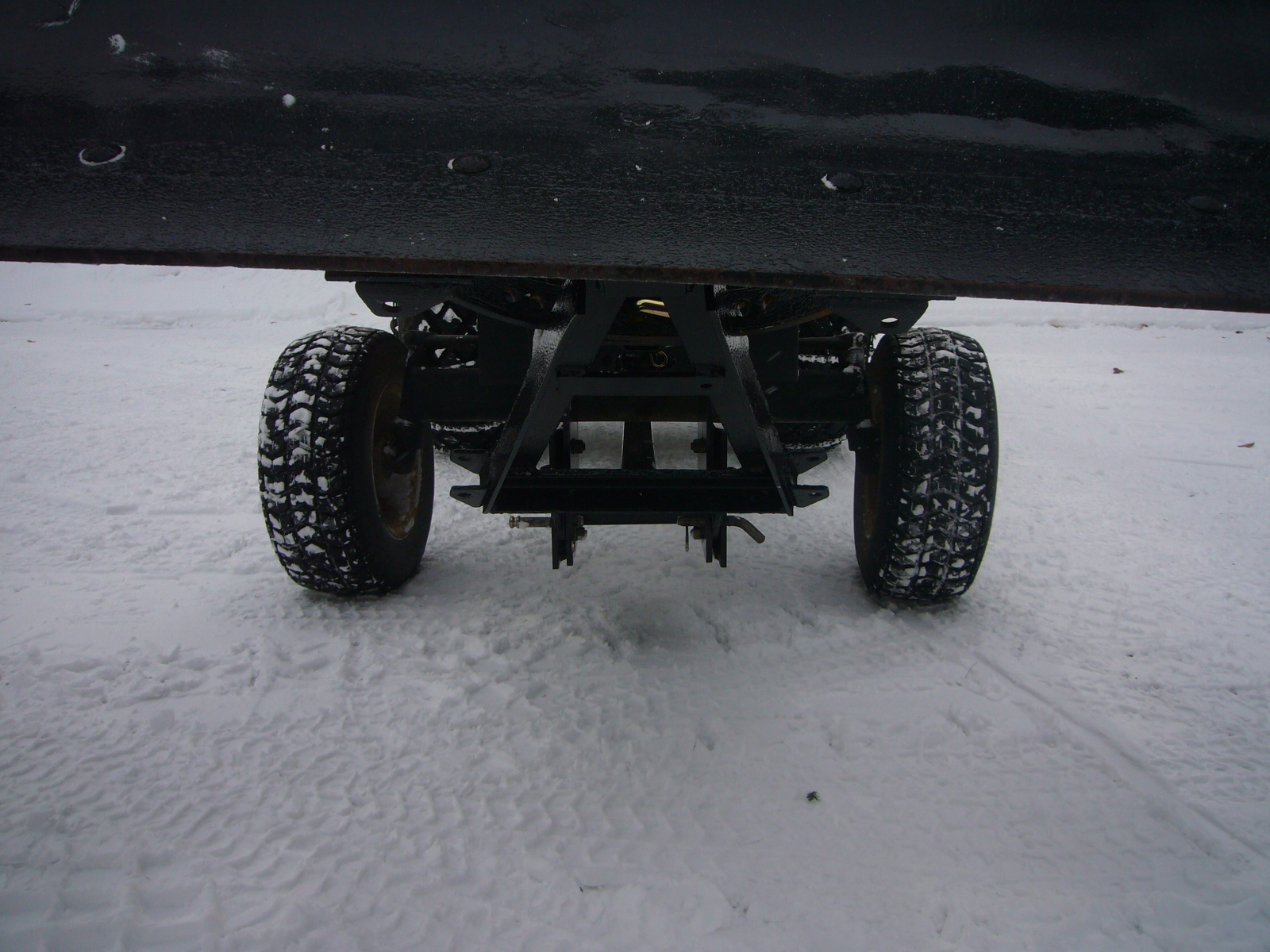

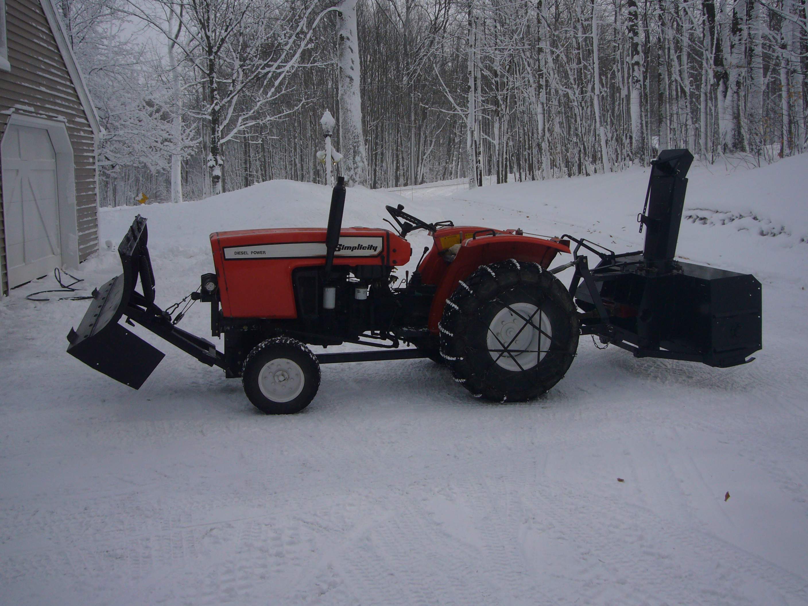

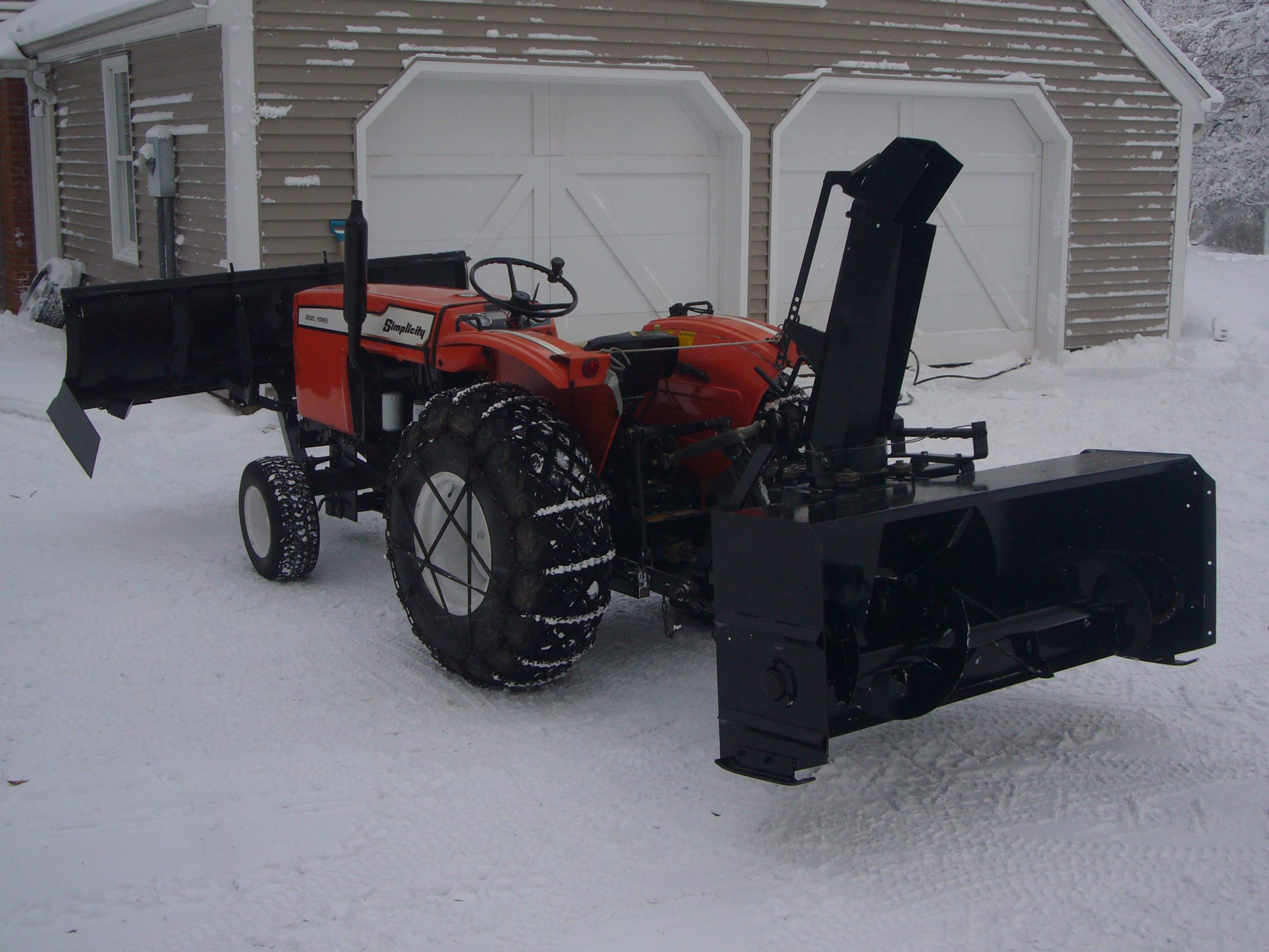

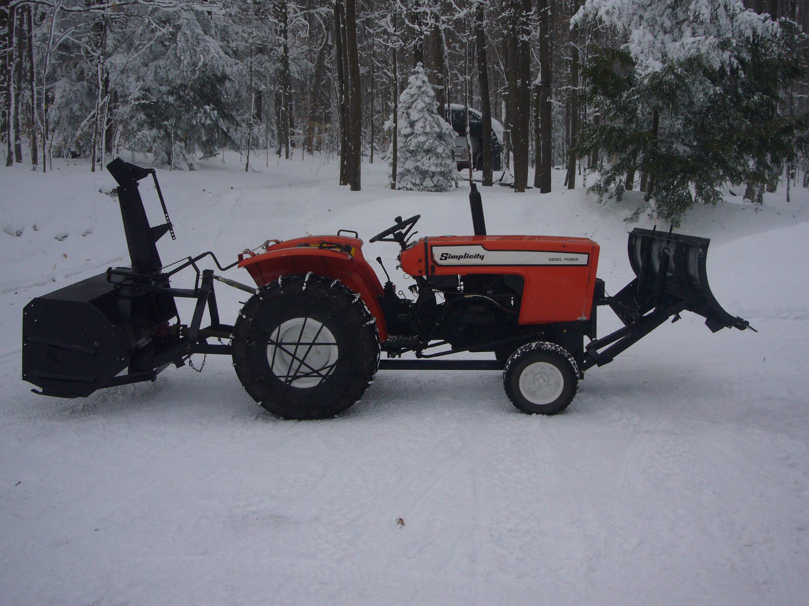

This is the larger half of my setup. Recently got a 90's Arien's ST1032 walk behind to augment. Should make doing the sidewalks and rear deck easier. Speaking of which I need to build a ramp to get the blower up on the deck LOL. This is a 1979 Simplicity 9523 / Allis Chalmers 5020 Hinemoto manufactured tractor. 23 PTO HP 540 PTO speed 2wd Manual tranny. I fabricated the mount for the Meyers plow. You can see my stabilizer bar which runs underneath. It goes from the front plow mount back to the rear trailer hitch assembly to stiffen everything up. May be overkill but better safe than sorry! This way when I plow snow the plow mount is reinforced right back to the rear of the tractor. fwiw The snowblower is an Inland brand which I had to modify quite a lot to get it work effectively. Didn't throw far enough. It's still challenged but much improved. We have certainly had our share of snow here this year. 8ft + within the last couple of weeks. Unfortunately, the implements got buried in the collapsed shelter so I had to dig out of all that with the Arien's. Now that is apart for modifications and bearing/belt replacements. We did have 10" of powder snow last night and this setup worked a treat today. Enjoy. P1030465.jpgP1030463.jpgP1030462.jpgP1030469.JPGP1030467.JPG

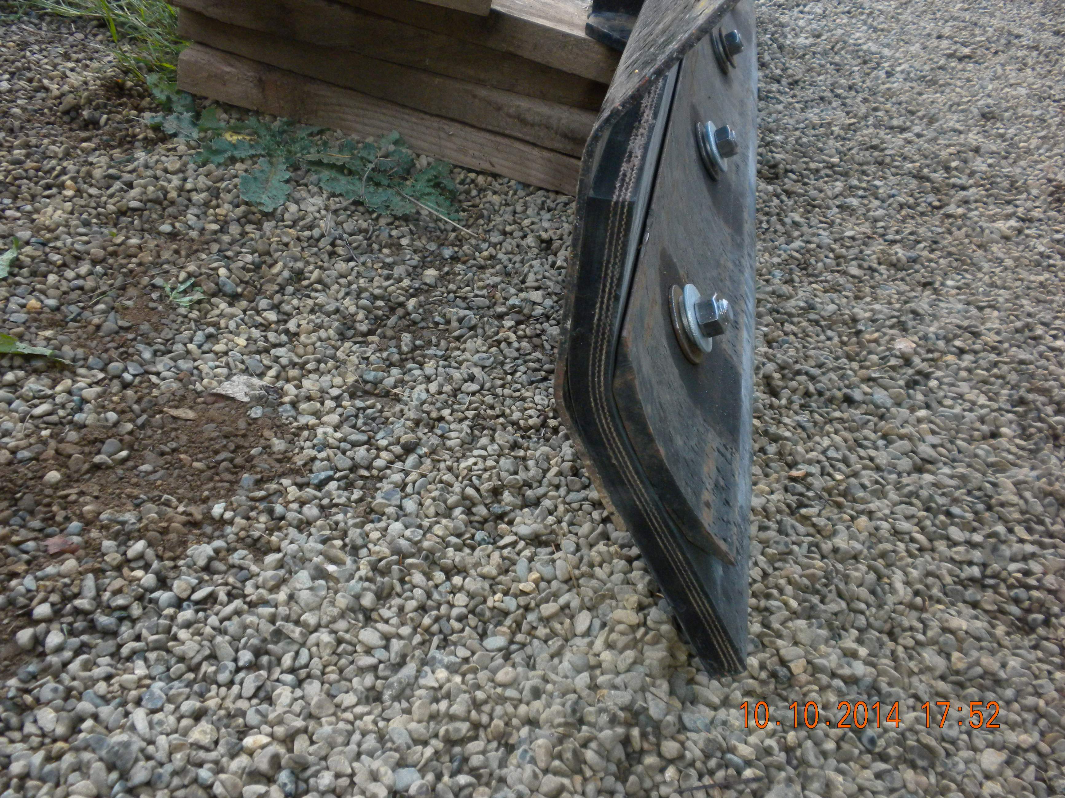

Picked up a piece of conveyor belt 4 feet wide and 5 feet long and 3/4" thick. Cut one foot off and bolted to back blade to make a snow plow. Should be good for a few snow storms. DSCN8306.jpg

Great idea! Were you running into issues tearing up the ground with the regular back blade?
My driveway is in really bad shape (paved but all cracking and coming apart, needs to be redone) and when I lower my heavy rear blade on it I tend to rip up a lot of "chunks" in the driveway. Something like this would probably help.
Where is "here" at? Help if you'd put your location in your bio. Then we'd know about where 8' of snow fell.
And what are the side wings on the front plow? Look like something to keep snow from filling in behind the blade. ?? Or do they fold out?
