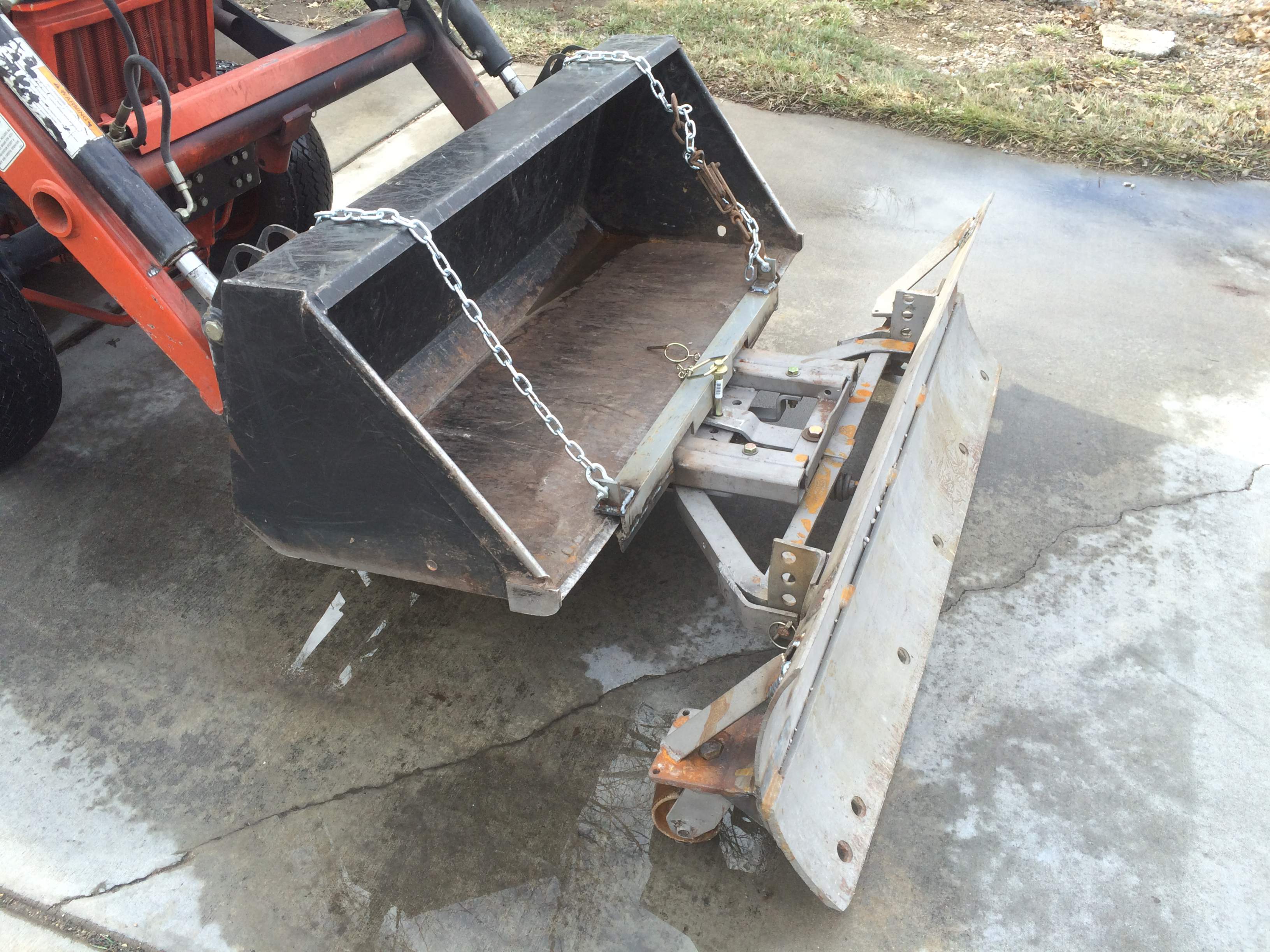

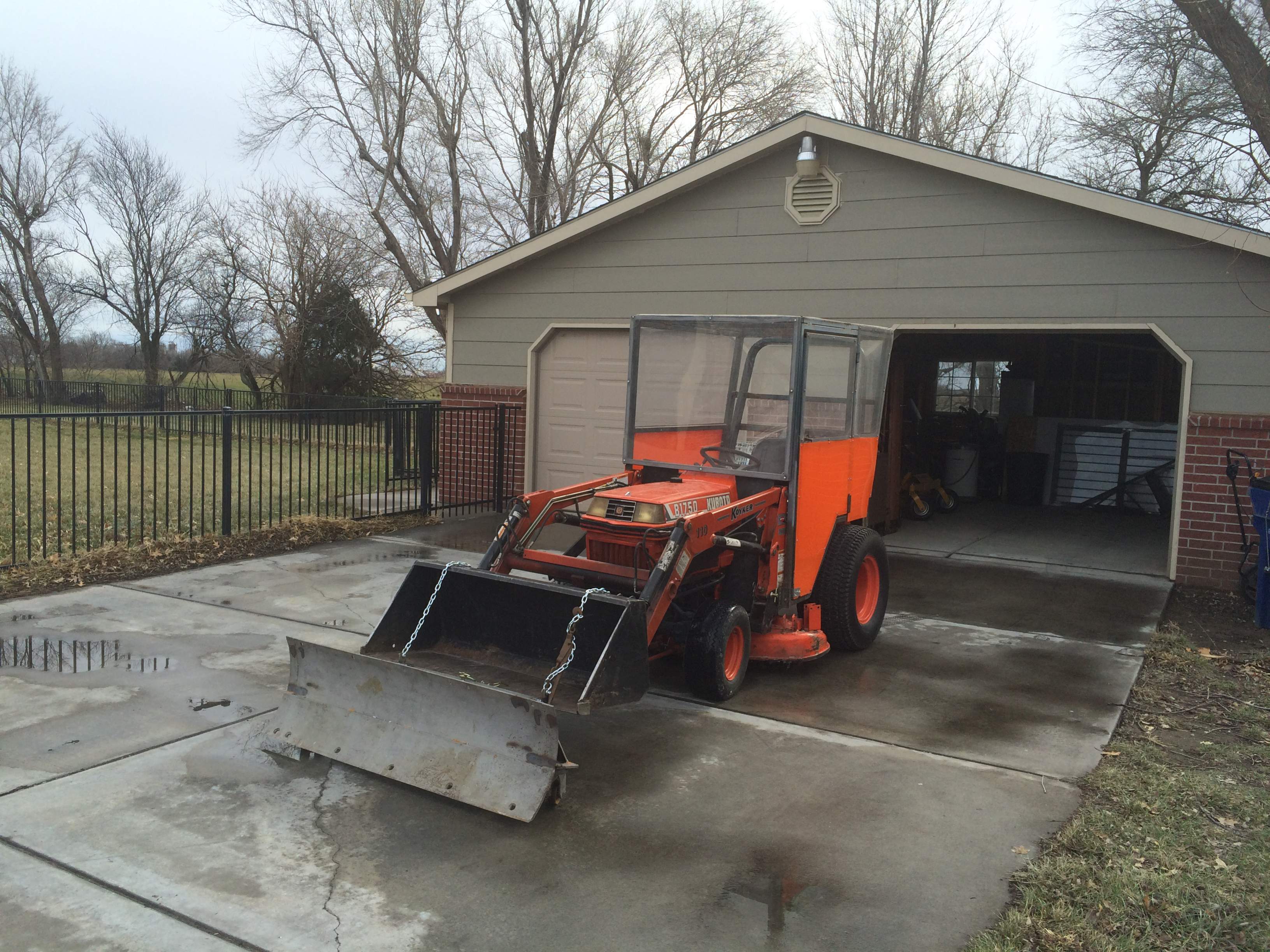

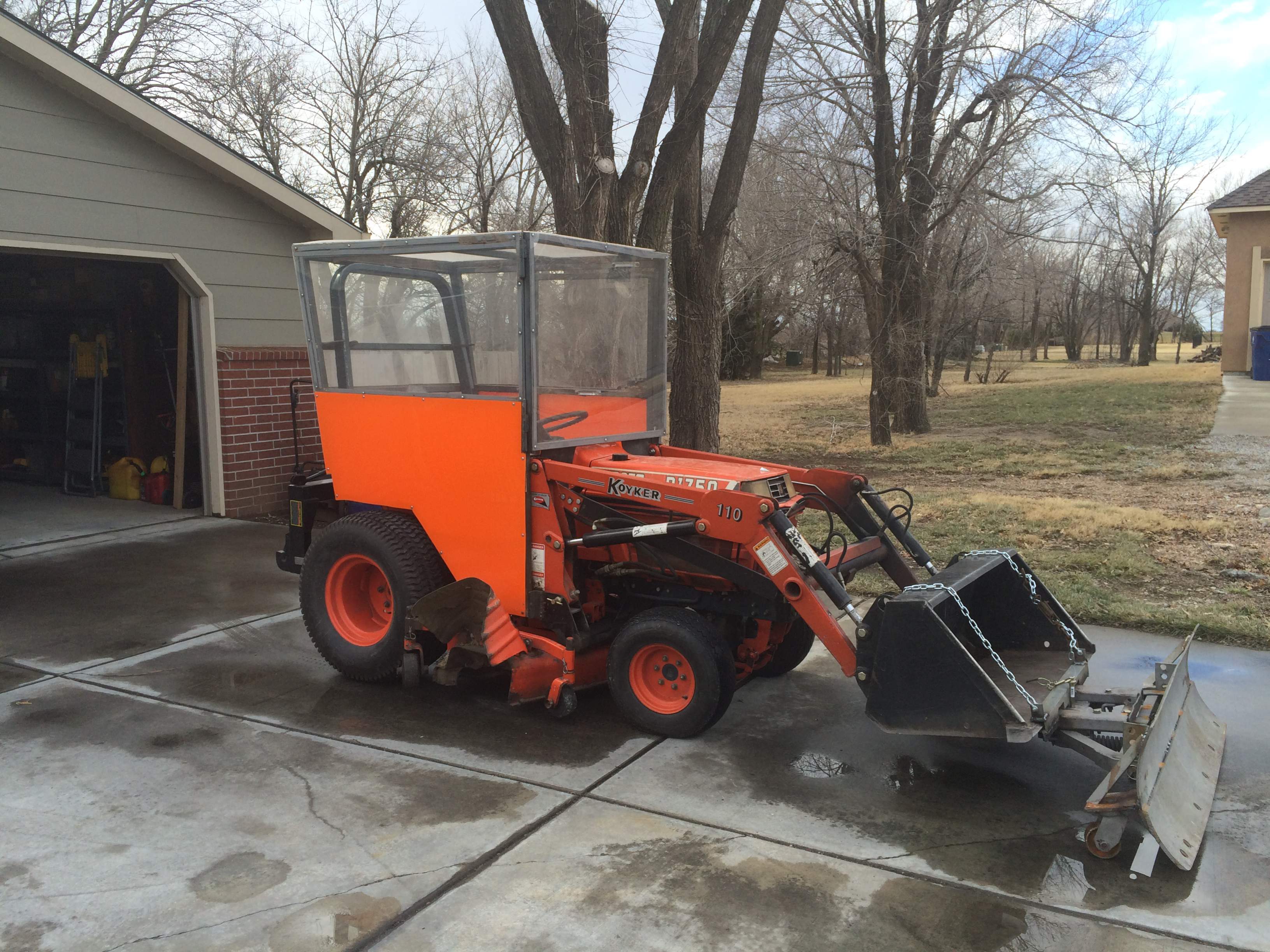

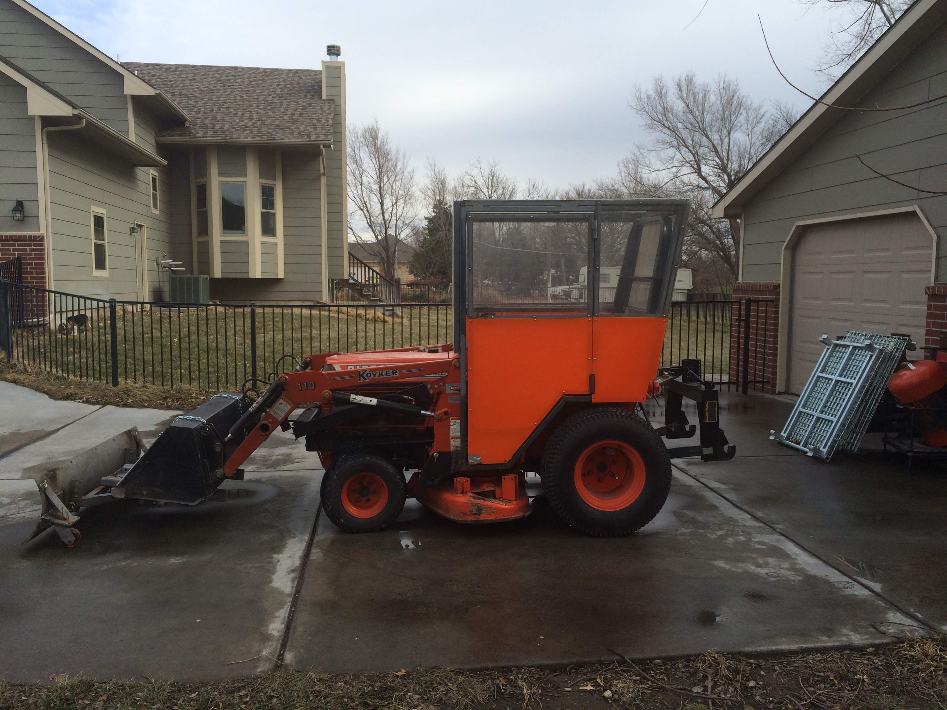

I finally got mine all together. Kubota B1750 with cab and 5-1/2' FEL mounted snow blade. I've been using the FEL and a rear blade for the last four years to push whatever snowfall we get (usually 3-4 small snows and maybe one in the 8"-10" range). I clean about 200 ft. of gravel drive and our concrete driveway from house to detached garage. I used to clean the neighbor's (we share the gravel driveway) concrete slab also until he stopped me the second time and said "He'd do it". Guess he didn't want me scraping up his brand new slab! I enjoy watching him with his shovel and seeing how long it takes for his side to melt.
I found the cab on an online auction. It was on a B6000 Kubota at a local driving range. The winning bidder abandoned the POS tractor after he saw it in person and I bought the cab off of it for $50.00. Every inch of that frame was covered with expanded metal to protect the operator from flying golf balls. There were hundreds of tack welds to cut off and grind down before I could skin it with about $300.00 of Plexiglas. No heat in the cab, just use it for protection from the Kansas wind. Insulated coveralls, heavy gloves and jacket have proved sufficient. I chose the orange for its visibility.
The snow blade came from one of the aircraft plants here in Wichita. It was used on one of their forklifts by their Facilities Dept. to push snow at the plant. Paid $65.00 for the blade from their salvage group and have another $50.00 -$60.00 invested in steel, chain & boomer. Had to move the mounts for the casters down in order to give clearance to push the gravel drive. It will pivot manually to windrow, but have not had enough snow this year to give it a good try. If the snow blade works well, I'll probably leave the rear blade where it sits.
