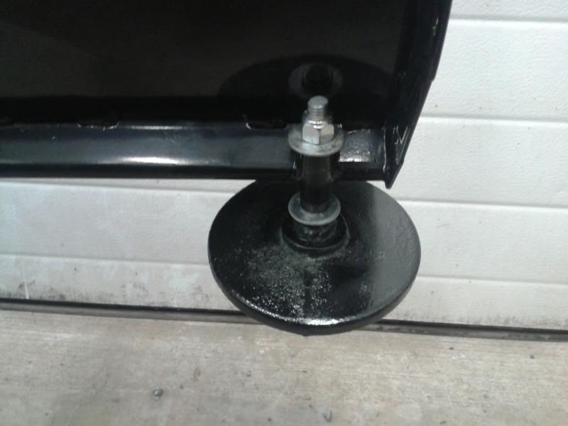

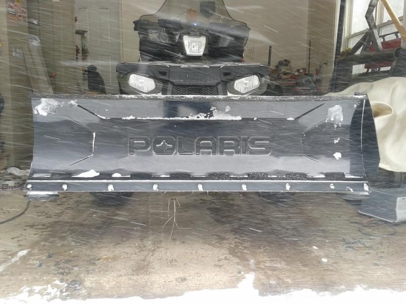

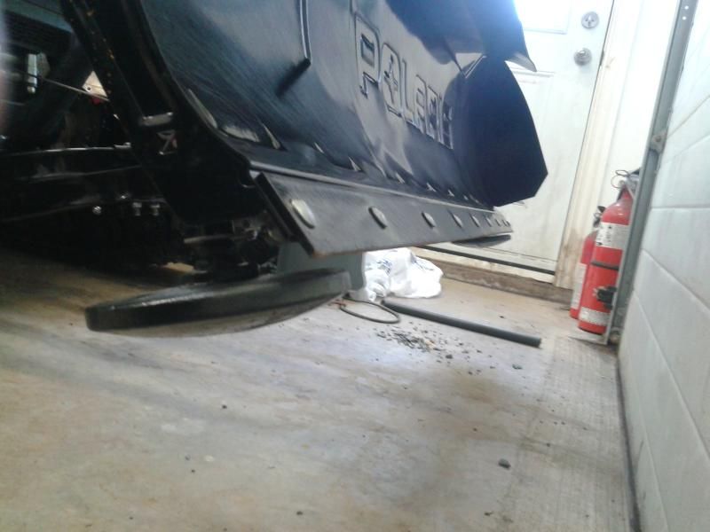

Well we didn't get half as much as they were saying... but still a good 6" or so.
Pretty happy with how the new shoes turned out
1 5/8" gap. Seems like a fair bit, but the way I welded a nut on the shoe first, then welded the threaded rod to it... I can't put them up any more. I could always made a longer wear bar.
Didn't scrape any gravel, and kept enough snow to make a base. I guess that's what matters.
