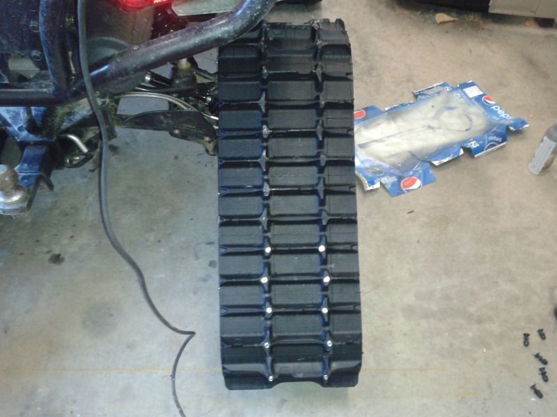

Picking up some self drilling screws after work for the atv tracks... about 80 each... we're expecting a foot of snow, and everyone's driveway are a solid sheet of ice.
If you do a "ice studs" search on eBay or google you can find screws made for the job. Some even have tungsten inserts. For now I would do the same as you. It's pretty hard to put chains on tracks. :)

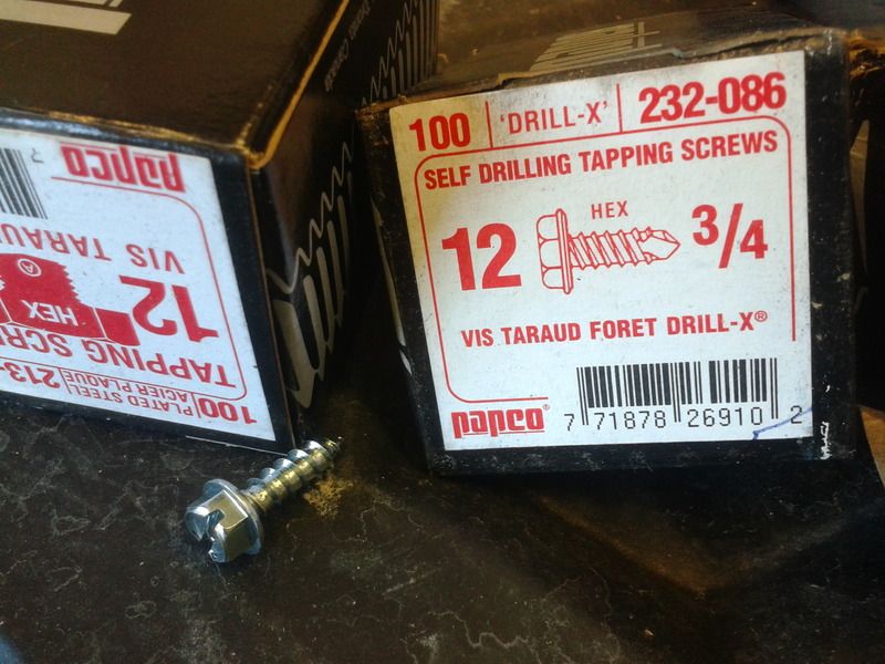

Bought 400 screws.... only realized one box was different. I'll only be about 20 short... the box in the pic is the wrong box, although they are 3/4"X 12
Started
Glad to see they are a little staggered
One thing I'm doing is going behind the drill and using a wrench to make the screwdriver slot sideways. That way I'll get a little extra forward bite, and I'll be able to see at a glance if they're backing off.

All done! I had 5 left from the 300! :) I also have two tickets for tonight's $40,000,000 draw... hopefully my luck continues ;)
Took the flash off the camera to try and get better pics
Pictures don't do it justice, she looks mean as heck!

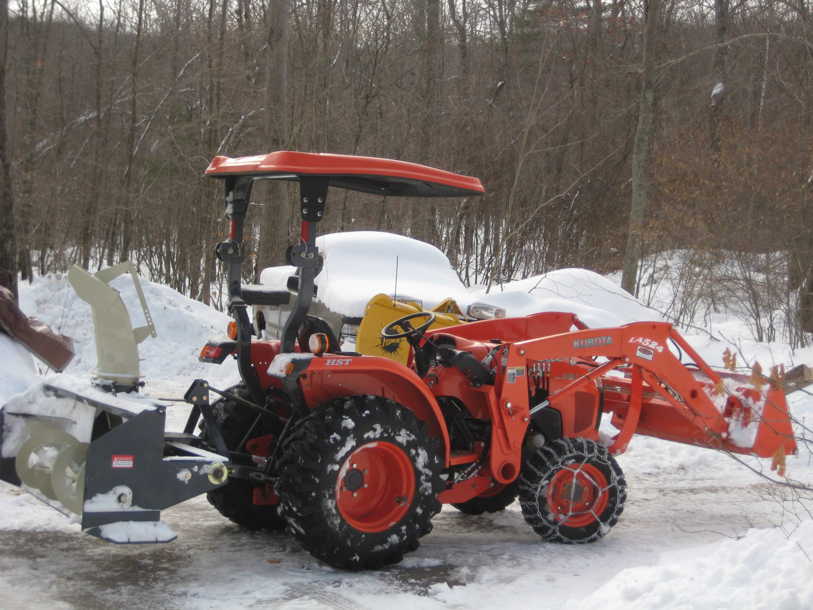

IMG_1123.jpgNothing exotic here but the PTO blower was the best money spent. I did not want a front mount, the FEL is a must have.
   / Pictures of your snow weapons #2,699
Nice rig Brimfield. I bet you were glad to have the blower on this winter! We got off easy compared to you guys in NB!
Well just as a little test I took the trash out to the end of the driveway. Tried to slide on sheer ice on a downhill by braking hard... nearly got thrown into the windshield! Crazy how much these grab! More traction with them on ice then tires on gravel. I'm grinning ear to ear. :)
The tracks are no longer "4 season" but I didn't intend for them to be anyway. Oh, and just in case you were wondering, the screw heads are 5/16ths.
