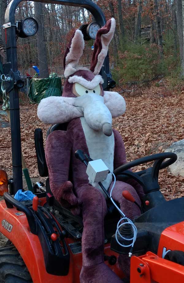

Finished up and tested the actuators on my blower chute.
   / Pictures of your snow weapons #3,113
Nice, I like the joystick instead of a couple of dpdt toggles. Can't see in the video, does the joystick handle the current of the motors wired direct, or is there a bank of relays to switch the motors?
   / Pictures of your snow weapons #3,114

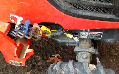

Joy stick is single pole each direction so I mounted box with relays right on blower.
Put connectors on the joystick and power from tractor.

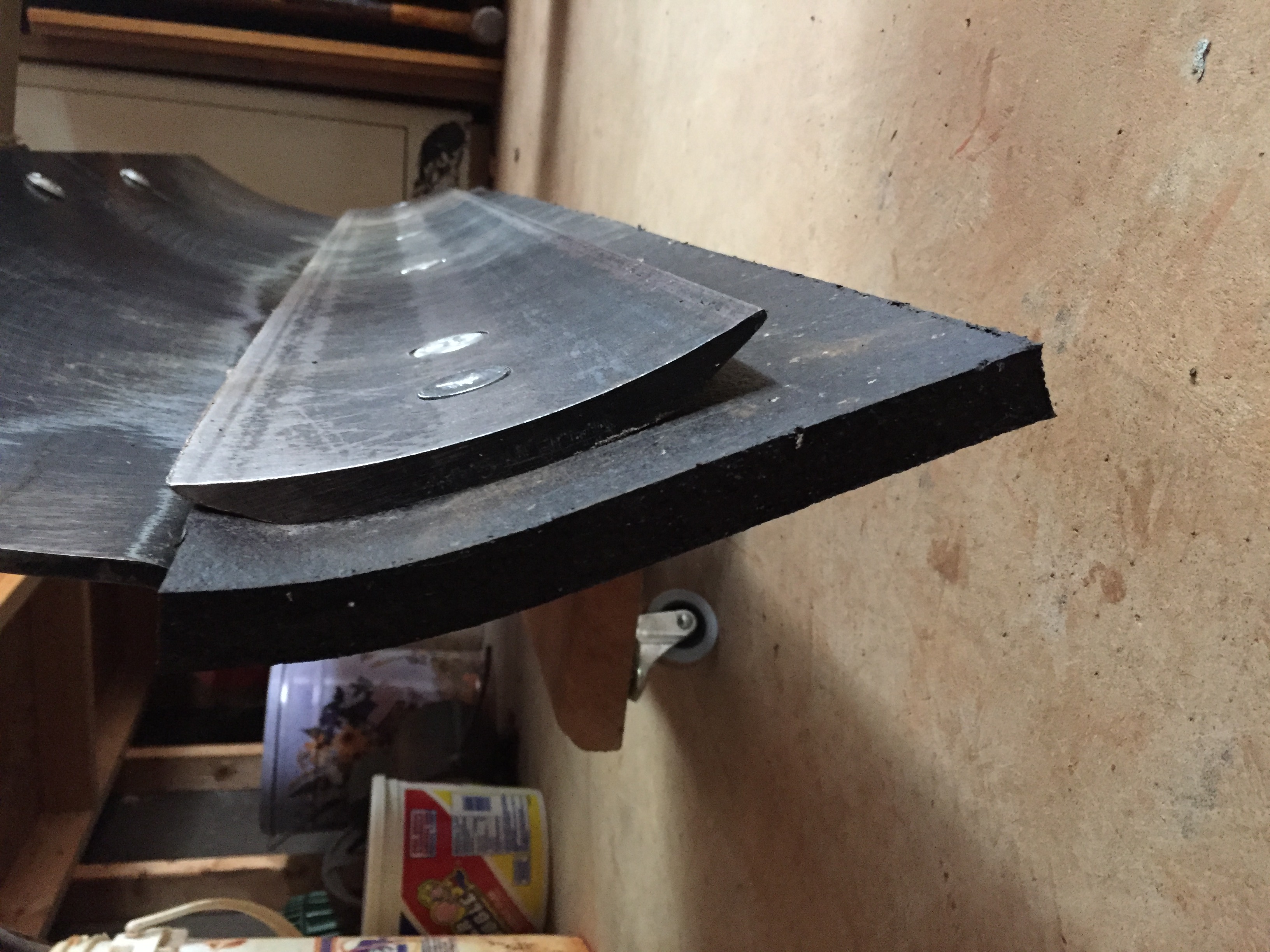

I just added a piece of stall mat to rear blade for snow work; time will tell if this helps preserve my 1/3 mile gravel road.

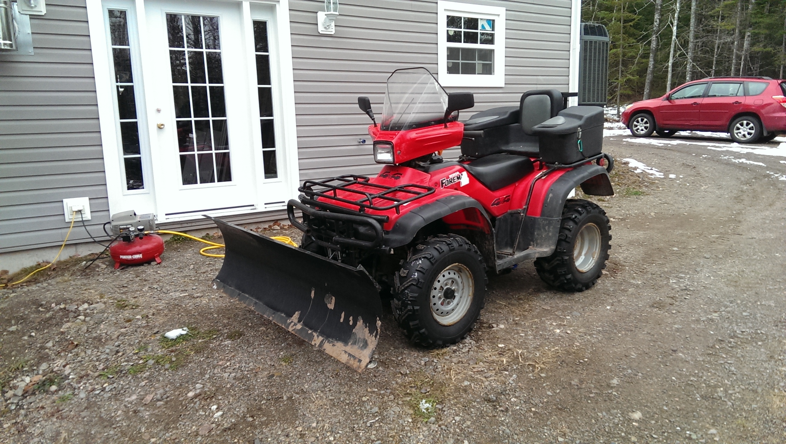

Snow weapon #1 all pumped up , gassed up and charged up . Until the ground freezes this will take care of the white stuff . After the freeze I can try the new blower !
I did something similar, but I removed the steel blade entirely and just run with the stall mat. It is like a giant squeegie, but when operating, the leading edge trips under the metal blade support and glides over the surface (to the thickness of the mat) and doesn't disturb the gravel.
In the spring, I use this same setup in conjunction with my EA LandShark grading scraper to re-distribute and repair any issues.
