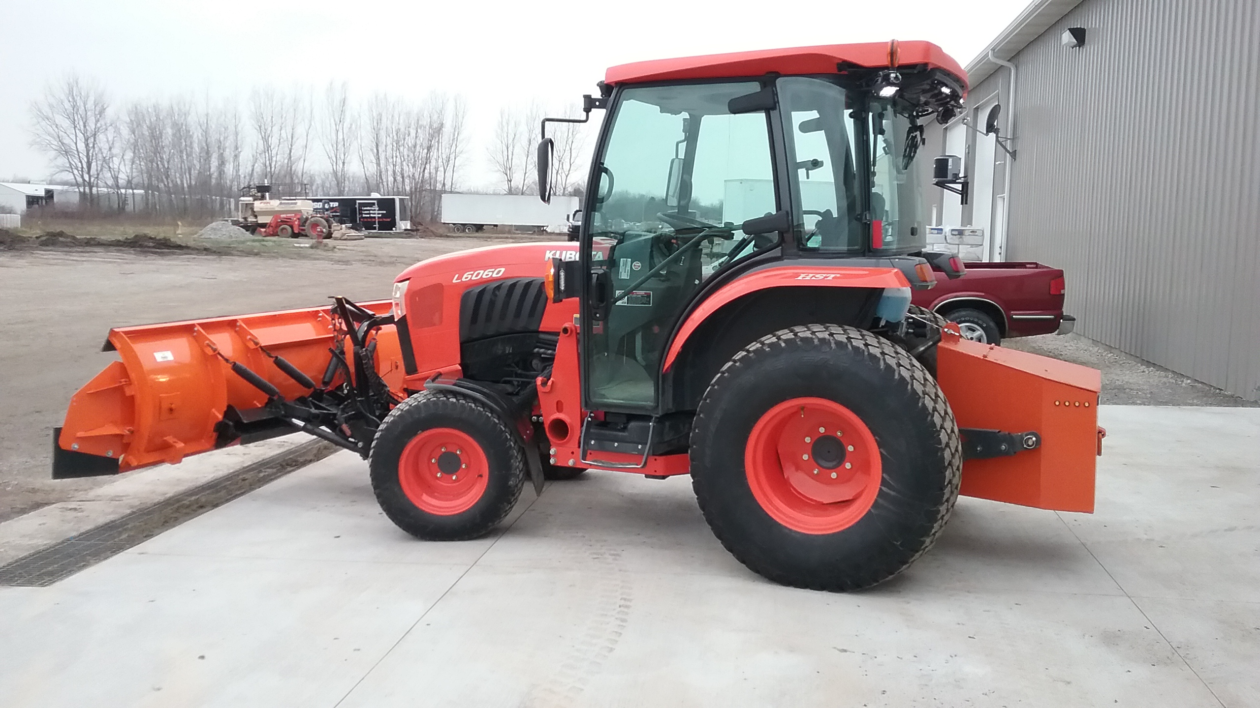

I Got to plow with it for the first time last weekend. Worked awesome until the plow solenoid that i had previously told myself needed replacing quit about an hour in. I guess its good to have happen on an inch of slush than on a real snow. I also stumbled on an older set of loaded rear turf tires for 350$ on craigslist so im hoping the combination of the loaded tires and the weight box will make it pretty unstoppable. I'm tossing around the idea of siping the heck out of the craigslist tires since they'll only get used in winter.

I like your plow setup. Did you convert a truck plow or did you buy it. That is also a nice ballast box. You have a very nice snow moving setup.
   / Pictures of your snow weapons #3,133
Thanks! the plow was taken off of an f250 and rebuilt since it was in rough shape. To mount it to the tractor i just cut the truck mount up a little and welded it to a piece of 1/2" plate that bolts to the front and made some strut bars that go under the axle and bolt to the FEL mount. we use westerns on the trucks but the mounts are too wide to fit between the tractor tires so i used this curtis instead. Im not sure yet if i'll keep it electric or switch it to work off the FEL hydraulics. This setup is kind of an experiment so i wanted to keep the plow original in case we decide to sell it and go a different direction like a fel mounted blade. I built the ballast box instead of buying one because i wanted to tuck it as close to the tractor as possible and i wanted to build in a storage area.
