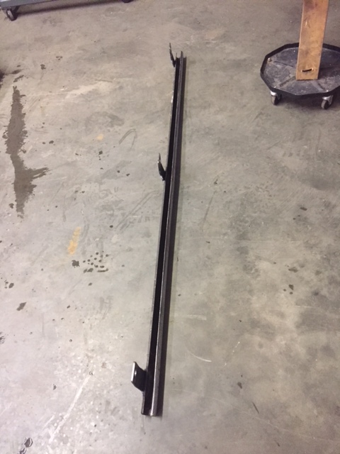

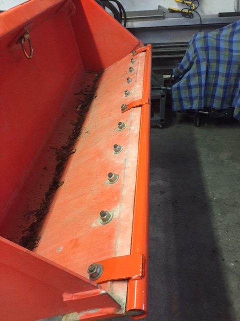

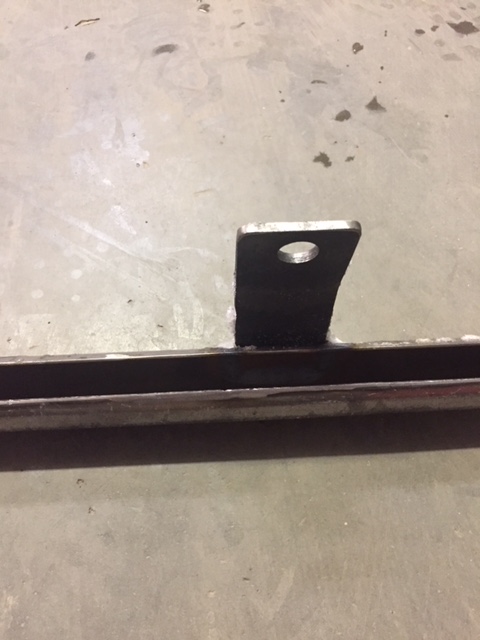

I was having trouble with my fel digging into my gravel driveway also. This is my first winter with my tractor and thought it was going to be the ultimate snow removal tool with the fel with float and a tph 50" blower. I was quite disappointed to find it digging up my gravel driveway. The more I plowed the more of a mess I made, even the snow blower with the skid shoes was digging in and shooting gravel all over the place. To save my driveway and my frustration, I went back to using my quad. Then i read on here where someone put a piece of pipe on the cutting edge of the bucket. I made one out of a piece of 1.5" tube with a thin strip cut out of it lengthwise and some tabs to bolt it to my cutting edge. I can't believe how such a simple thing can make such a huge difference. I can even clear off my lawn without damaging the grass. I will be making one for the cutting edge on my snow blower also. I believe it would work much better on your bucket than any skid shoes.

I have one on order for my back blade. I have a local shop building it for me. Glad to hear that it works so well.

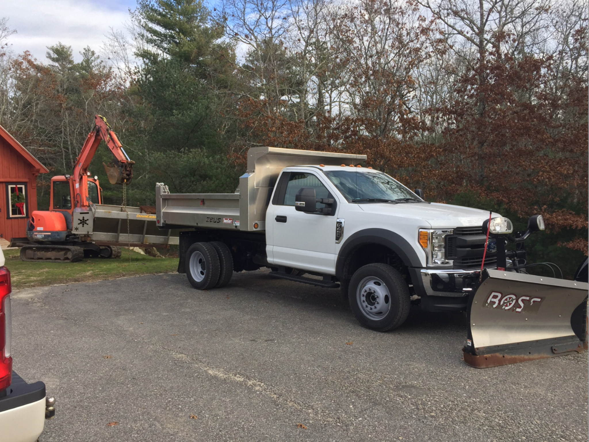

Traded my 16 F450 for a 17 F450. The difference in cab driving and seating comfort is night and day. The new one is comfortable for hours at a time. The 16, I wanted to get out of it after 15 minutes.
