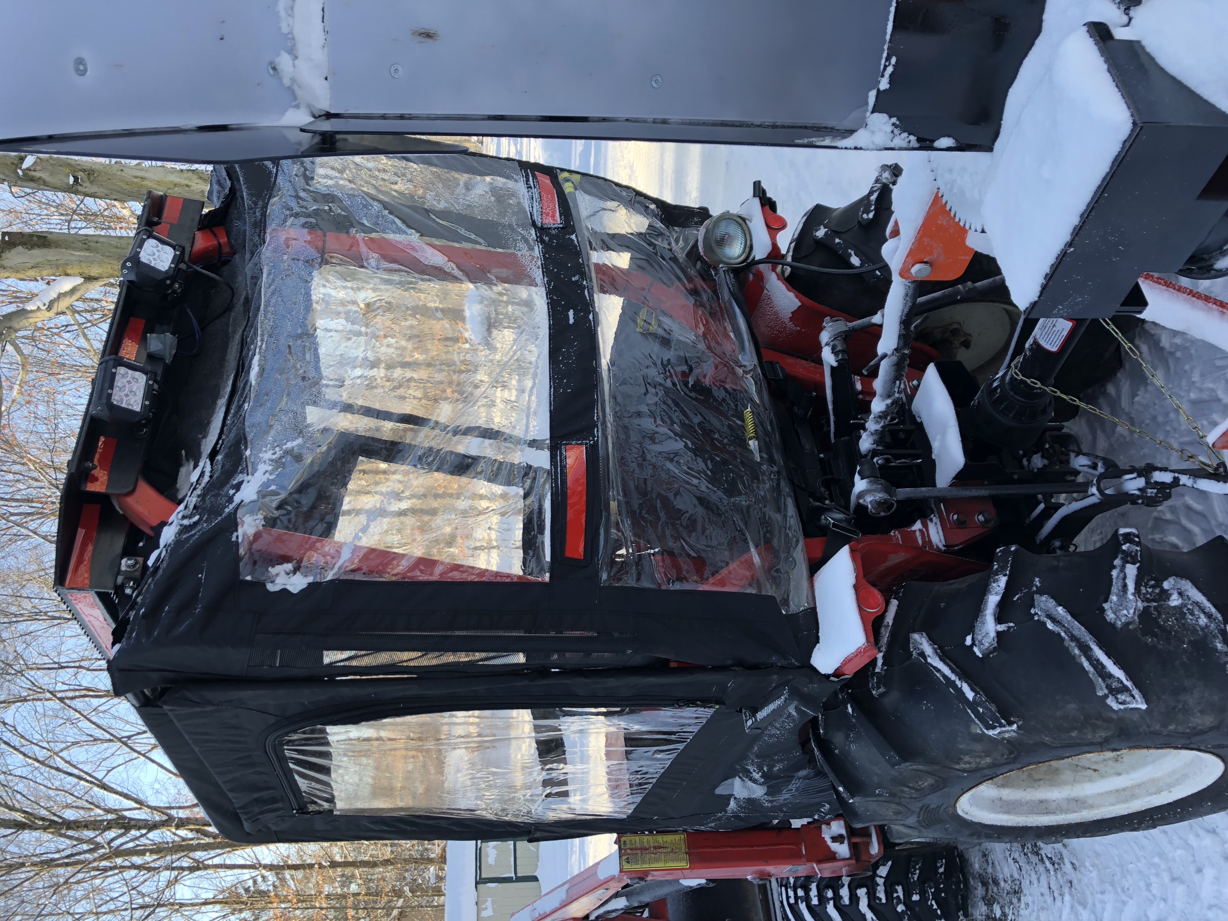

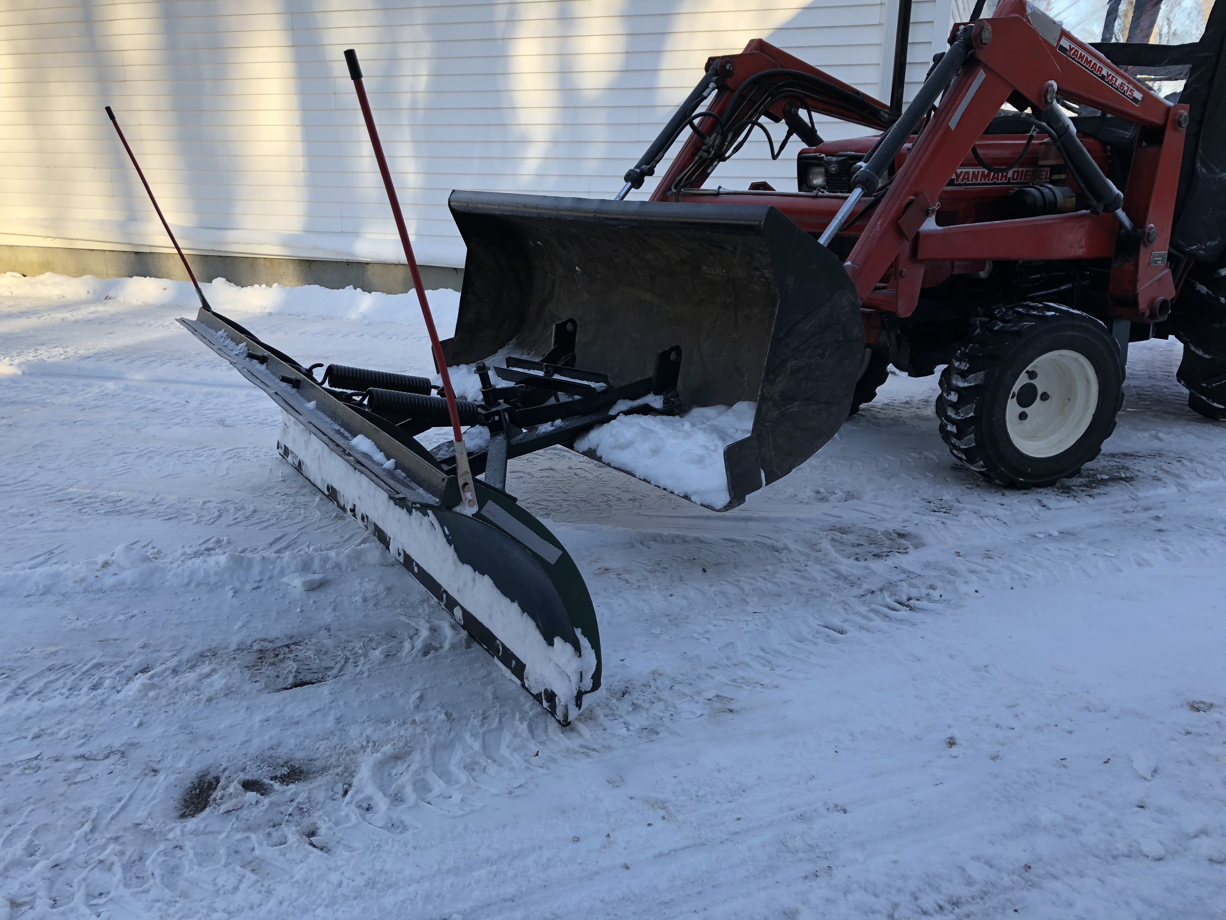

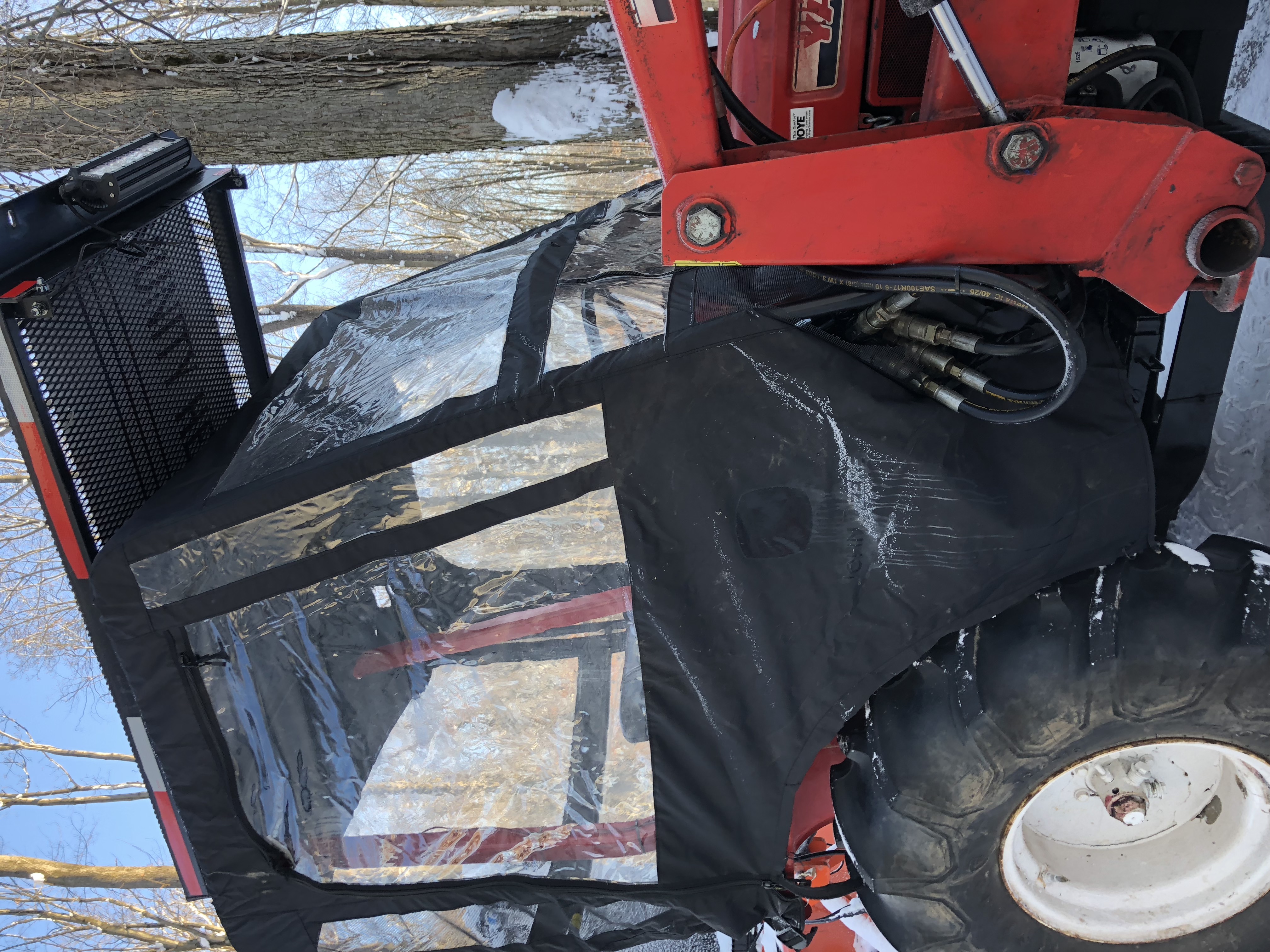

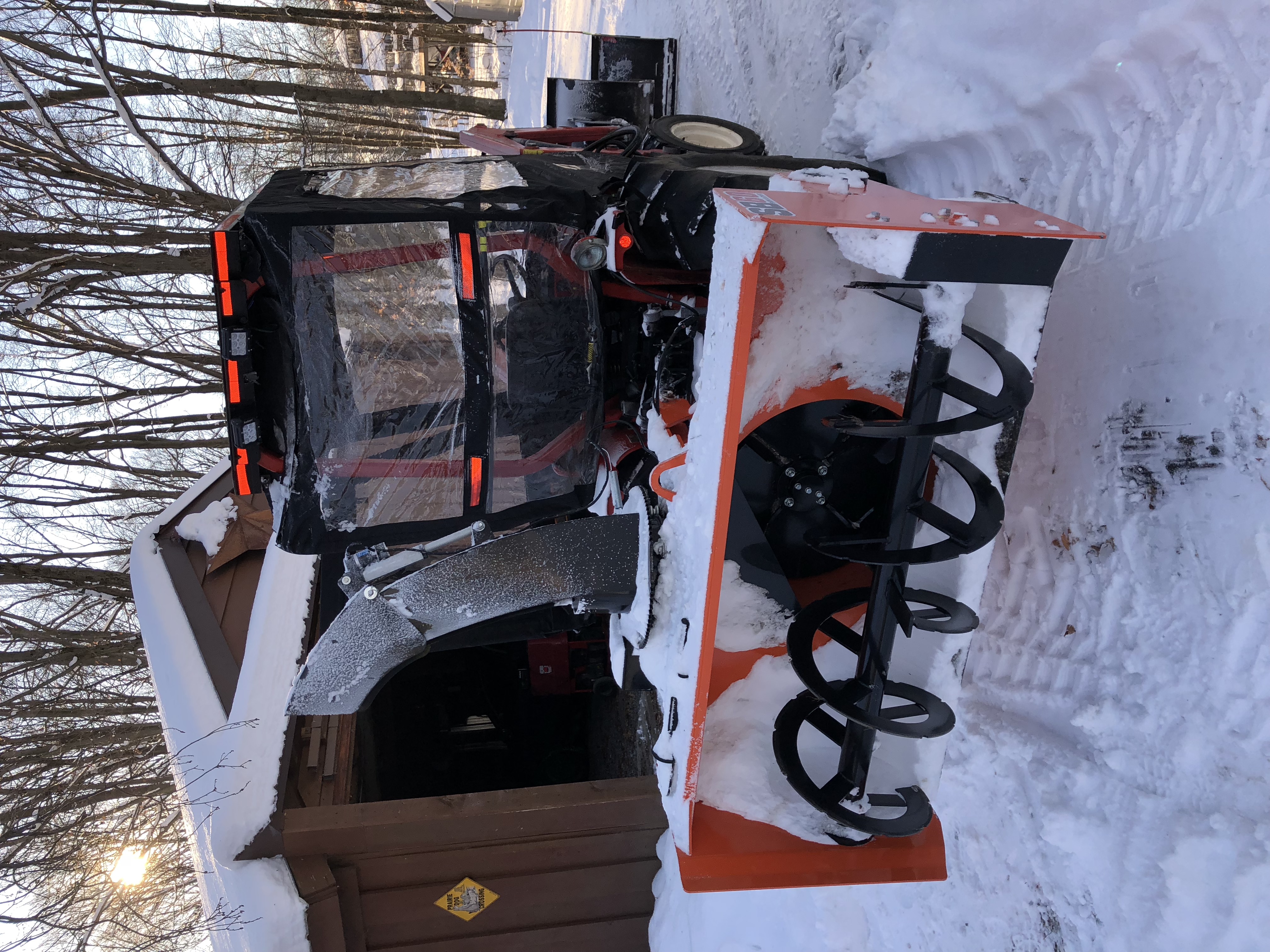

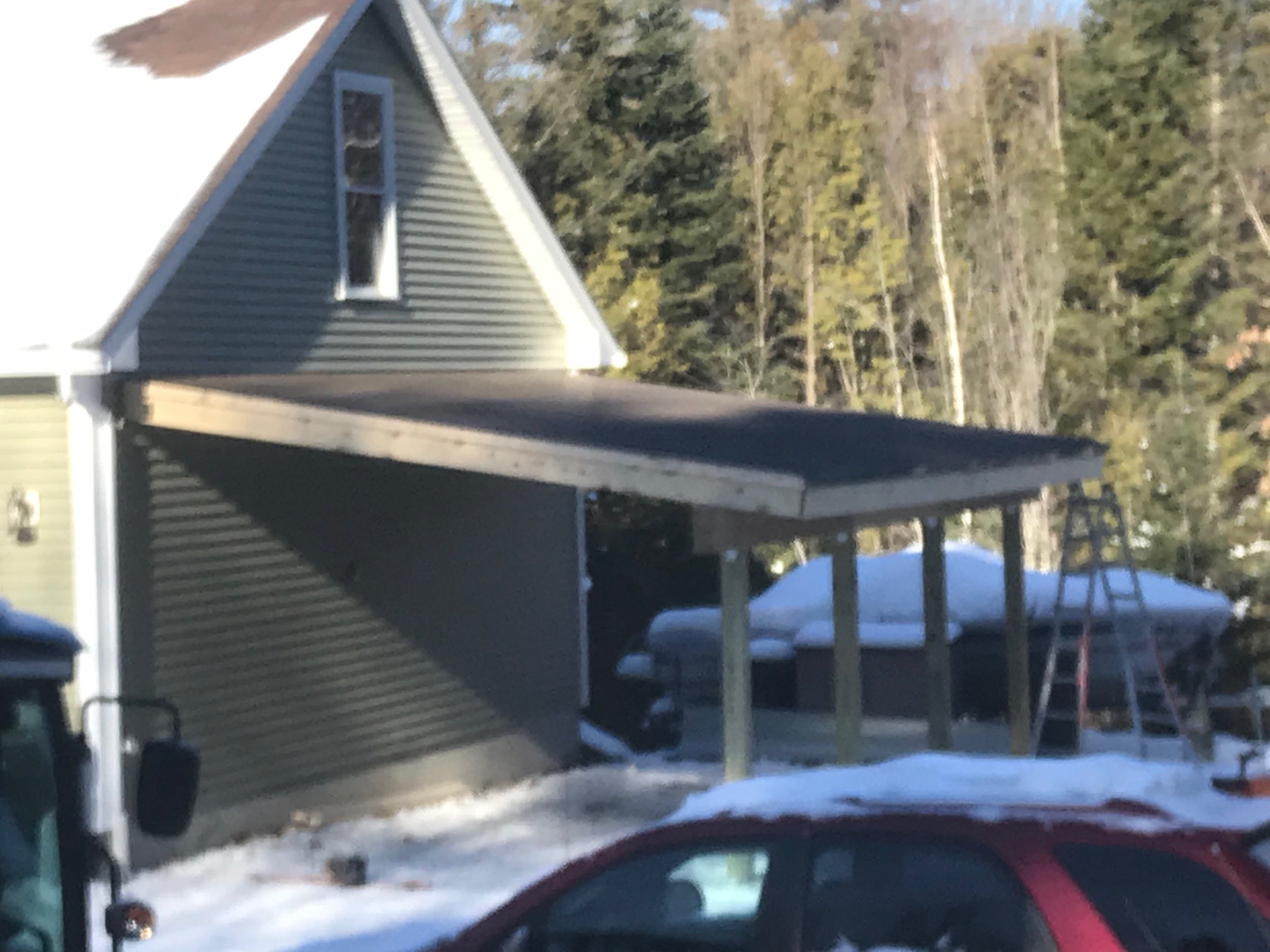

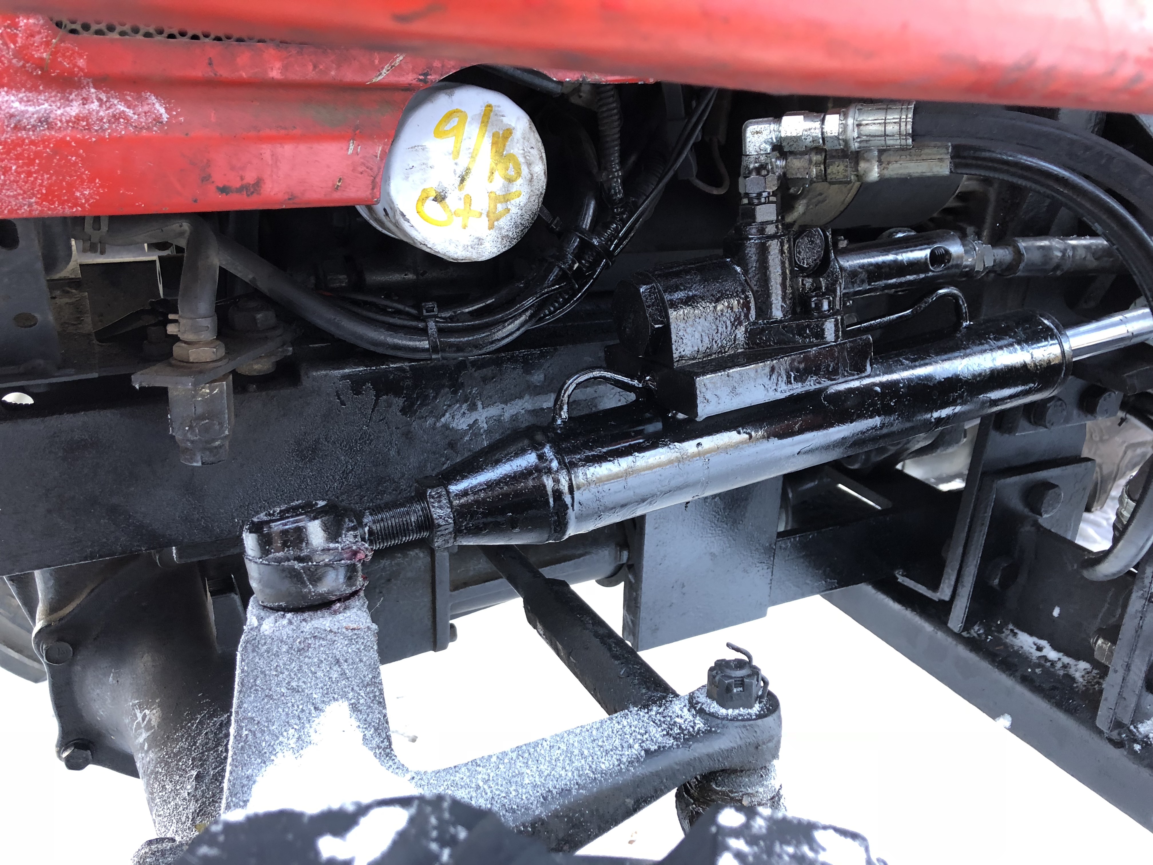

Yanmar 187D has battled Oswego county snowbelt weather 30 years. Recent upgrades are a woodmaxx sb60 rear blower and Deere x500 series snow cab (let me know if you want details, this was an easy adaptation, has a real door, and cheap <$450 on eBay all the time). synthetic hydraulic oil (napa) and 5-40 Rotella synthetic keeps it starting easy. Recent power steering add on. plow is some homemade which bolts into bucket with 4 bolts.

Looks good and should get the job done in relative comfort
   / Pictures of your snow weapons #3,899
no more head to toe carharts and mask and goggles (we get some wind out there sometimes).

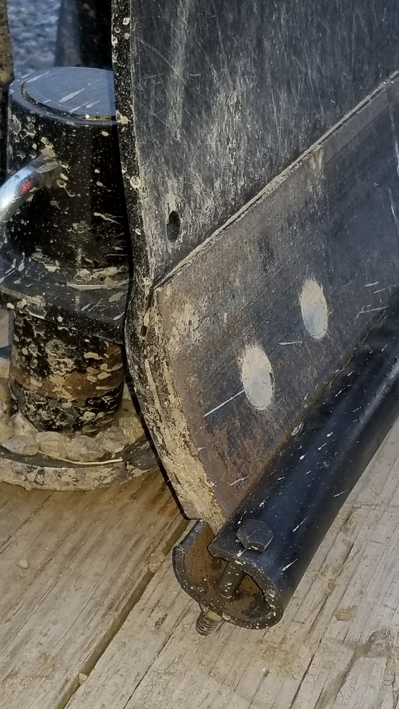

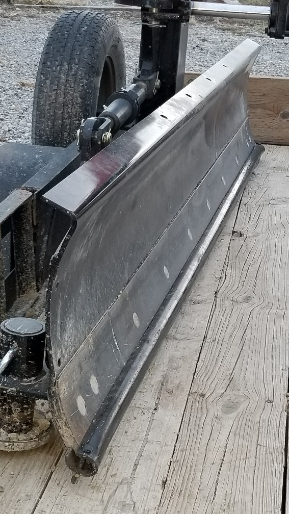

Finally got around to getting a pipe on my blade for plowing. The hope is that I don't move so much gravel when I plow snow. I had it made at a local welding shop. They suggested putting the bolts on each end to pinch the pipe and help hold it in place. It also has two short lengths of chain welded on the pipe to chain it to the top of the blade. Just got it back today so I haven't used it. Looks like snow tonight and the next few days so I'll see how it works on the gravel.
