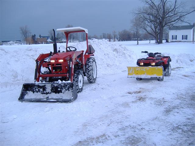

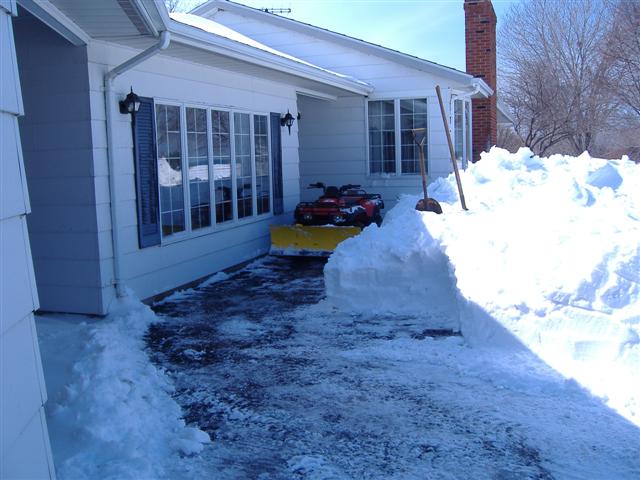

My toy's, Forgive me Tools. The wife wouldn't understand!! :laughing: 2000 Honda with 48" Blade. 2008 NorTrac 254 with FEL and Rear Blade. Working on a cab and Rear Snow Blower.

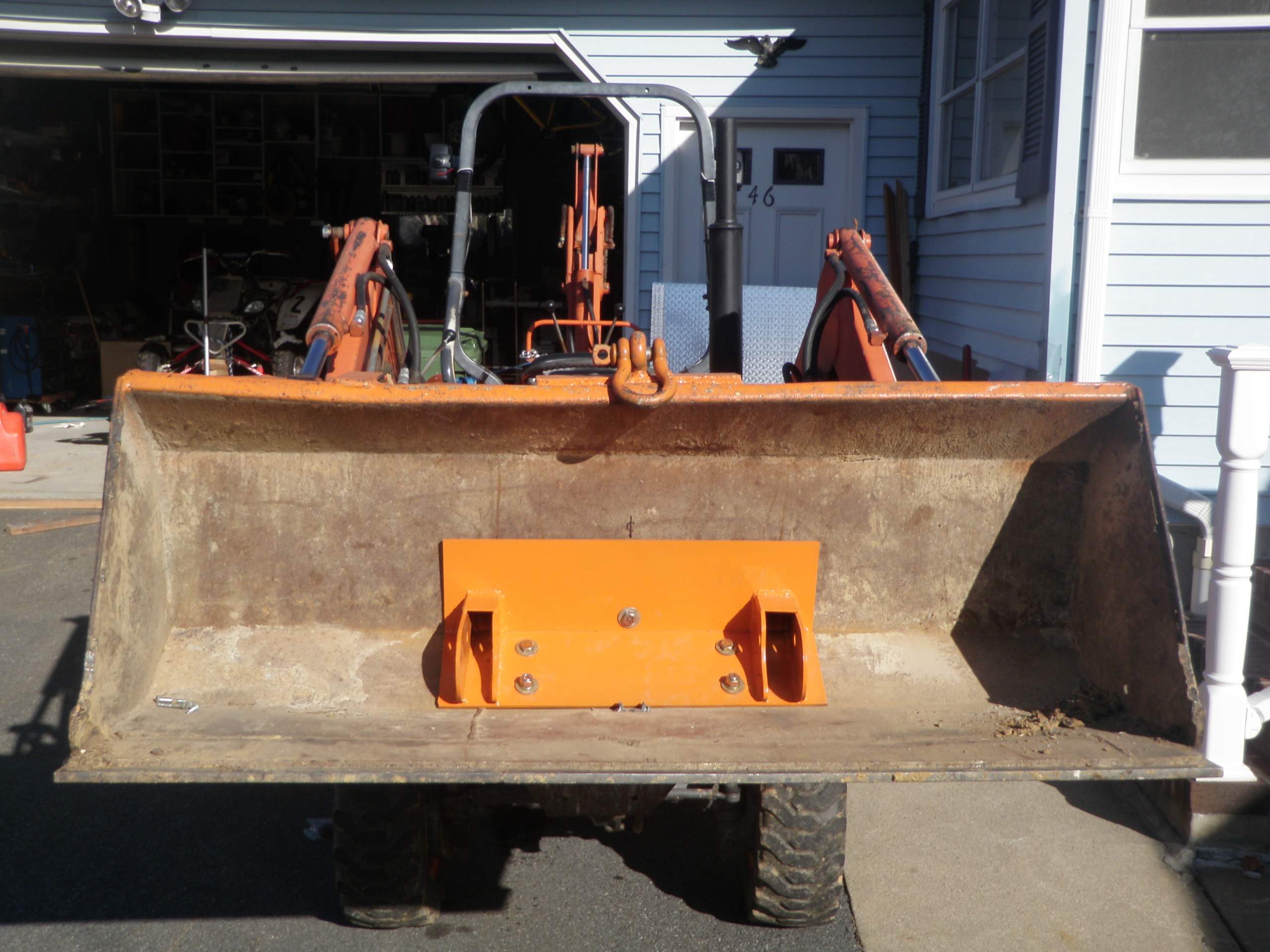

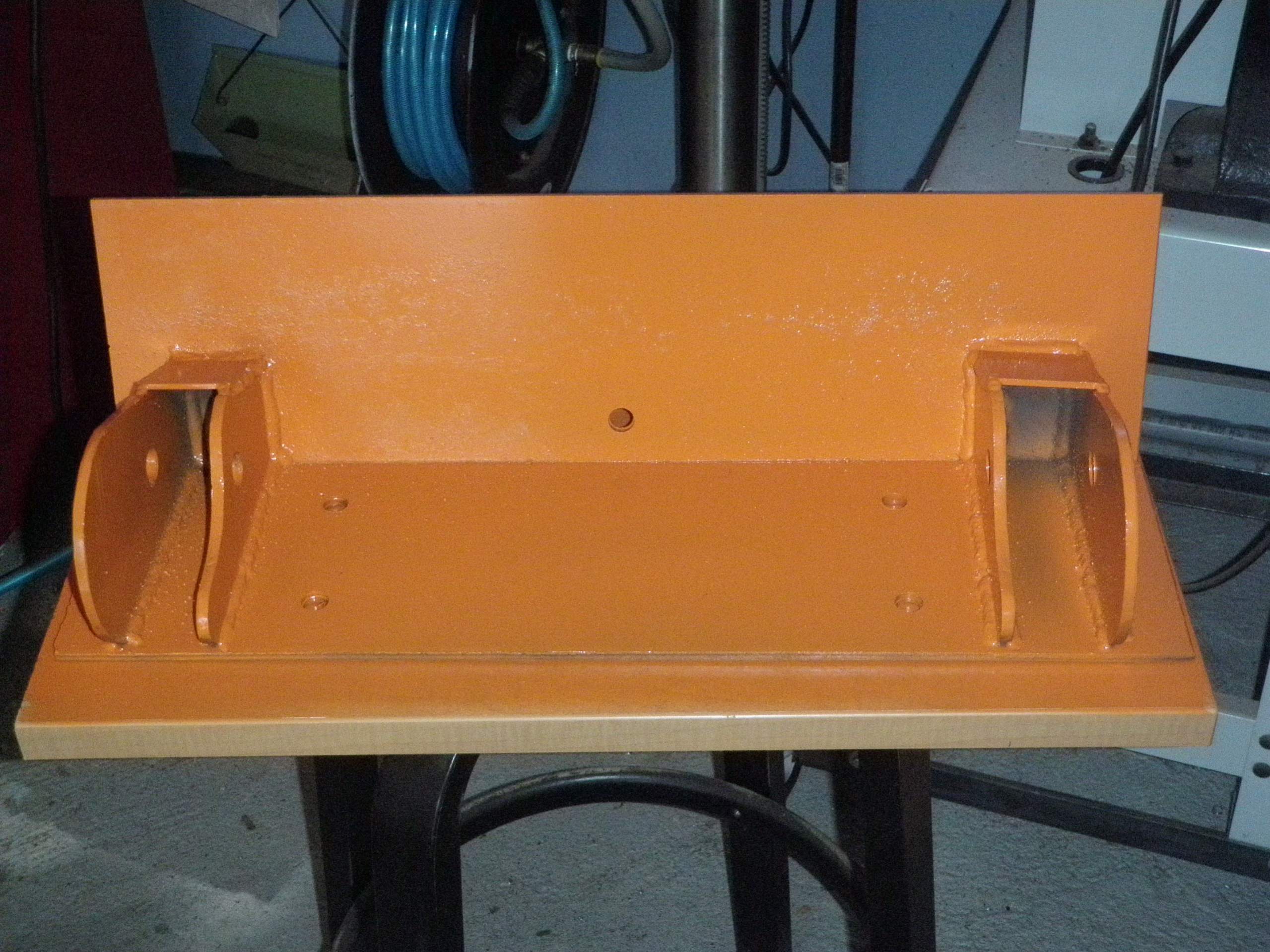

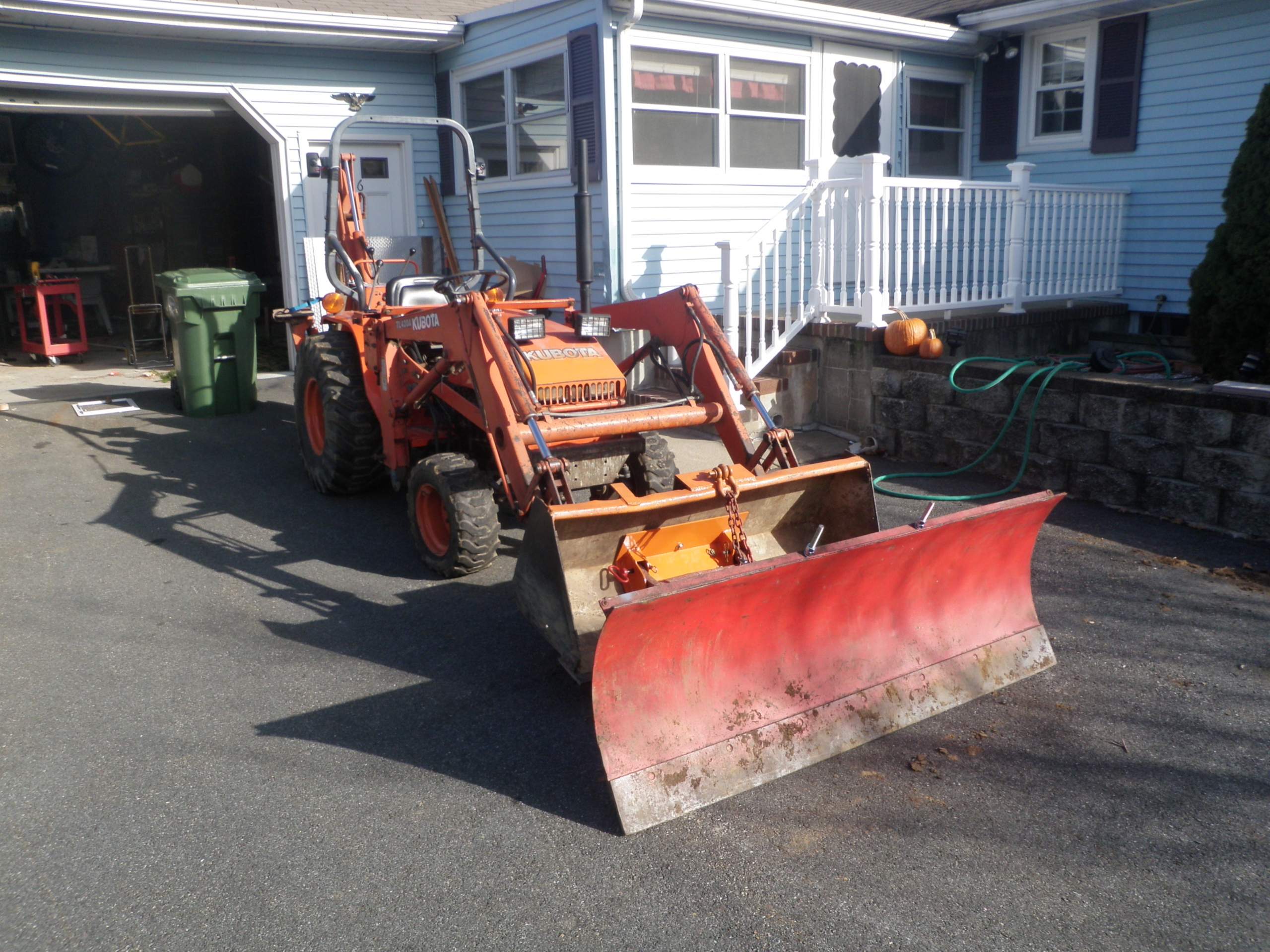

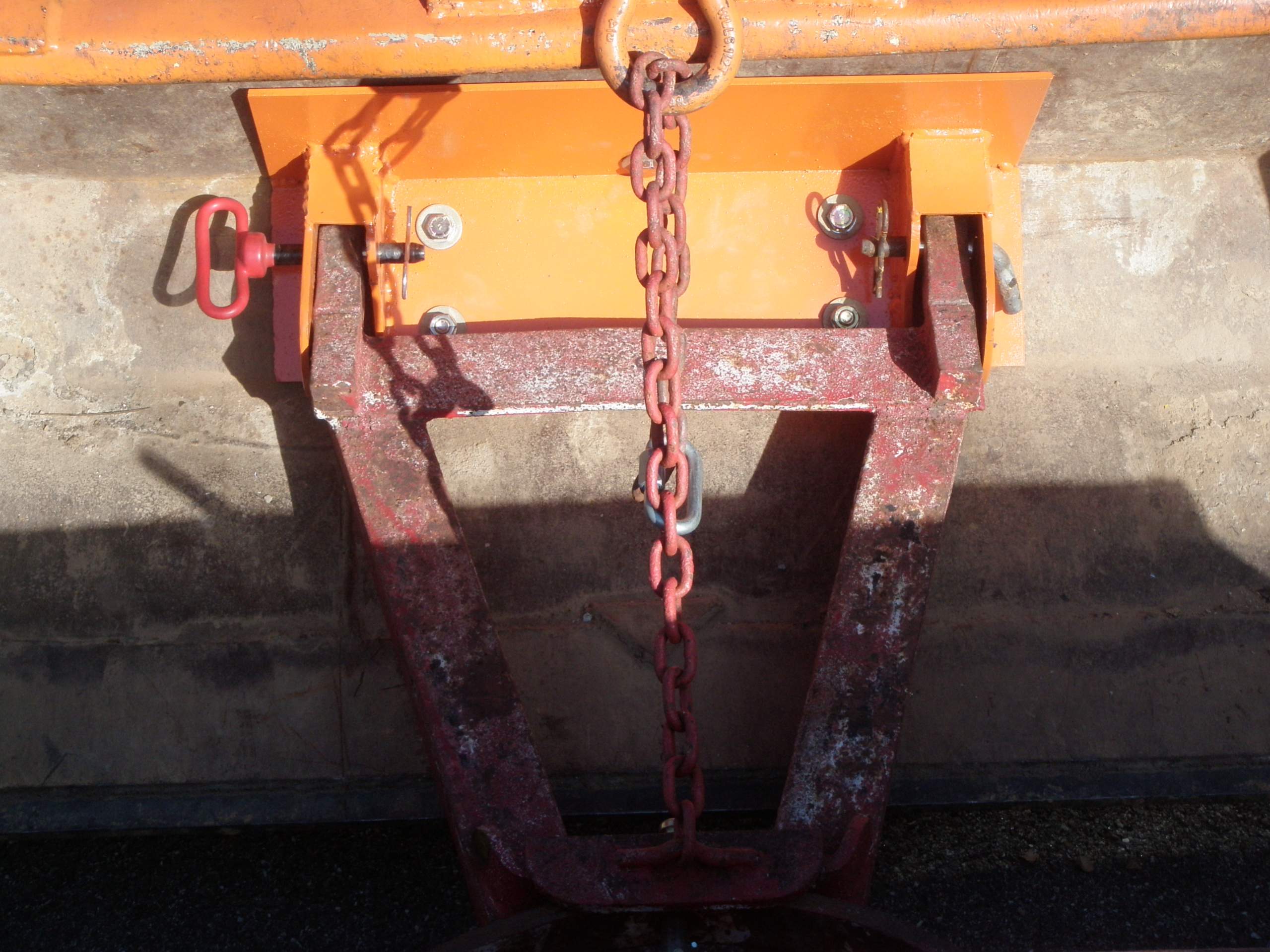

Here is my B20 Almost totally setup for snow. I am in the middle of making a canopy for her with 1/2 windows for me. The mount plate is made of all 3/16 cold rolled plate and everything was cut with my Lincoln Plasma cutter. Took about 7 hours to build and weld up. The plate is bolted into the bucket with 3/4 grade 8 bolts, so that in the off season I can not have it in the bucket. Plow was bought on craigslist for $50.00. It will be going out for media blasting and will get a good coat of Kubota Orange in the spring. Plow is 6' wide and 28" tall. For now it's a manual angle until I can find away to add a hydraulic circuit to the FEL.
I have a 150lbs weight I put in the backhoe bucket to balance out the weight a little or the steering gets a little heavy.
This replaced my 05 f250 with a fisher xtreme v plow. I will miss being warm this winter, but I will still have fun with the Buta!

Nice job on the removable mount robs660 :thumbsup:
   / Pictures of your snow weapons #399
ROB nice job on the quick hitch, but really you can go to tractor supply and buy one more quick release pin and put your truck trailer hitch pin back! Just joking....:laughing:
   / Pictures of your snow weapons #400
Hitch pin is off my wife's truck. I couldn't find the other one
