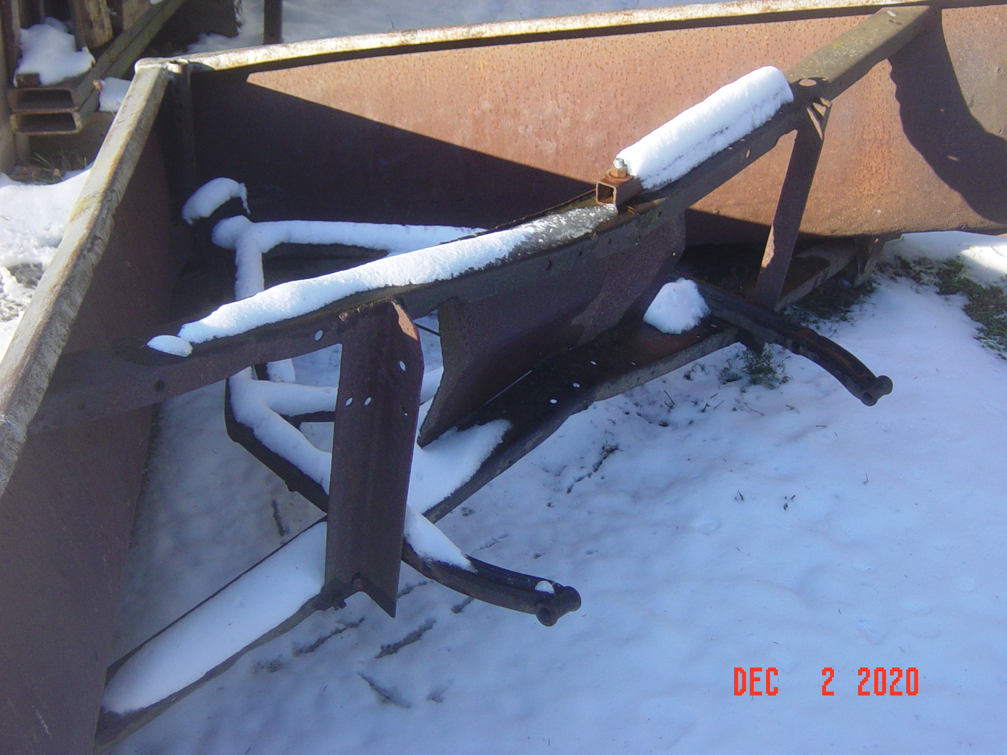

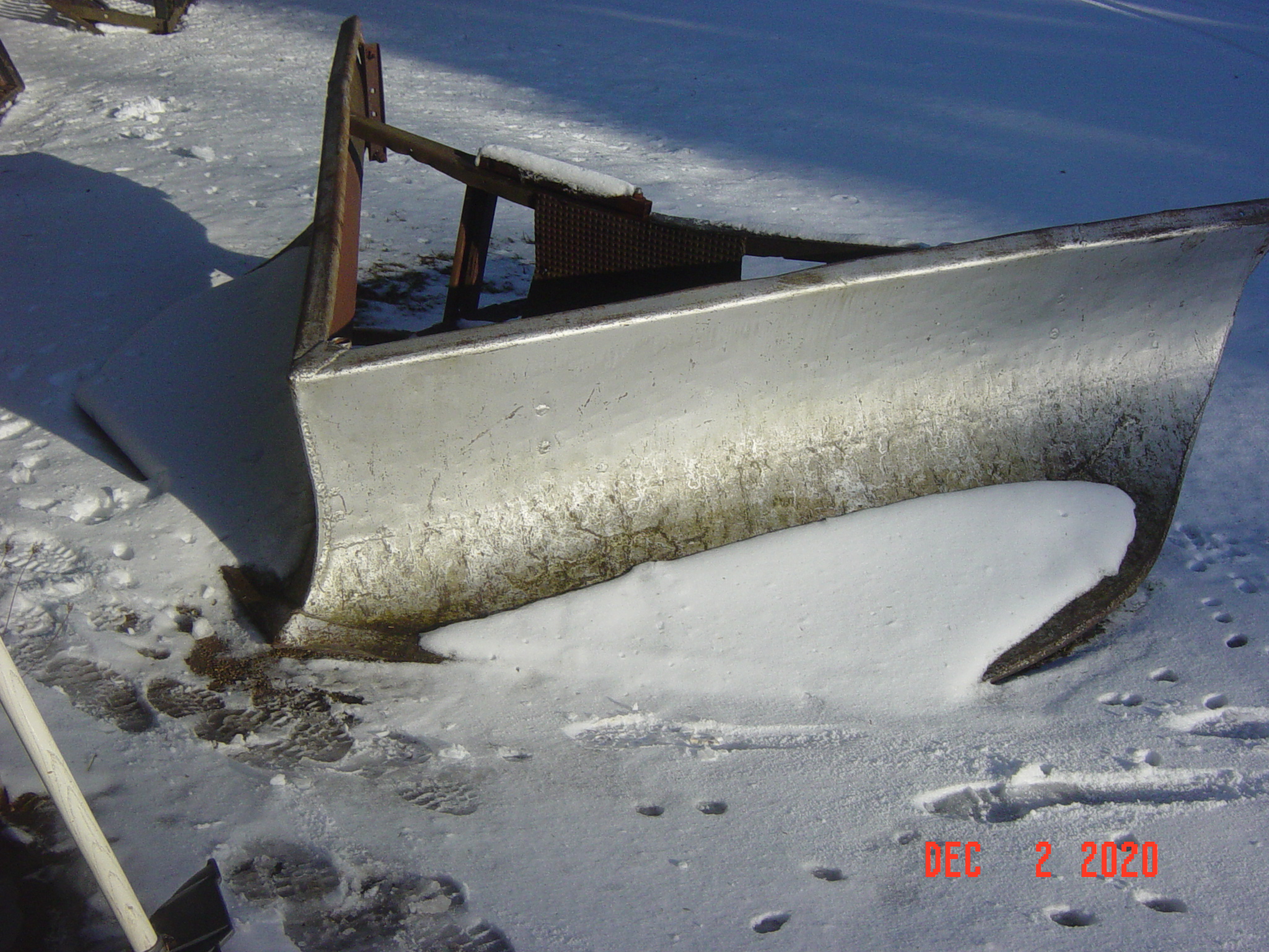

Bought this ten foot V Plow, Ancient Military, thing at an auction a few weeks ago. Want it to blaze a path to the back of the property a couple of times during the winter.
Wanted to torch off the Farmer scrap and snot welding, replace the frame and just weld on a SS plate. Easy-peasy.
Seems I need some up and down as well as lateral float, so now it's become yet another project. :mad:

Depends on how pretty the path needs to be. Could just hold it up a few inches and leave some snow. Where you going to buy a blank QA bracket and build on that? You could put pivot points on the QA blank and mount a 'mast with a chain to give you plenty of float. If the pivot points were slots that would help the horizontal float too
