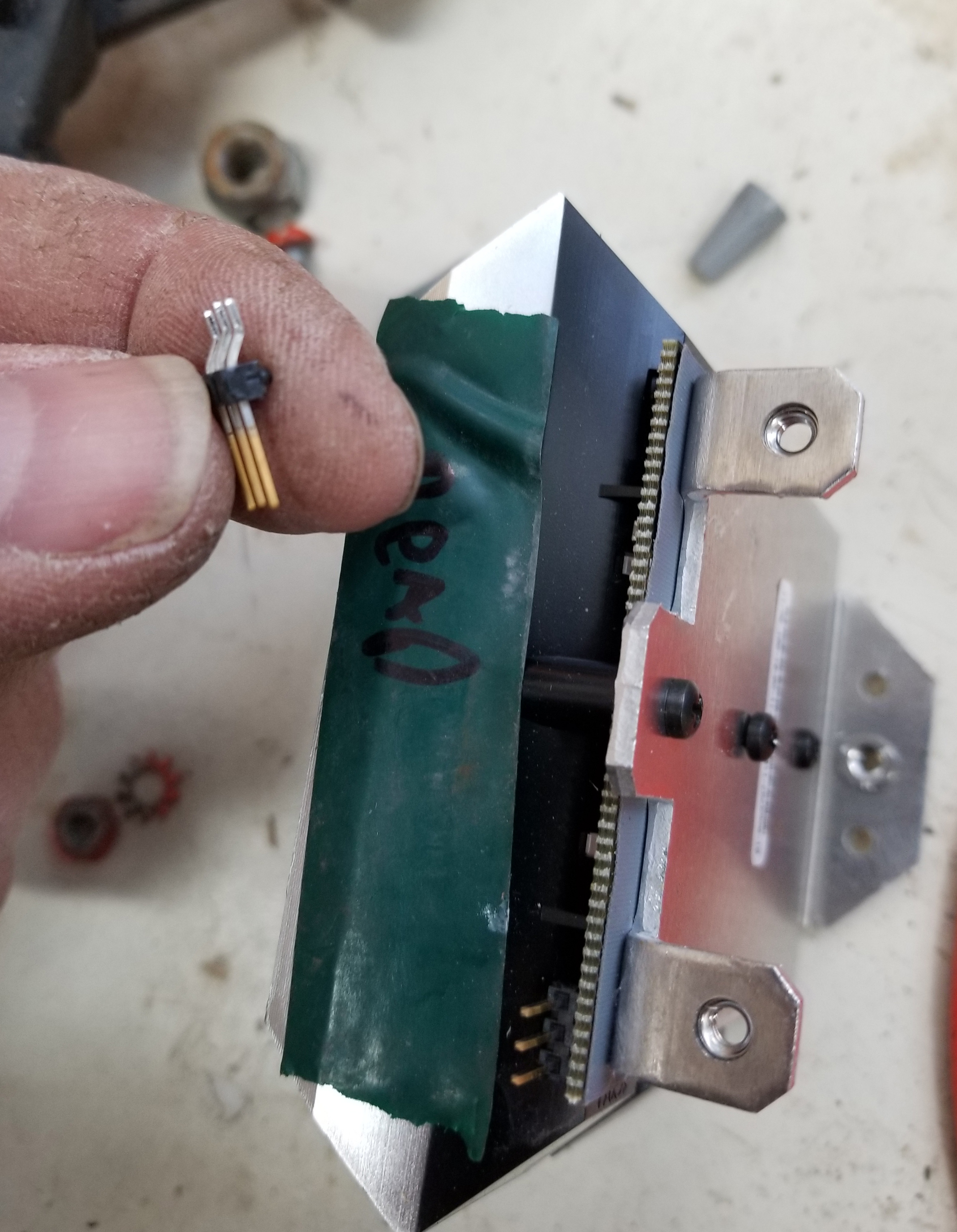

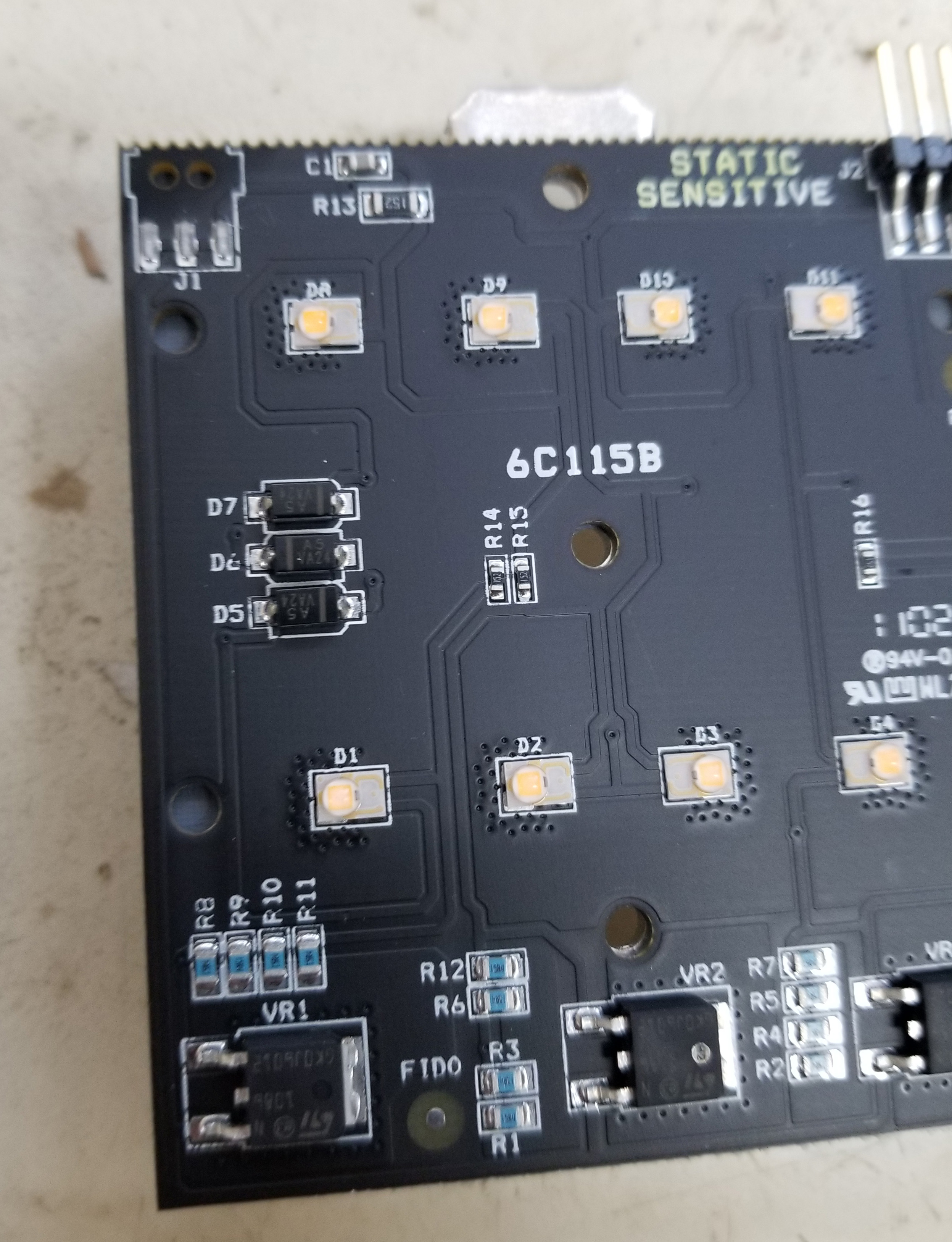

maybe i spoke too soon about the Whelen light. i removed it to send it back to factory in Connecticut, as they emailed me back that they could fix it. just for the heck of it i opened it up to see if i could find out what was wrong. i found this 20201207_091631.jpg 20201207_091723.jpg
it was obviously not soldered on correctly, so i thought what the heck, lets fix it. i am not the best with small electronics, but i do own a soldering iron. i repaired it and what do you know, it works again. bright as ever.
while it shouldnt have popped off like that, at least im not out a bunch of money for shipping, return shipping and repairs. it had a 5 year warranty, and thats ended awhile ago.

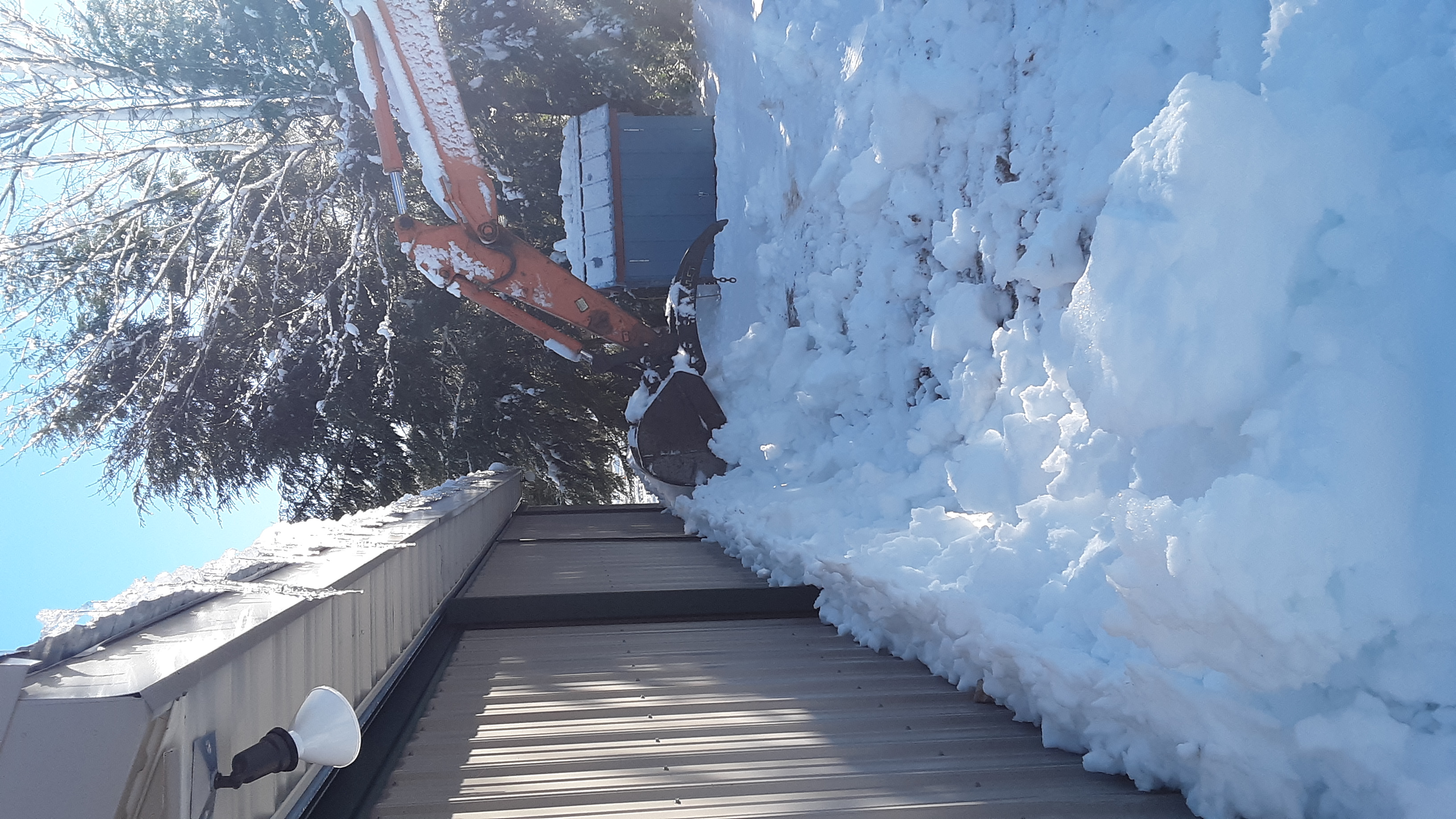

Not exactly you're typical snow weaponry :laughing:
I have 200' of that. We had a wet snow on a bare metal roof, then cold. Usually a job for the SS but I have it in the shop for some maintenance that I need to finish.
A light fixture that will see all the vibration of an automobile probably should not have Surface Mount Connectors on it. I designed PCBs for 30 years. Started years before computers.. CAD/CAM
