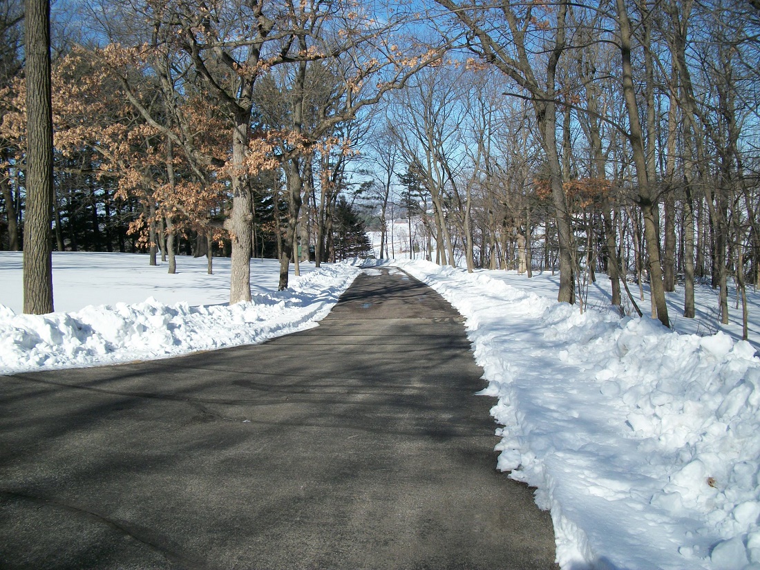

Keeping it winged back between snowfalls is a way to handle that.
