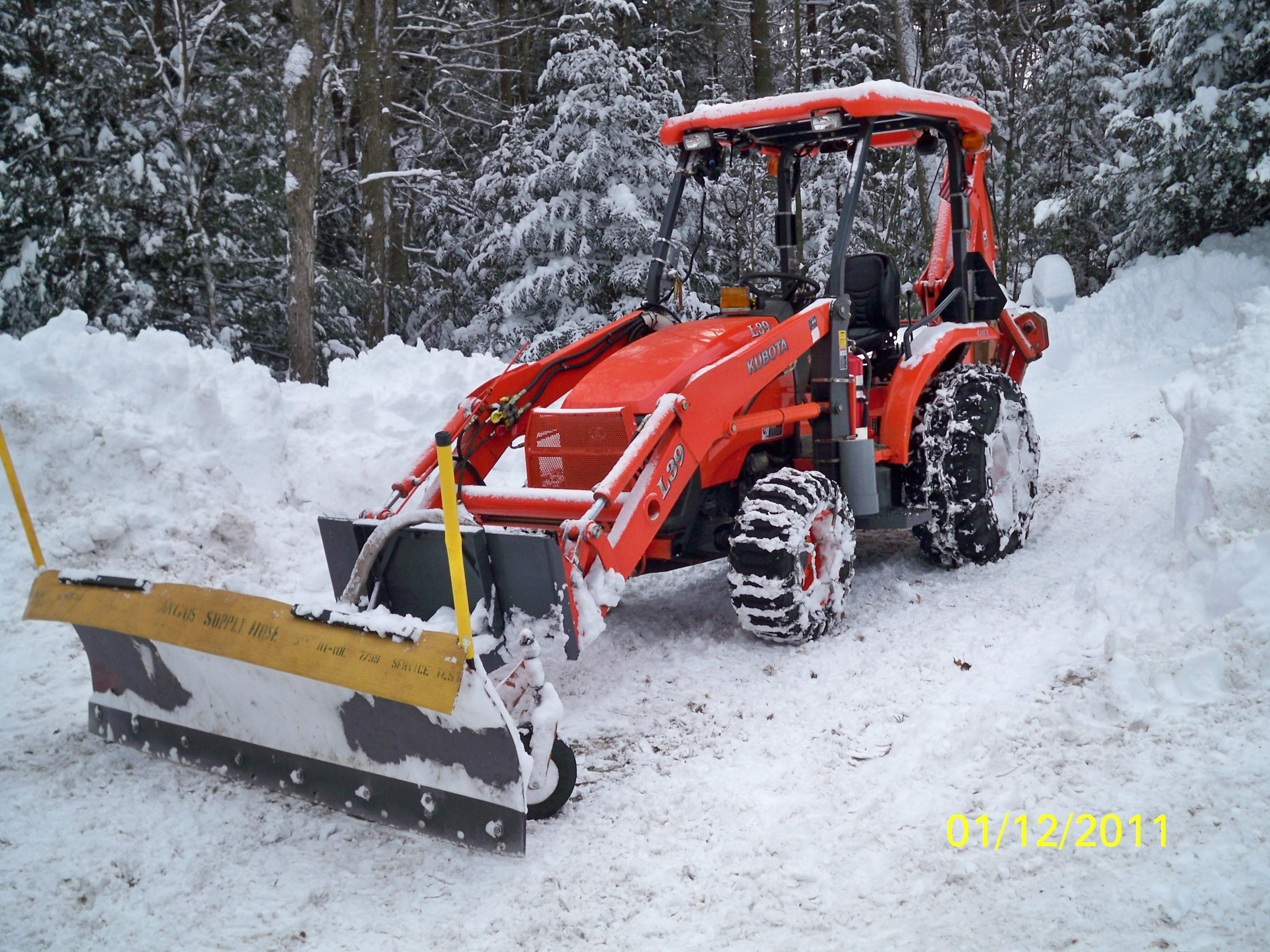

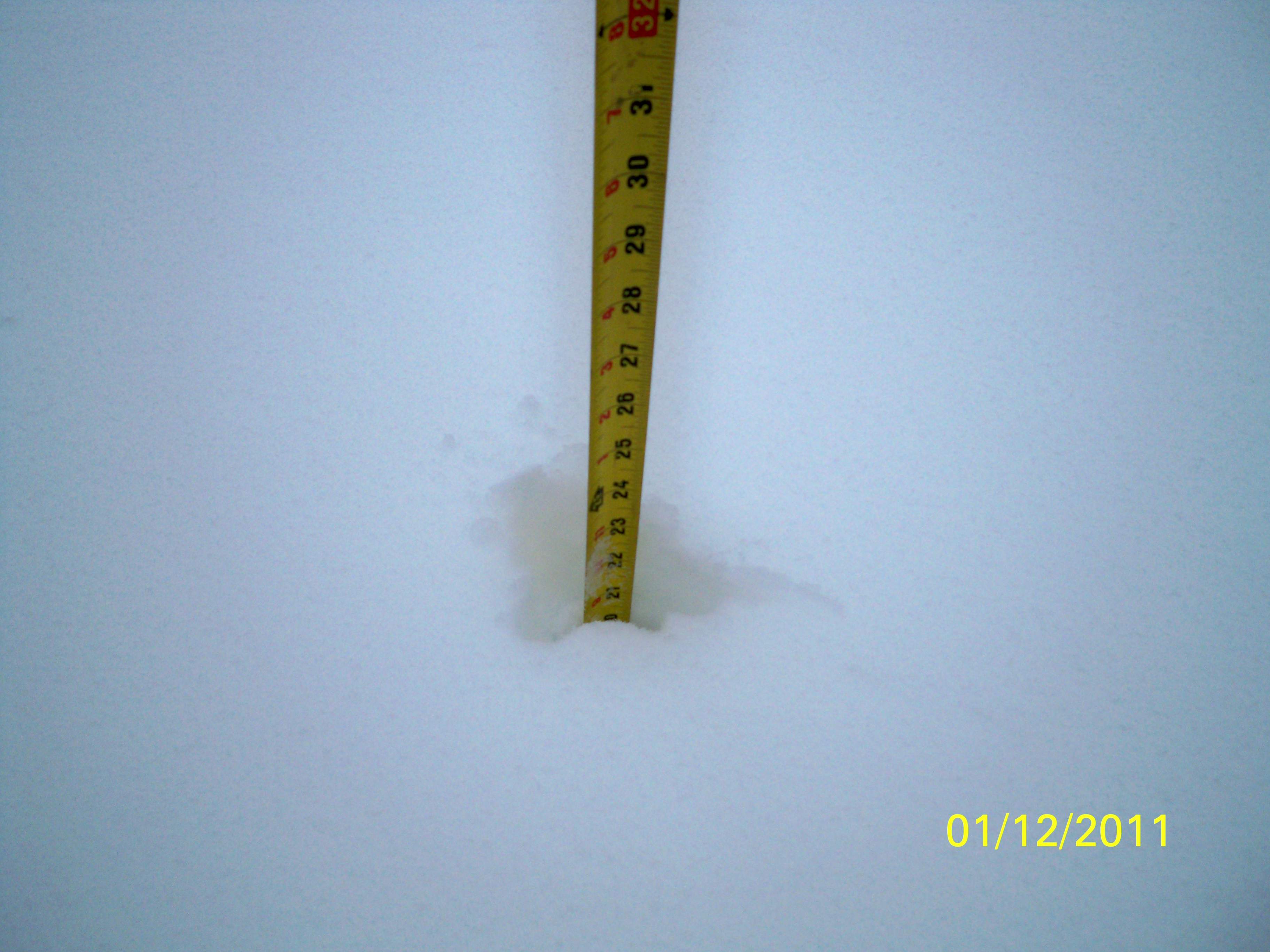

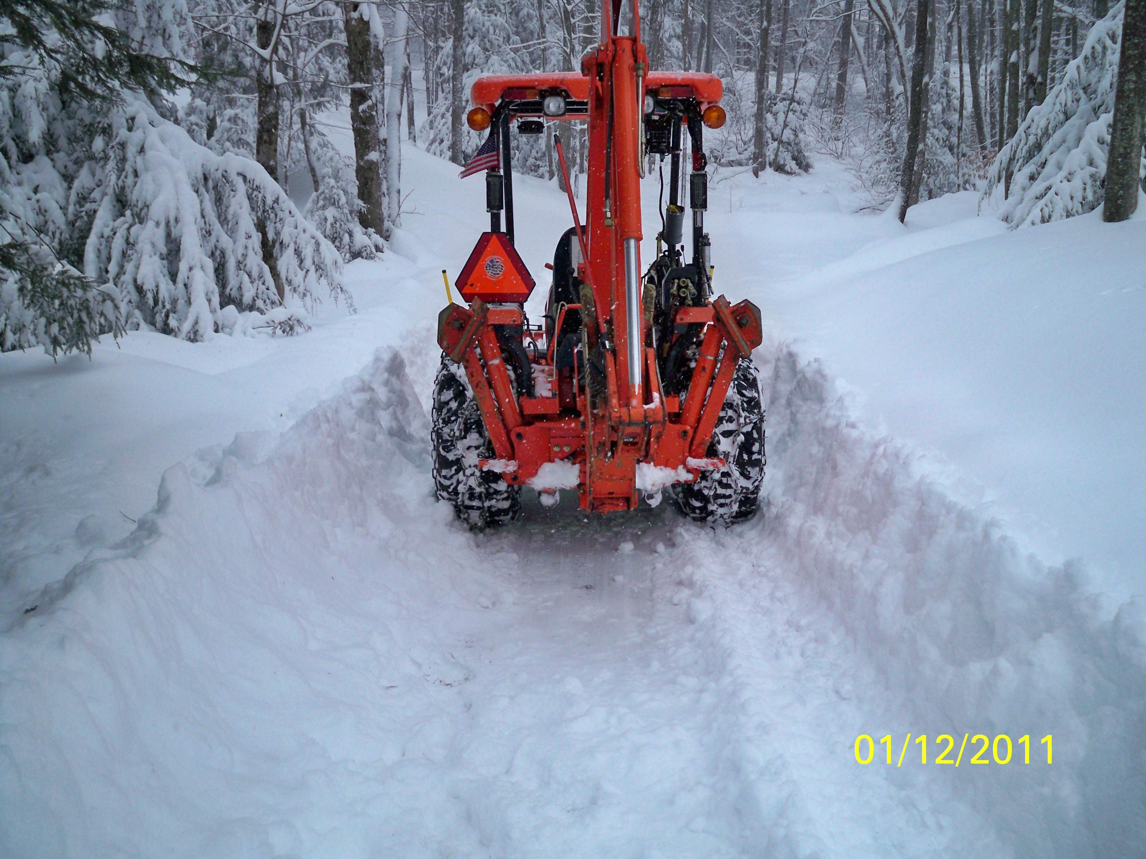

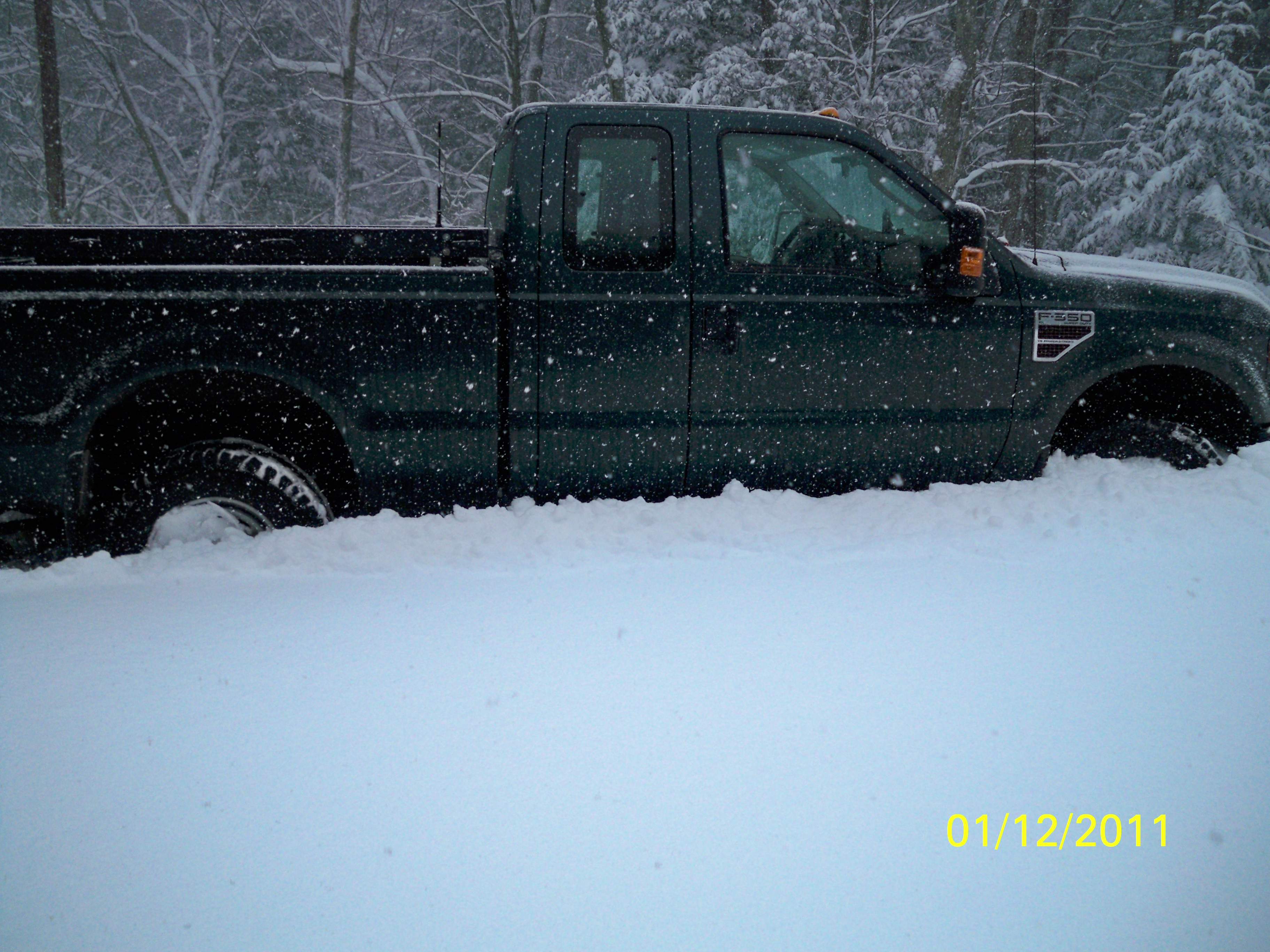

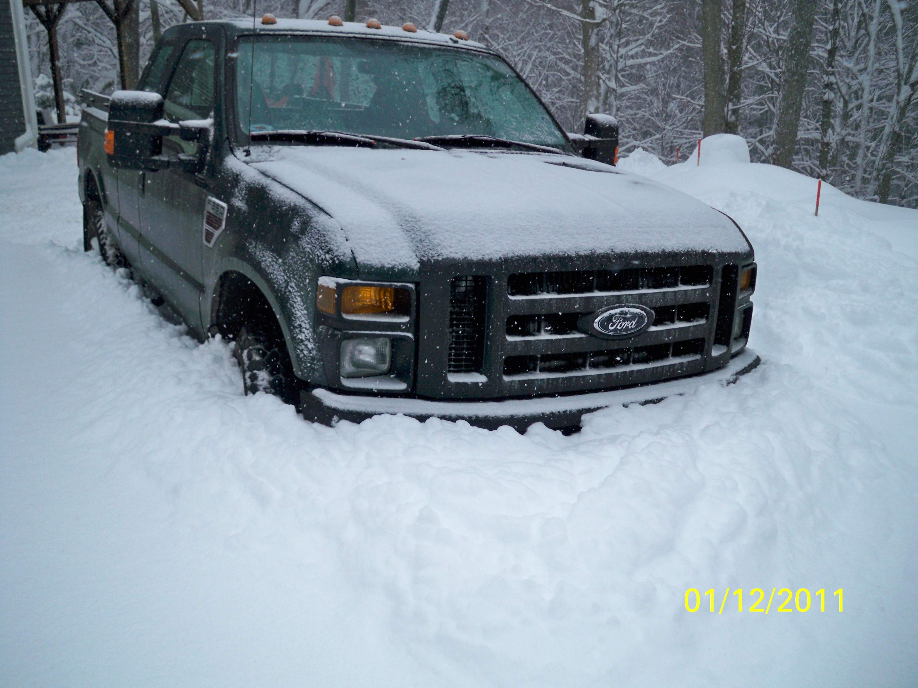

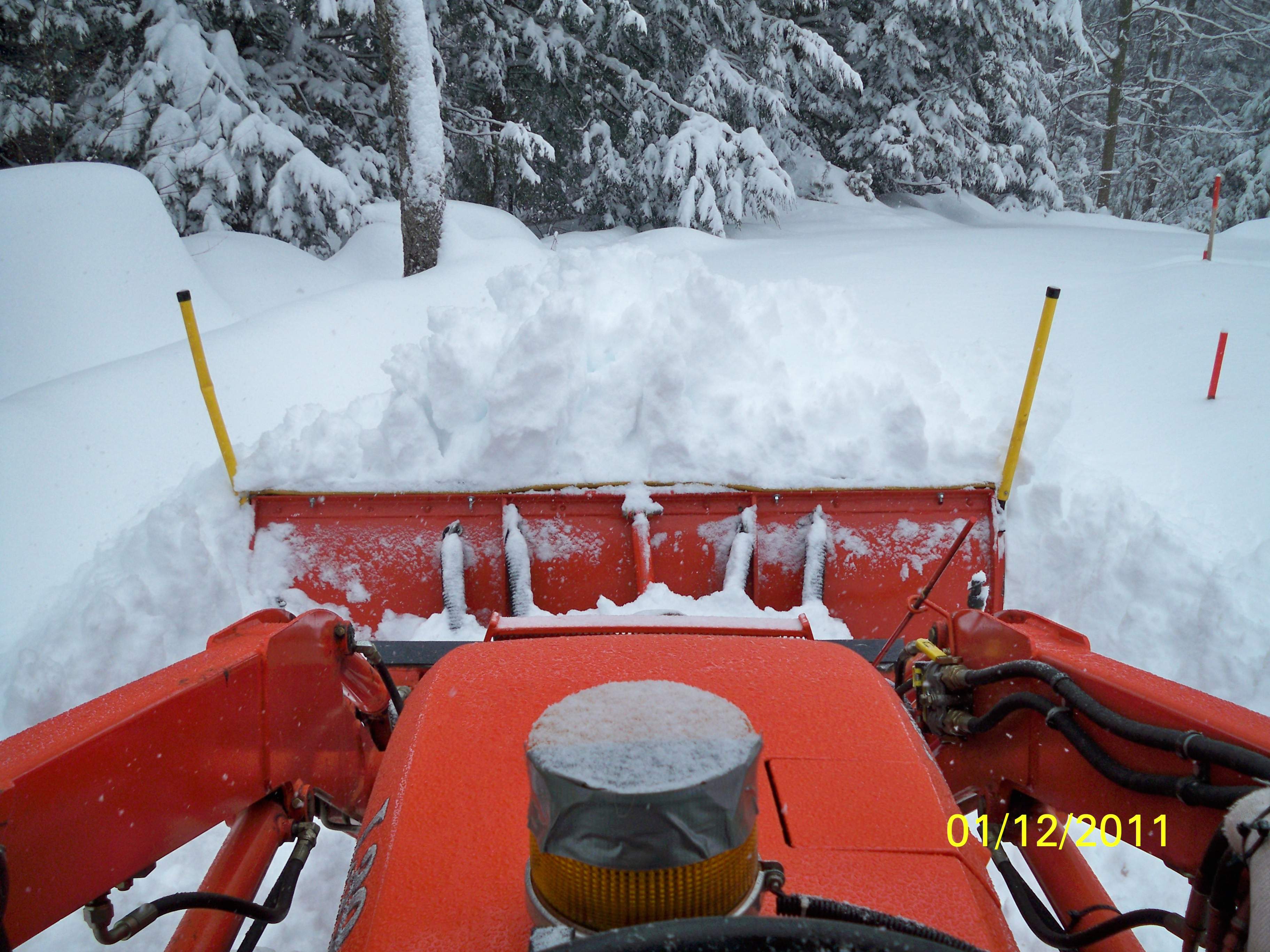

In CT, the weather forecasters were finally right. I got 20"-24" ave. at my house.
It was deep enough that I got my truck stuck pulling out of my garage, so I could get the tractor/plow out to the driveway.
I posted some pictures, but forgot how to resize them. All in all, a good day as nothing broke on the multi-time repaired, found in the dump, snow plow. I seem to have finally engineered it right. I welded a mount to attach my landscape rake wheels to the plow frame, to minimize the plow trip on my uneven gravel driveway. After experimenting, I had the tires foam filled to support the weight. The wheels allow for faster plow speed by holding the proper loader curl angle, while floating the blade.

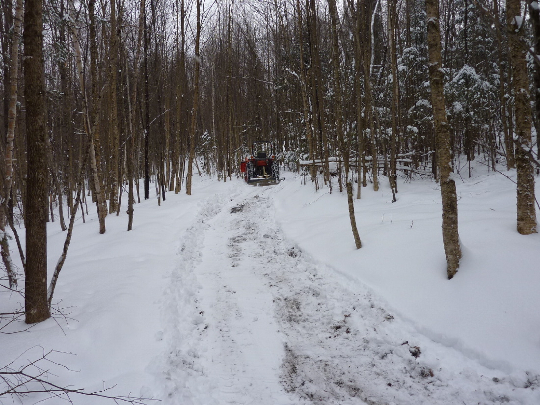

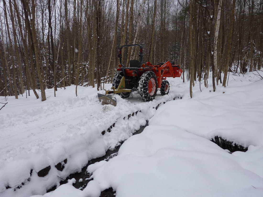

We only got 8" to 10". Plowed the road yesterday with the one ton, then back draged what we got last nite to start building my smooth snow road again after it got ruined by the rain new years. This after noon I pulled the snoww off my skid trail so it will stay froze.

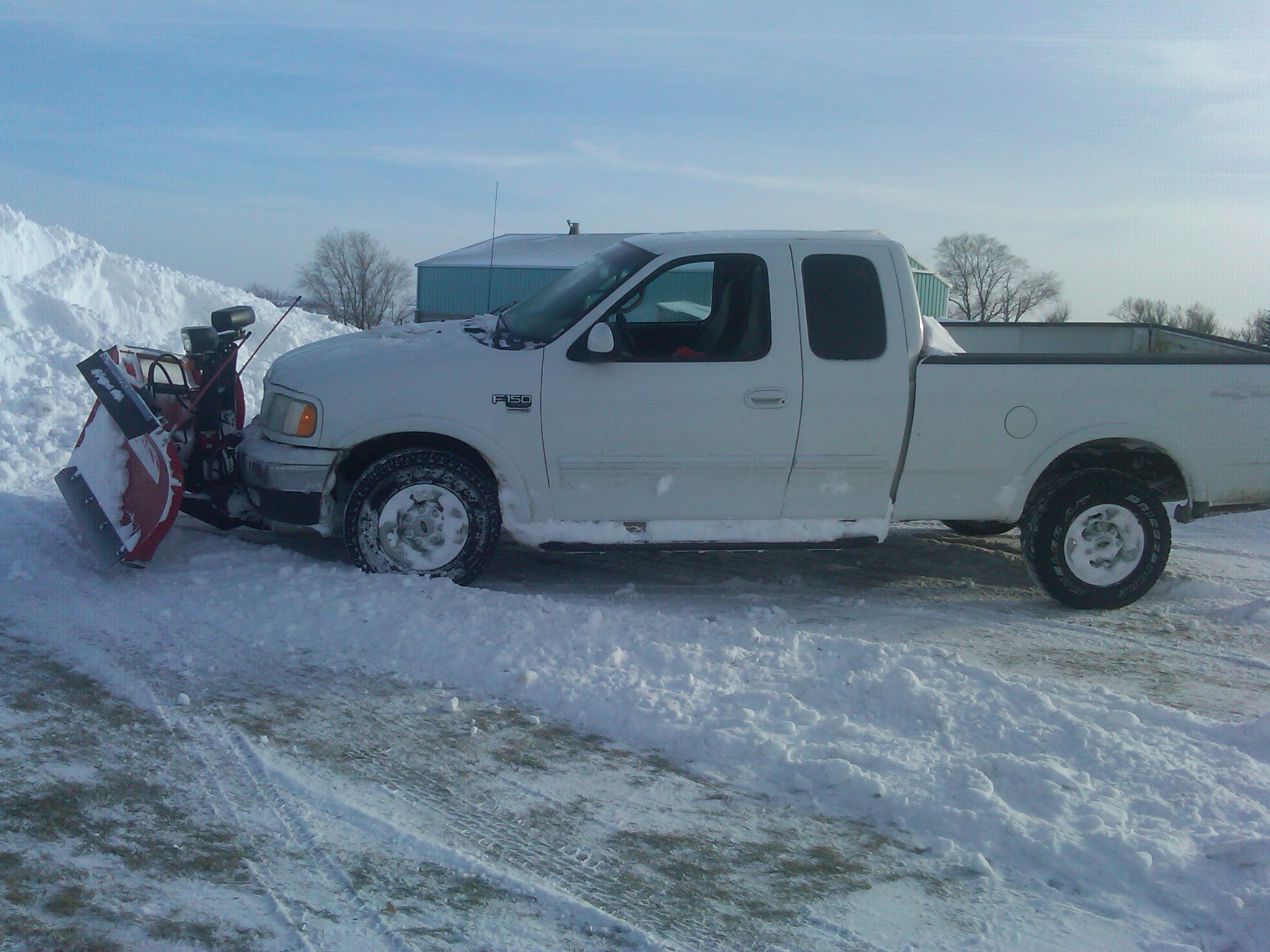

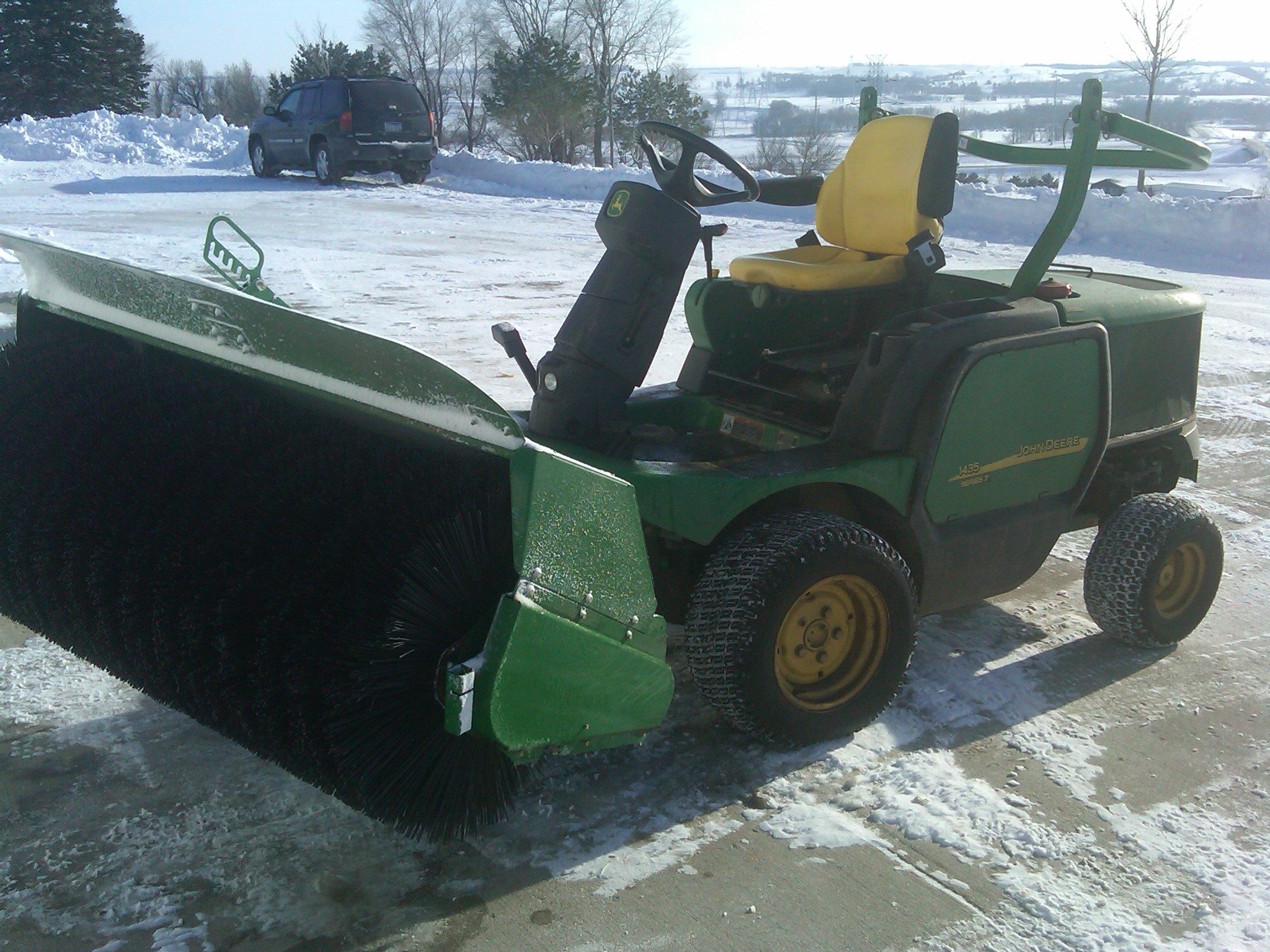

Thought I would add to the snow weapon pictures as we were out cleaning up some drifts and such. Only two pictures, a 2000 F150 with a 7.5' Boss Power-V plow, and our JD 1435 front mount mower with the broom attached. It leaves the cleanest driveway around and can move a surprising amount of snow.

Like the LDH on your plow...
