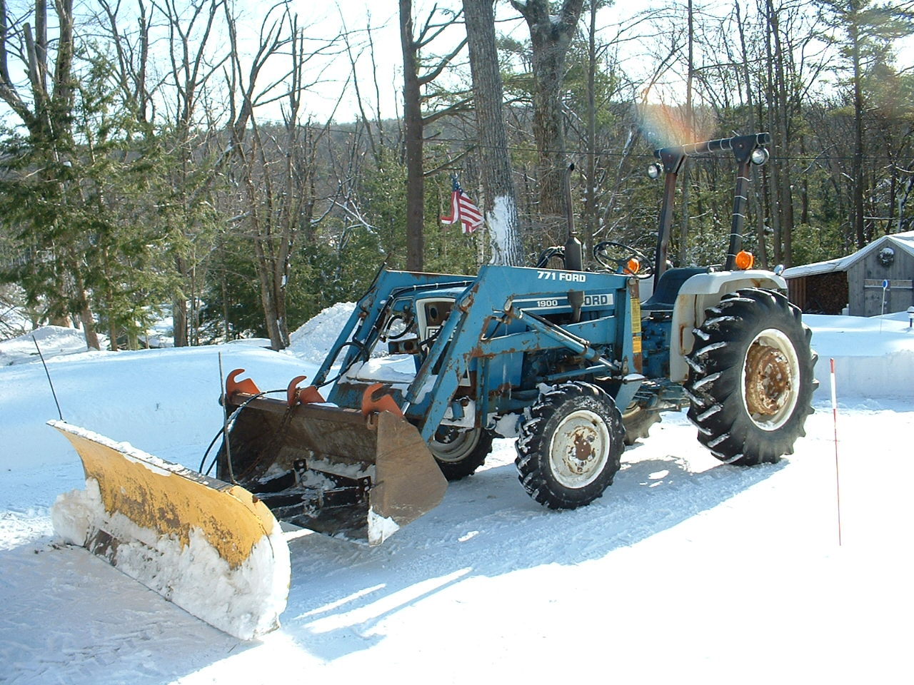

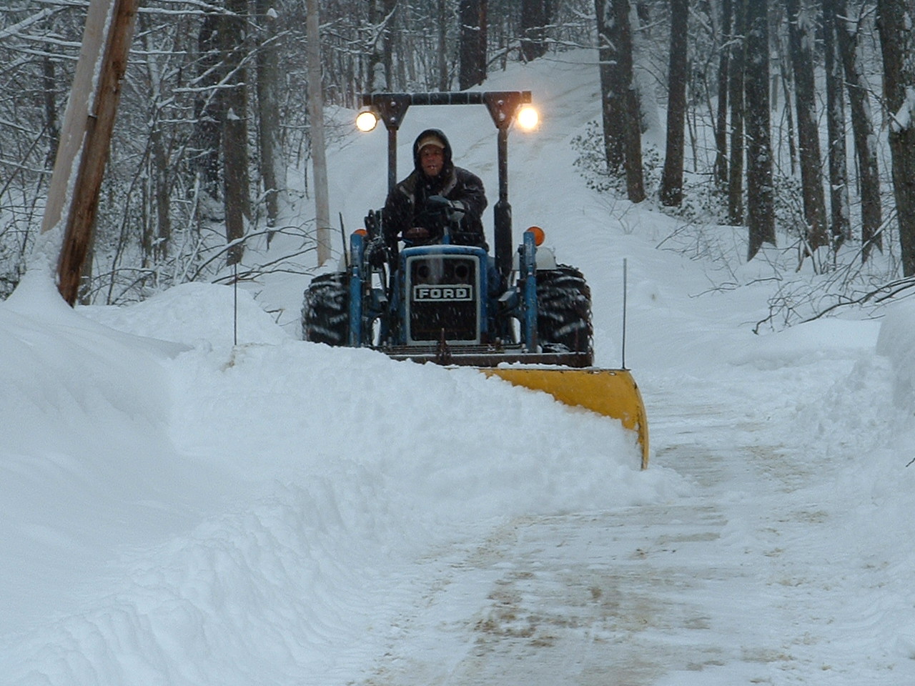

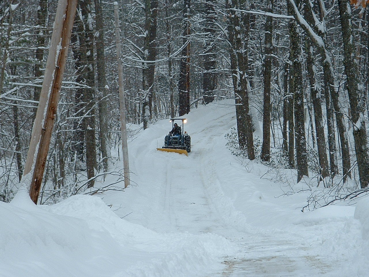

Heres a few shots of the old Ford and I taking care of our little chunk of the world....still need to make that cab. Rick

I like that attach setup, how'd you do it?

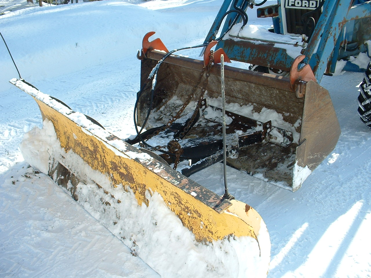

Hey Jake, I welded up the mount from some some heavy angle I had and bolt that at the very back of the bottom of the bucket, ran a pair of hydraulic lines from the scv's down the loader arms to the the bucket where I have quick disconnects to the plow. Hope this helps, Rick

Try Sim's Cab company up in Canada. They used to be in Rutland, Ma. You can even get them with a heater.

I procrastinated too long on a Meyers P/A for $150. Probably never see that price again, but I was thinking of a setup like that. What'd you use, 2 or 3 big bolts?
