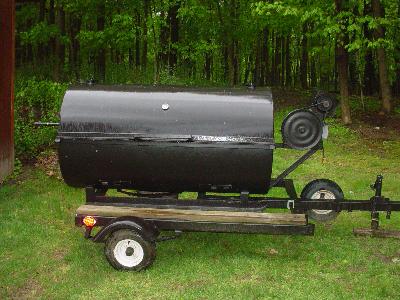

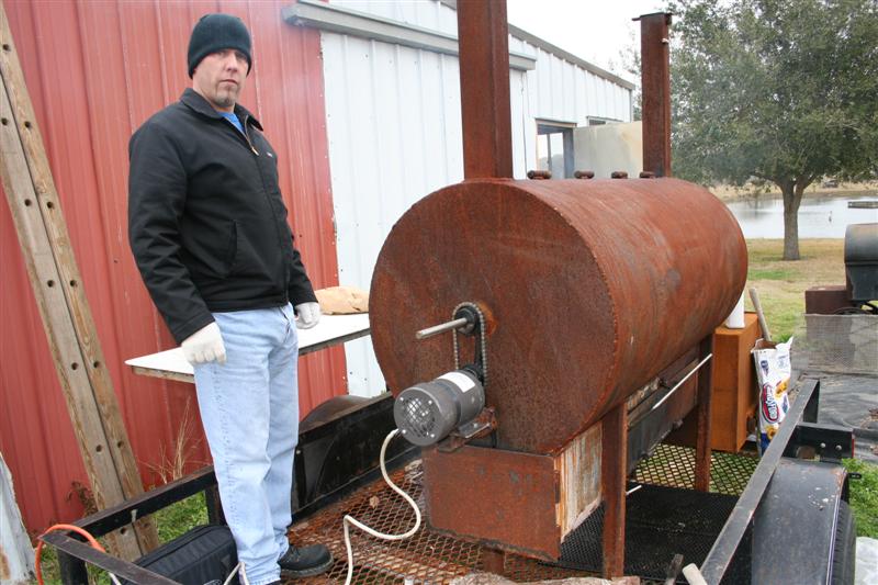

Saturday we roasted a 48lbs. half hog in a Cajun Microwave and had some mighty fine eating. A friend has a good size metal fabrication business and had his people build one out of Stainless Steel. We cooked the hog for about 6 hours, turning it one time, until a digital thermometer gave us a reading of 170 degrees in the main ham. The last 1 ½ hours we added sweet corn in the husks and also grilled us some other stuff on the fire tray with a grill he made to fit over it.
Hogslayer, I thought our weekend cooking might give you some base line to start from when you do your fist cook. My friend is a true Cajun and has used this type of cooker most of his life. On the one he built the cooking box is double walled with a layer of insulation between the walls. What he used for insulation is duct board, not sure of the proper name, that HVAC contractors use by scoring, folding and taping into parts for heating duct systems. I am not sure how much the insulation affects the cooking time so I would depend on a meat thermometer until you get a feel the one you have made. It would also seem to me that you could insulate your cooking box in a similar way with the duct board even without the outer layer of metal he had if you find it needed.
Let us know how it works when you give it a try.

This thread is just too interesting to not have an opinion. If I was to try roasting a whole pig I would get an old freezer, remove the liner and insulation and lay it on its back.
Line that with firebricks top and sides, cut a hole for air intake and chimney and a vent on both to control heat and smoke.
For the spit I would use 3/4" rebar ground round there it contacts the metal for support (It would sqeek but that adds flavor doesn't it? For the motor I would borrow the motor from my BBQ and just make sure the load is balanced by tying on weights (bricks?) to the spit.
I would fill that with cordwood about 4 hours before loading the pig and have some store-bought charcoal handy just in case. Open and prop up the door if it get burning too hot, maybe have an upper spit location too.
Now I hope the wife doesn't see this before she invites her quilters club over for dinner.
