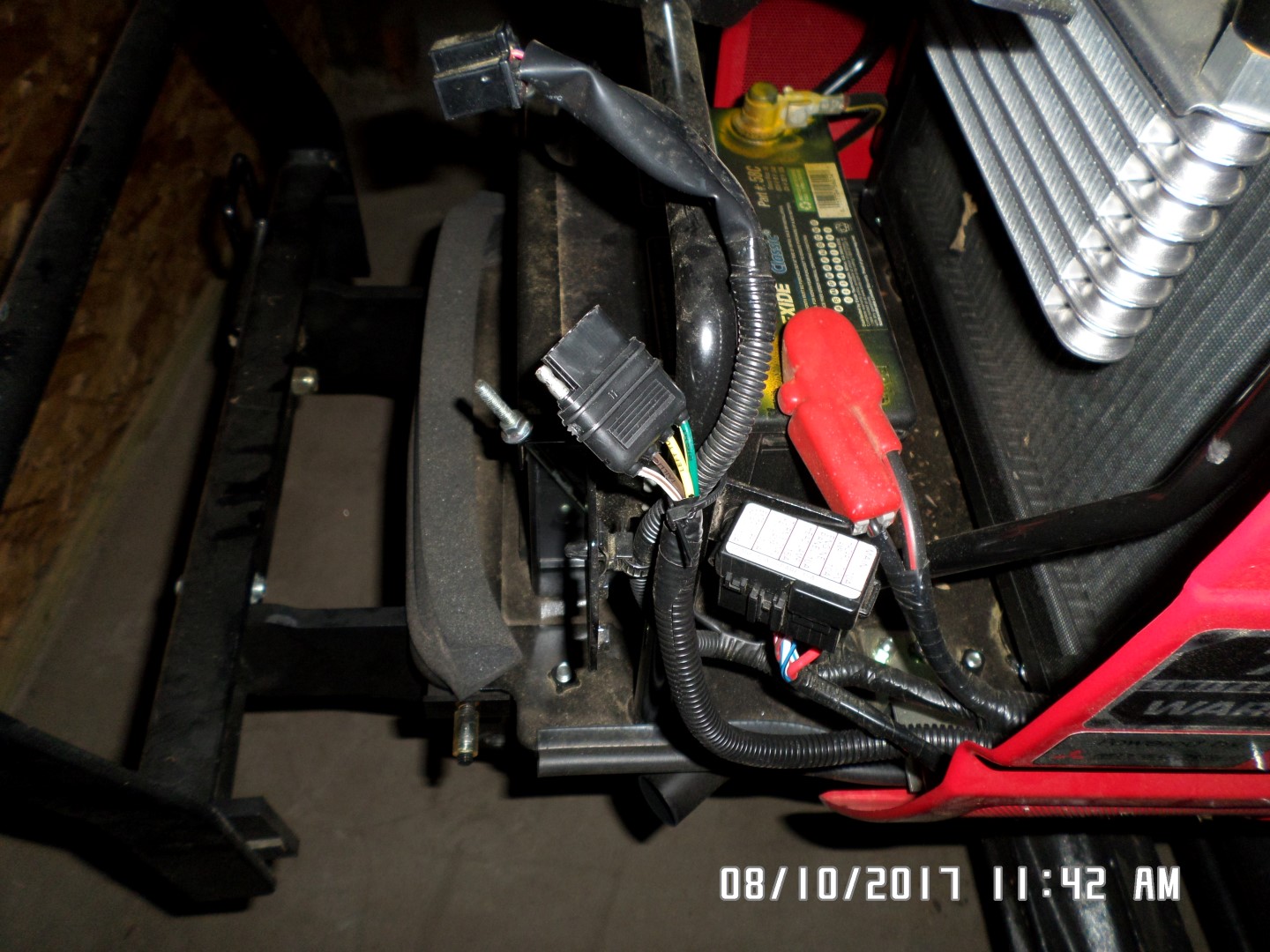

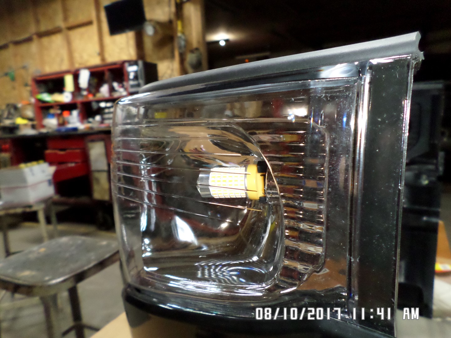

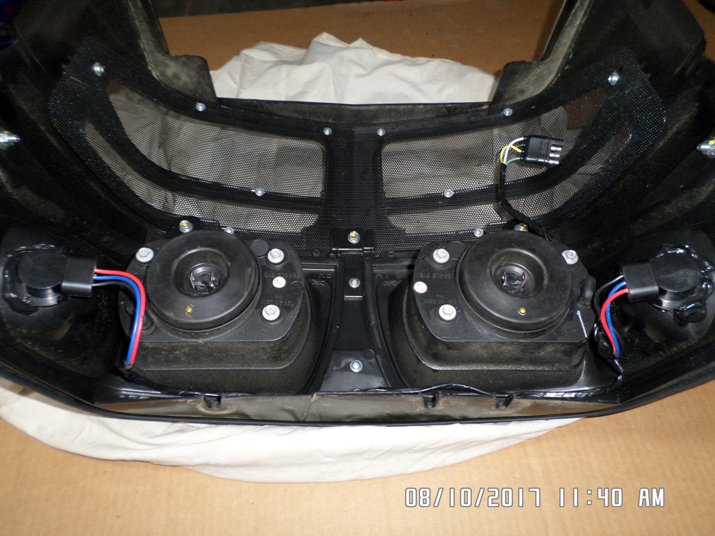

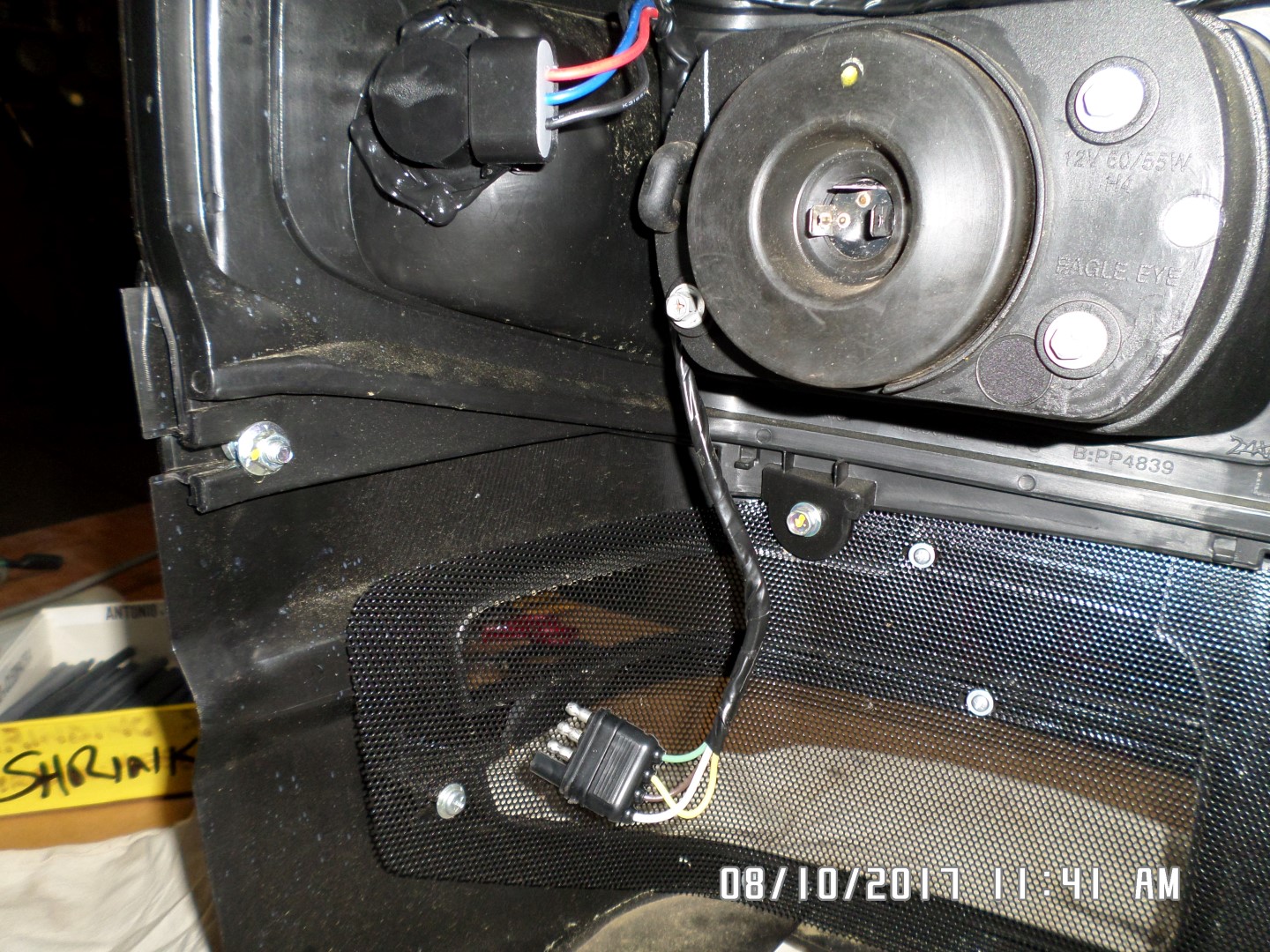

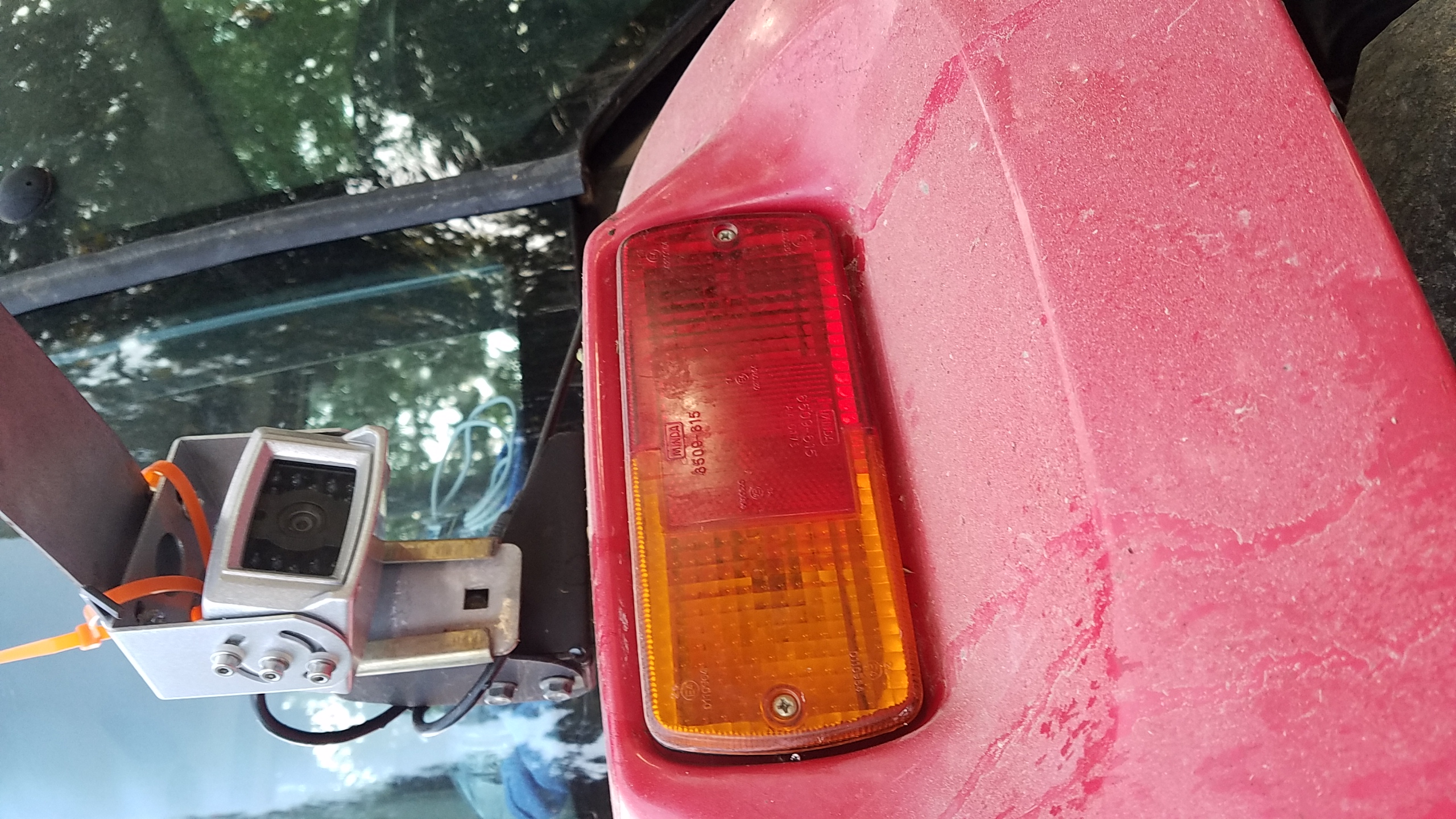

Just getting done installing two amber LED 1400 lumen lights into the front of my 1526. The power comes from the wires by the flasher unit under the dash, then runs up to the front light area. The stock light assembly does not have any holes to install the lamps, but has two thin areas where one could probably be installed. I cut out this round spot, then sanded the hole smooth with a dremel. The stock light sockets are still too big around for the holes, but a little careful grinding on my bench grinder thinned this diameter so it would fit. The whole shebang was blown clean with an air nozzle, making sure the inside of the reflector assy was real clean. The LED's were installed and tested in the sockets, wired, then the socket/LED assy was siliconed in place. Here is a link to the super bright [ blindingly so ] 1400 lumen lamps...
2X 14 Lumen 3157 High Power 144 Chips LED Amber Yellow Turn Signal Light Bulbs | eBay

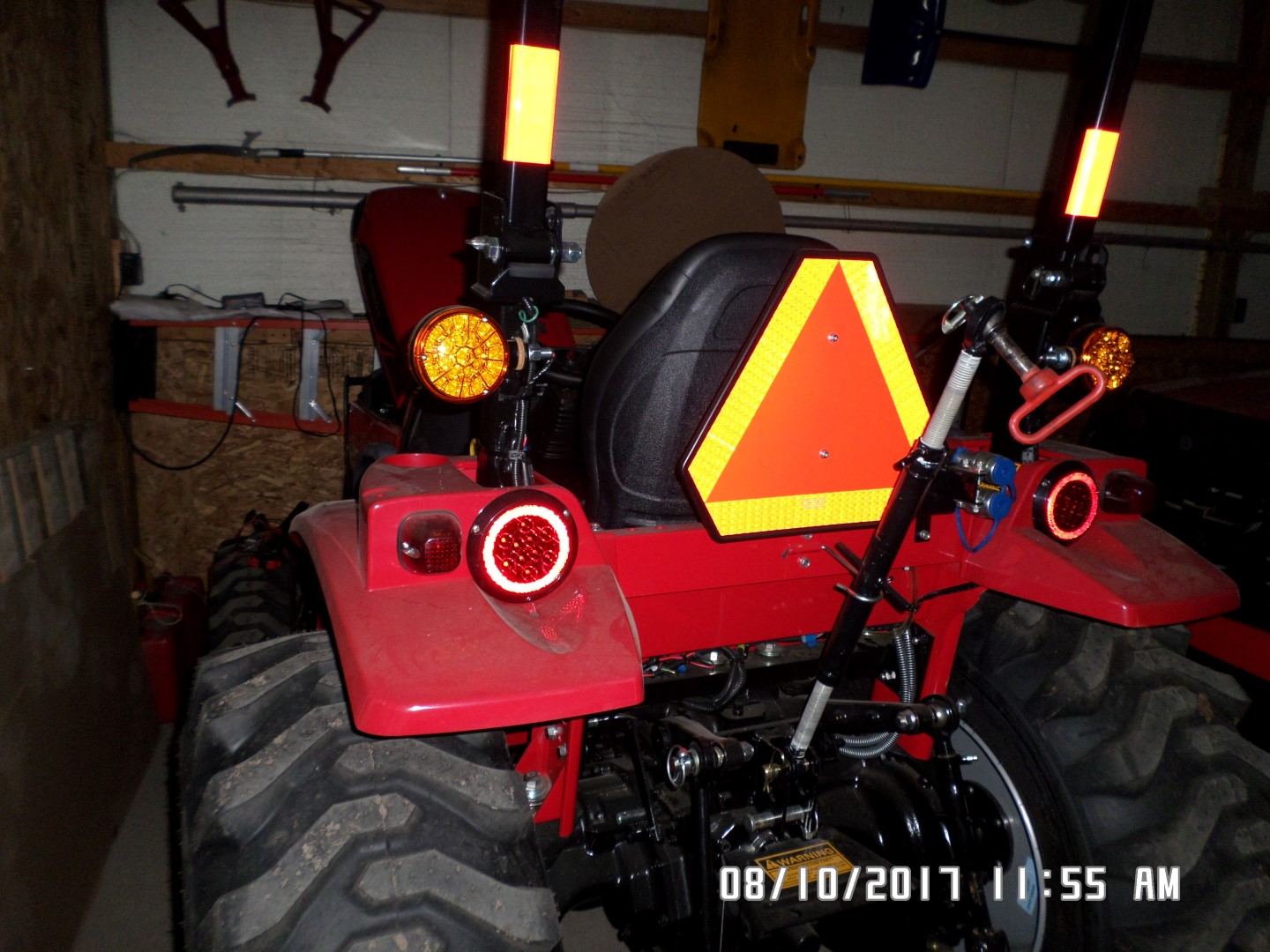

I also replaced the amber rear flashers and added red round flashers to the rear.... again... pimp'n my ride.... The little Mitsubishi tractor has an electronic flasher unit, and works just fine with the small LED load... Along with the 27w work lights and halogen beacon on top of my ROPS.... I plan on scaring any snow that thinks of landing in my area to maybe depart for an easier life......
