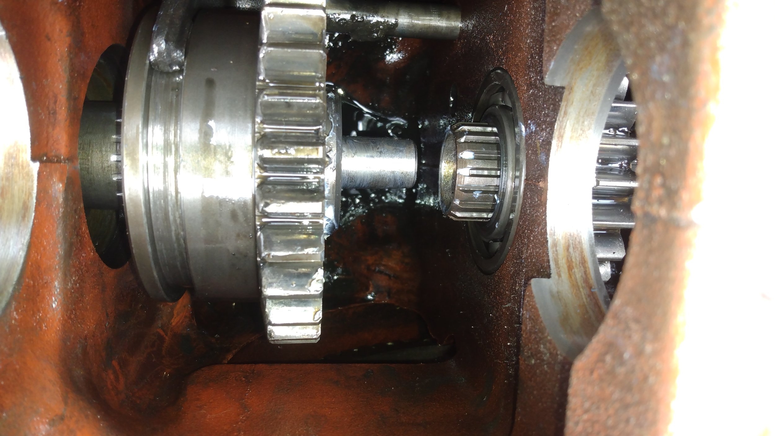

pin bearings for pto shaft Ford model 1910 tractor.Front of pto shaft has a stub which slides into forward shaft.Bearings and race are destroyed,caused shaft retaining snap ring to break.Have removed upper shaft assembly to access pto shaft.Got it back together but after magnetic pickup tool snagged the broken snap ring,realized that the barrel bearings and race had disintegrated.Waiting for caliper tool to arrive today so I can measure diameters.
Where would one find a bearing like this

thank you for your helpful post.I am struggling with locating what appears to be a necessary roller bearing at the front end of the pto shaft.It slops around within the receiving hole on the forward shaft without a bearing.I found numerous "bearing pins" in the bottom of the reservoir so I assumed there must be a bearing assembly required.Your insight is appreciated and welcomed.Thanks,Verne

I was amazed to find the 24mm bearings i was looking for at amazon.Pretty amazing.
   / pin bearings for pto shaft Ford model 1910. Where can it be found? #6
Good luck with that as the quality may be questionable.

you are right about quality.They sent me a pack of five!I guess failure is anticipated.I did get it working except for the pto shaft lever that disconnects the two pto shafts is not releasing into neutral.Oh boy,more open heart surgery.I did get the four acres mowed after attaching the rotary cutter and then starting motor while pto was in drive.Thanks for your reply.
