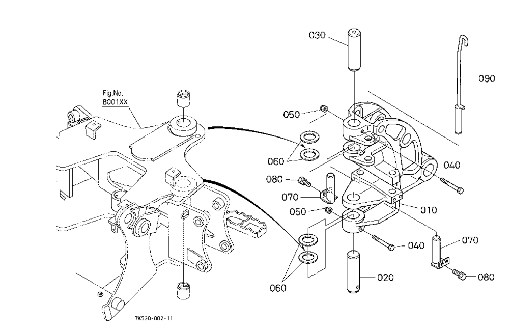

I just bought my first tractor (Kubota L39 TLB) at a Lyon & Son auction and made a mistake. I thought I壇 looked over everything pretty well but missed the pin-hole elongation on the swing frame that the alleged mechanic covered up by welding a large fender washer to the top of the pin and then painting it all Kubota-orange. The manufactured 1-1/4 bored holes (top and bottom) now have nearly a 1-3/4 outside diameter. So now the questions.
Should I cut my losses early and simply purchase a new swing frame and pin roughly a $1000 investment in parts, or do I take the assembly to a machinist to attempt a fix? And, if the latter, should the pin holes first be filled with metal weld and then rebored, probably sized for a sleeve bushing, or do I attempt to cold-weld (JB Weld or metal epoxy) a top and bottom sleeve bushing (1-1/2 OD) or flanged sleeve bushing (again 1-1-2 OD with the flange (1-3/4 OD) being closer in diameter to the elongated holes), or do I have the holes resized for a high load, sealed ball bearing (the one I found has an OD of 2-9/16??
My concern with filling the holes first with metal weld before having them rebored is that the resulting heat may make that area of the frame too brittle and the inherent voids in the weld may compromise the needed strength. My concern with the cold weld options securing sleeve bushings is that the fill won稚 be strong enough for the imparted forces. My concern with making the holes bigger for a ball bearing (or even leaving them the size they are) is losing the meat of the frame and possibly making the whole assembly too weak.
And as a side, what would have caused this in the first place? The other (left) side frame hole and pin look good as new. Why would one side get so buggered up and not the other? Was this likely caused by the original swing frame being defective or is this type of wear to be expected?
Any knowing experience or intelligence would be greatly appreciated.

Proper repair would be to bore to a larger size and bush it with a interference fit bushing. Any proper machine shop will be knowledgeable about this procedure.
That being said welding it up shouldn't cause any of the mentioned problems it is made of a mild carbon steel not any time of high carbon that should be hardened by heat.

Thanks, aarolar. My knowledge of bushings (McMaster-Carr) indicates that the available 1-1/4" ID bushings are all 1-1/2" OD. With the oversized holes now being 1-3/4" OD (roughly), is the correct procedure to put a bushing in a bushing to get to that diameter, or are thicker-walled bushings available, or do I simply leave it up to the machine shop? If possible, I'd like to do this just once and eventually pass on this tractor to someone that doesn't have to worry about this particular issue in the future.
/ Pin Hole Too Big #4
A machine shop can make a bushing in whatever OD and ID is needed. A welder might just cut out the worn out bushing and well in a new bushing. Guys build their own backhoes and buy bushings to be welded so brand new bushings in the correct size are out there.

I would recommend taking it to the machine shop and let them give you repair options and a price to do it. I've repaired a few in my 30 years as a machinist and we always welded them up and rebored to standard, but that was on larger machines and those bores received hardened bushings just like when new. I imagine this did not have bushings? I wouldn't try fitting bearings. Hardened bushings would be a better fix. Very important to keep all those pins and bushings well greased!

Thanks to all. I'll take some drawings to a local machine shop and get an estimate. If it's less then new, we'll put them to work. The holes within the swing frame did not have bushings and the pin is stationary within them. There is a bushing within the swing cylinder's rod knuckle, which is supposed to rotate about the pin, and that seems to be well lubed. Perhaps at some point during its 720 hour life the assembly seized resulting in the damage. I guess it doesn't really matter; however, I'll likely remain annoyed with Ahern Rental for purposely hiding the problem rather than properly addressing it, and not disclosing the issue before they sold the tractor. On the positive side, I'll get to break out the wrenches, get a little dirty, and add to my knowledge of this part of the whole.

Do you have any pictures of the parts needing attention. I have done alot of pin/bushing jobs on sloppy backhoes. But am unfamiliar with the L39 setup. Specifically, are we talking about a small piece that can be taken off and taken in to be machined? or are we taking about practically taking everything apart to get to a sizable 150# chunk of metal?
Pictures would do me wonders.

Attached is a picture of the large fender washer moved just a touch which shows the oversized hole on the swing frame - a block of steel that does weigh roughly 150 lb. Even though I and others exercised the tractor in the rental/auction yard, the washer and pin didn't move enough to show the oversized hole until the first day I started to use it at home.
I'm still in the process of building a rolling cart that'll take the weight of the mainframe and stabilizers along with some supports for the boom/dipperstick/bucket assembly so that once all the pins are removed, I can then get to and remove the swing frame. Someone asked if there was new paint on the tractor, and there was, but there was also new paint on nearly all (all?) of the several hundred pieces of machinery up for sale. In fact, they'd all been pressure washed and buffed up shiny, just so the dents and dings and bent and broken parts would be less distracting. That's all fine and expected, but I am surprised with those that accept that purposeful deceit is part of the game and should be graciously accepted. Too many of us seem to have become callused and complacent toward the wrong side of humanity. A few will not, and if in the future you purchase something that met or exceeded your best expectation, be sure to thank the seller along with those that decided not to get callused but instead got even.

Got a picture of the other side?
Maybe I am seeing it wrong, but if the washer is welded to the pin, and if the pin is the diameter it looks like looking at the top, then that hole looks twice the size that it is supposed to be. Hard to believe there would be THAT much wear. And what I can see of the hole does look round.
Can you take that pin out and get a pic of whats going on?
When you were first describing the issue, I was under the impression that they welded the fender washer to the swing post, basically making the hole smaller to fit the pin again, but not for the whole thickness. Doing that WOULD tighten up the slop, but wouldnt last long as the washer would wear out in no time.
If what you are saying is correct, and welding the washer to the pin only to cover the hole, did NOTHING AT ALL to help, only to cover up a problem. Would be like filling a crack in the boom with bondo and painting over it to make it look like it wasnt cracked. I agree if this is the case, deceitful.
