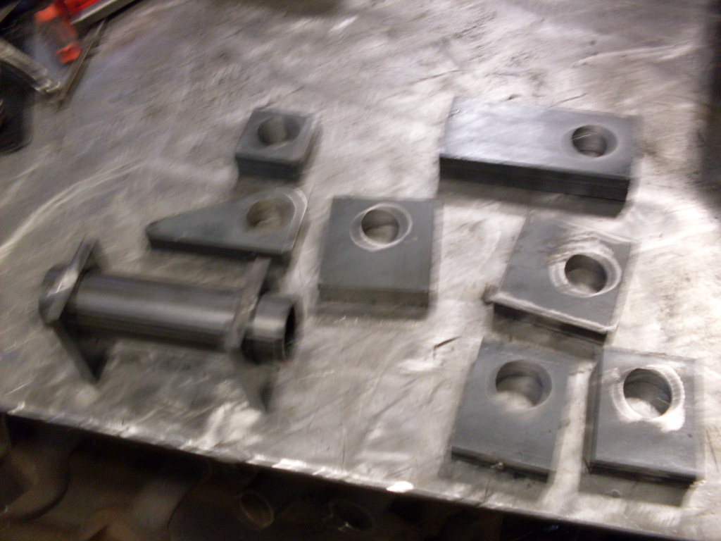

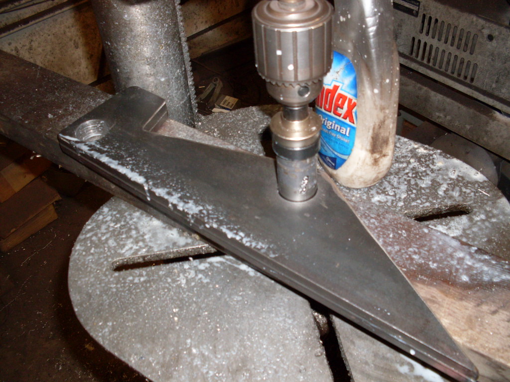

   / Pin Holes and Tubing, Drill bits #15
drilling large diameter holes in steel , is easily done with a hole saw and a generous drenching of water soluable oil , I just finished drilling 20 1.25 holes in 1/2 inch bar for the dump hoist I am building slow speed and be carefull not to let the teeth foul with fillings.
I used the same holesaw for all holes and all 20 took about an hour .
