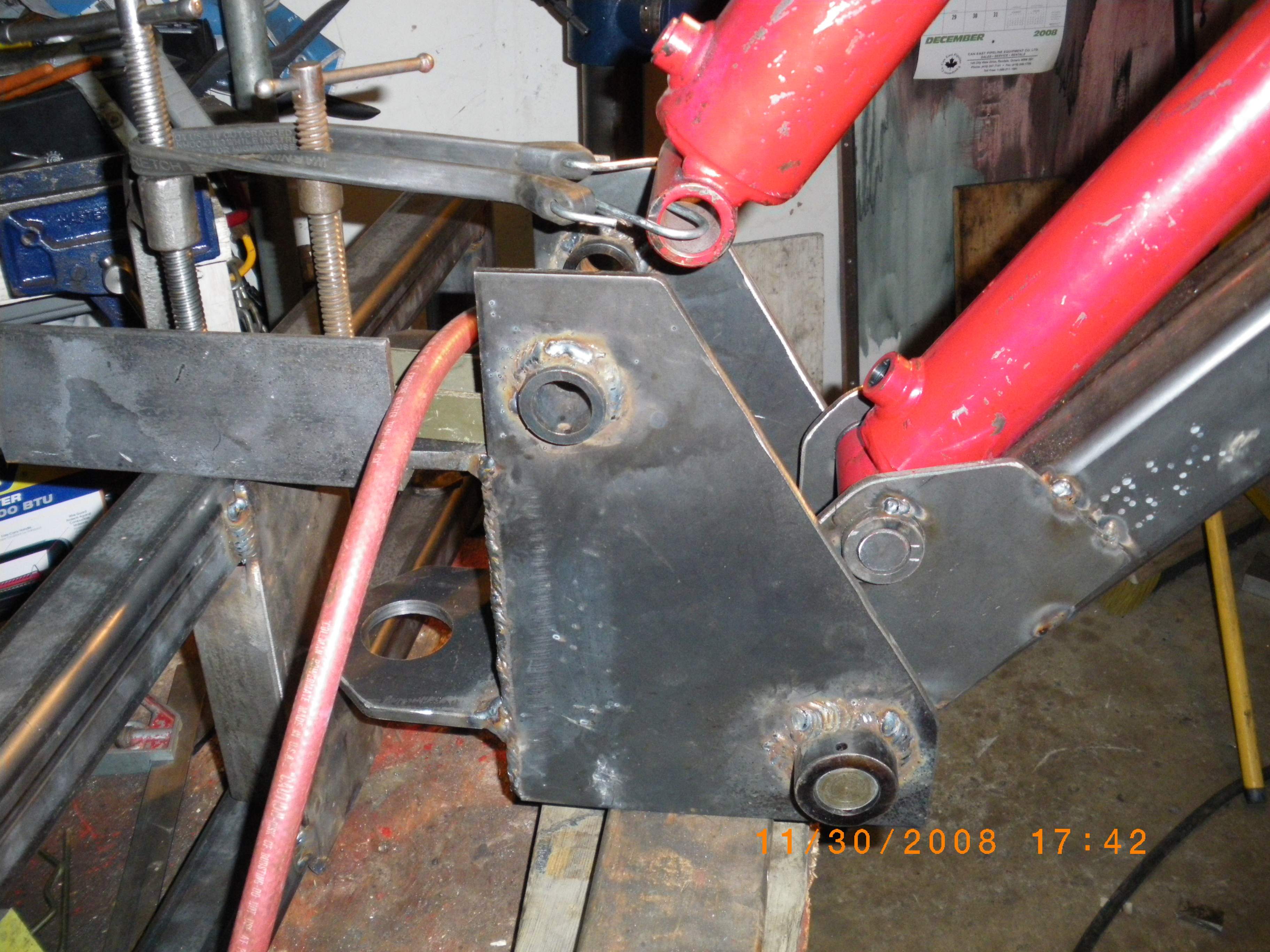

I use Silver and Deming bits for 9/16 to 1 inch holes. You can buy a set for $35 bucks and will need a drill 500 rpm or less. Hold on tight if not using a drill press. For bigger holes I use bimetal holes saws. 500 passwords is a machine and he reamed his tubes because he was pressing in bronze bushings. Myself, I just go to a hydraulics store and buy pins and Cross Tube Cylinder ends. I cut the Cross Tubes to size and weld them. You can also see how I welded in pieces of cut up cross tube. A piece of cross tube for a 1 inch pin requires a 1 1/2 in hole saw.
Your picture is exactly what I was trying to describe. only I was going to face weld a piece maybe 3/4" long. Others have mentioned making the hole big enough for the tube and welding the tube in place.
The more I think about it the more I believe this would be stronger and better/smooth for the pin.

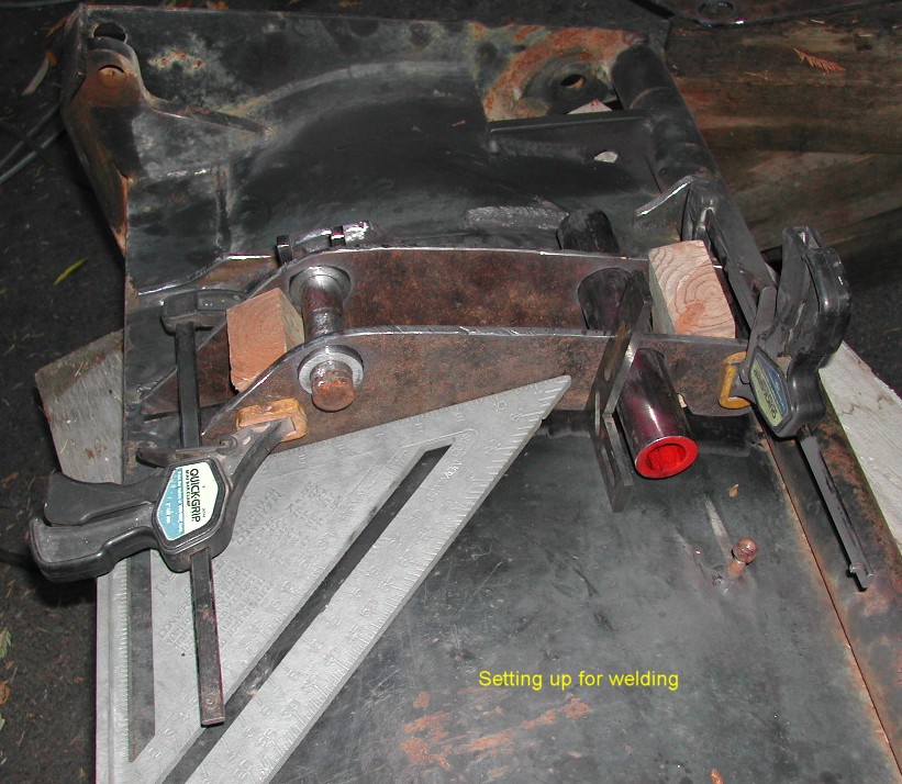

If you cut a sloppy hole with torch or PC, and weld in a chunk of DOM,
there is no drilling at all, and the clearance in the rough-cut hole gives
you room for fine-tuning before welding.
Like this:
