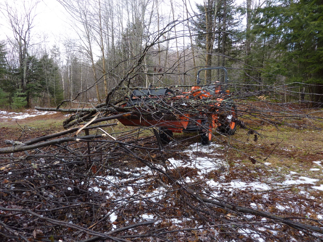

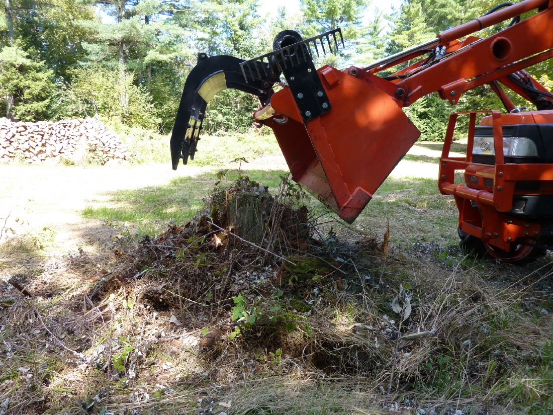

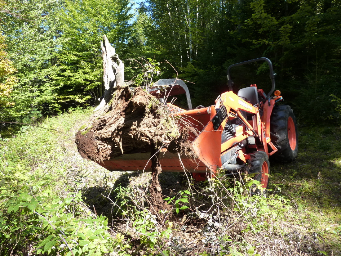

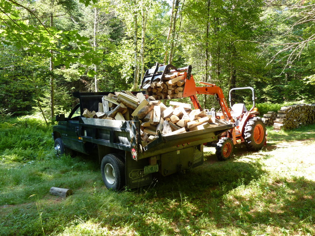

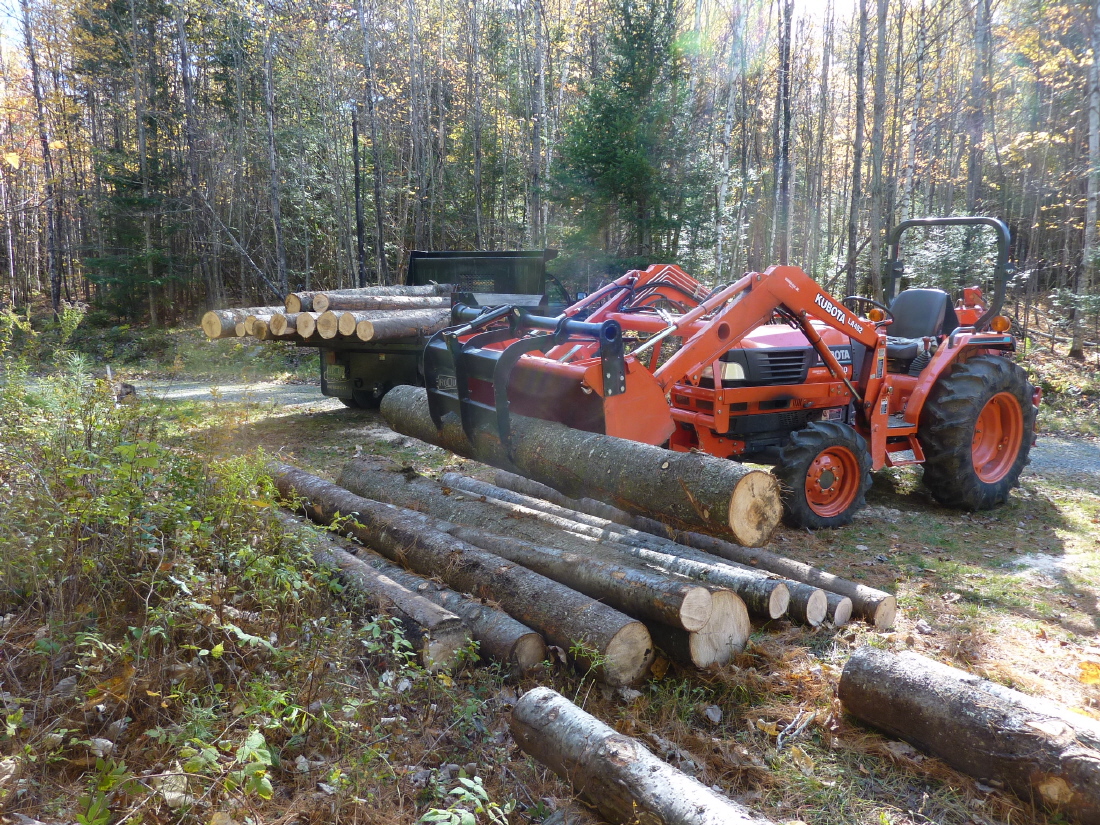

I have an ATI bolt on grapple. Fits a wide range of buckets. My bucket is 5'.
I couldnt make the link to Millonzi work so I dont know exactly what you want. Maybe something like the ATI will work for you.

It does. It is not as good as a dedicated unit but for me it was a good trade with my semi-perminent mount bucket. I did add some teeth to the grapple fingers to give it more bite. I cut some short pieces of 1/2" rebar and welded them on. You can see them in this picture I think.

I am sure the bolt on grapple has some uses and can be helpful but it in no way can do what a dedicated grapple can do, so it's not really comparing apples to apples. I use my grapple first and foremost in clearing land, ripping out small trees and saplings by uprooting them. There is no way I could do that with a bolt on. It just depends on what useage you need. ( I am not cutting down the bolt on as I am sure it works well for picking things up like those logs)

It is hard to see. But it is no different than using the cutting edge of your bucket which you cant see either. After a while you get a feel for it and just know what angle and height your bucket has to be in to do what you want. Like I said, it is a trade off you have to make. It is plenty strong though. One of the big plusses for me is that I can go out to work and use either the bucket or grapple, switching back and forth as necessary. I have them both there and ready all the time.
