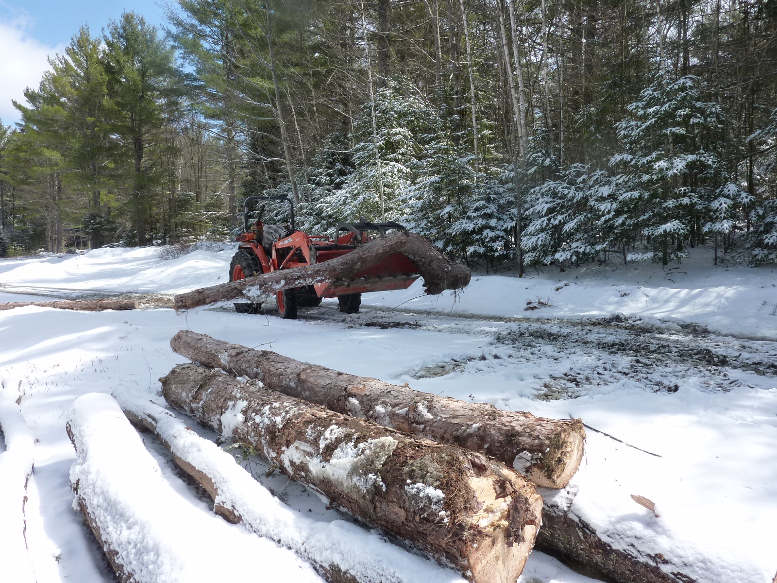

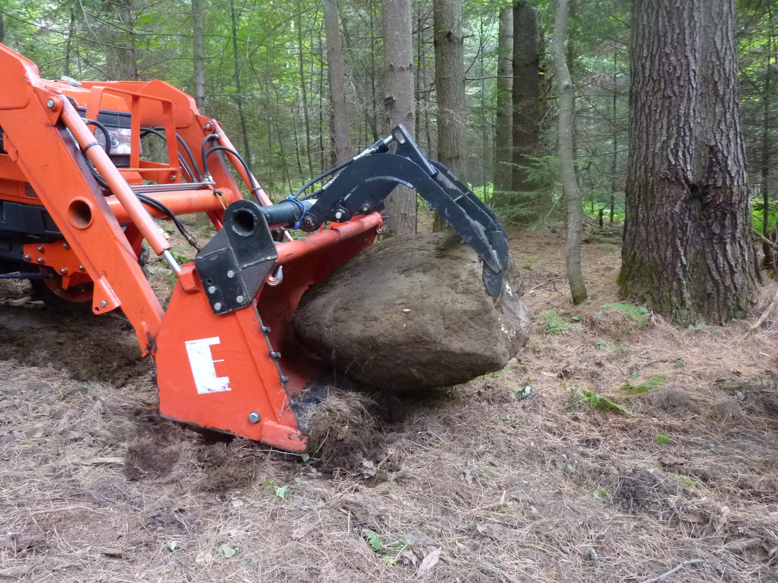

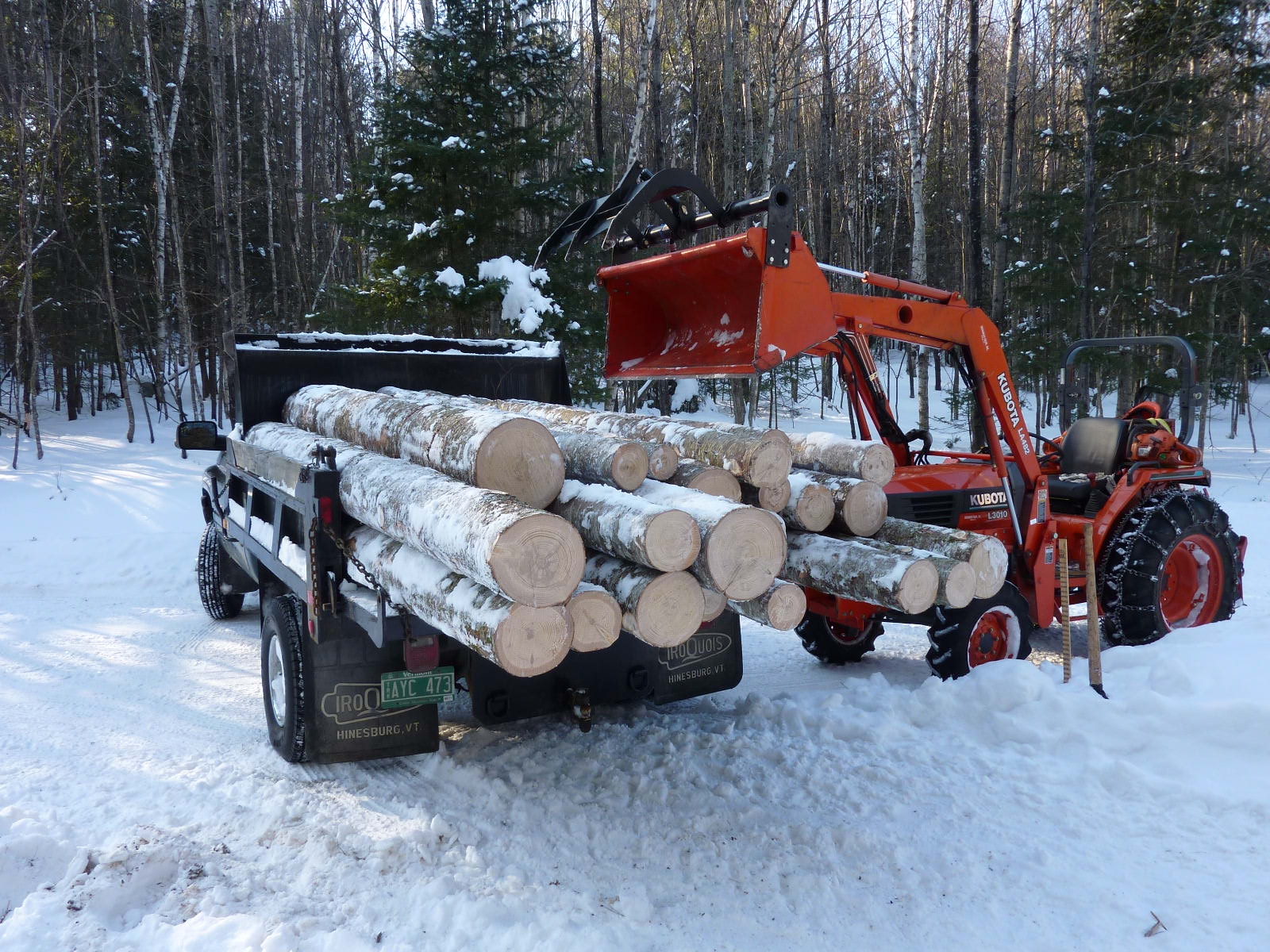

Have you thought of going this route?? There isn't much I can't do with this set-up. <img src="http://www.tractorbynet.com/forums/files/attachments/436868-pin-grapple-p1110083-jpg"/> gg
That is definitely better than no grapple, but your lift capacity is seriously reduced moving logs.
Well my 60" bucket plus the grapple weigh less than 400 lbs. So it is the same as a 60" EA wicked root grapple. When I grab a log I pick it up with the curl which is strong. It rolls the log back so it is almost over the pins and not way forward.
So maybe my capability isn't reduced quite as much as you might think ?? Regardless, it picks up what I need it to. I have never left a log on the landing because I couldn't load it
For a 30 hp tractor I think I do OK. My equipment seems to be well matched for what I do.
To me having the bucket and grapple always available is really handy. I would not consider a pin on grapple. But that is just me.

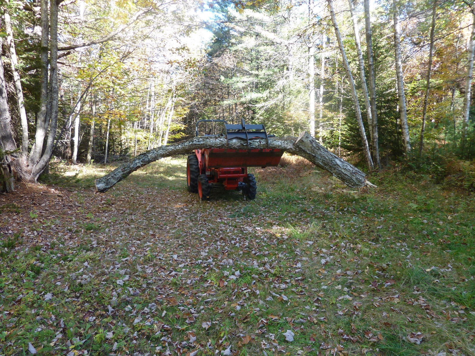

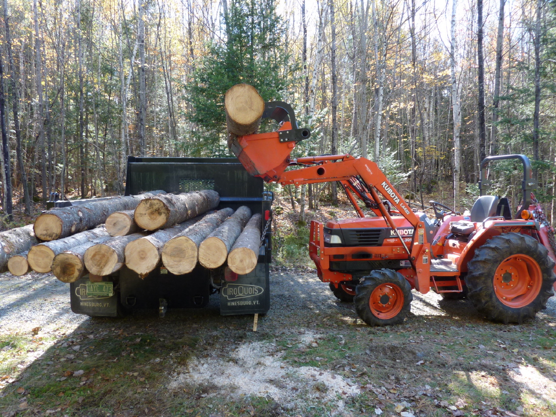

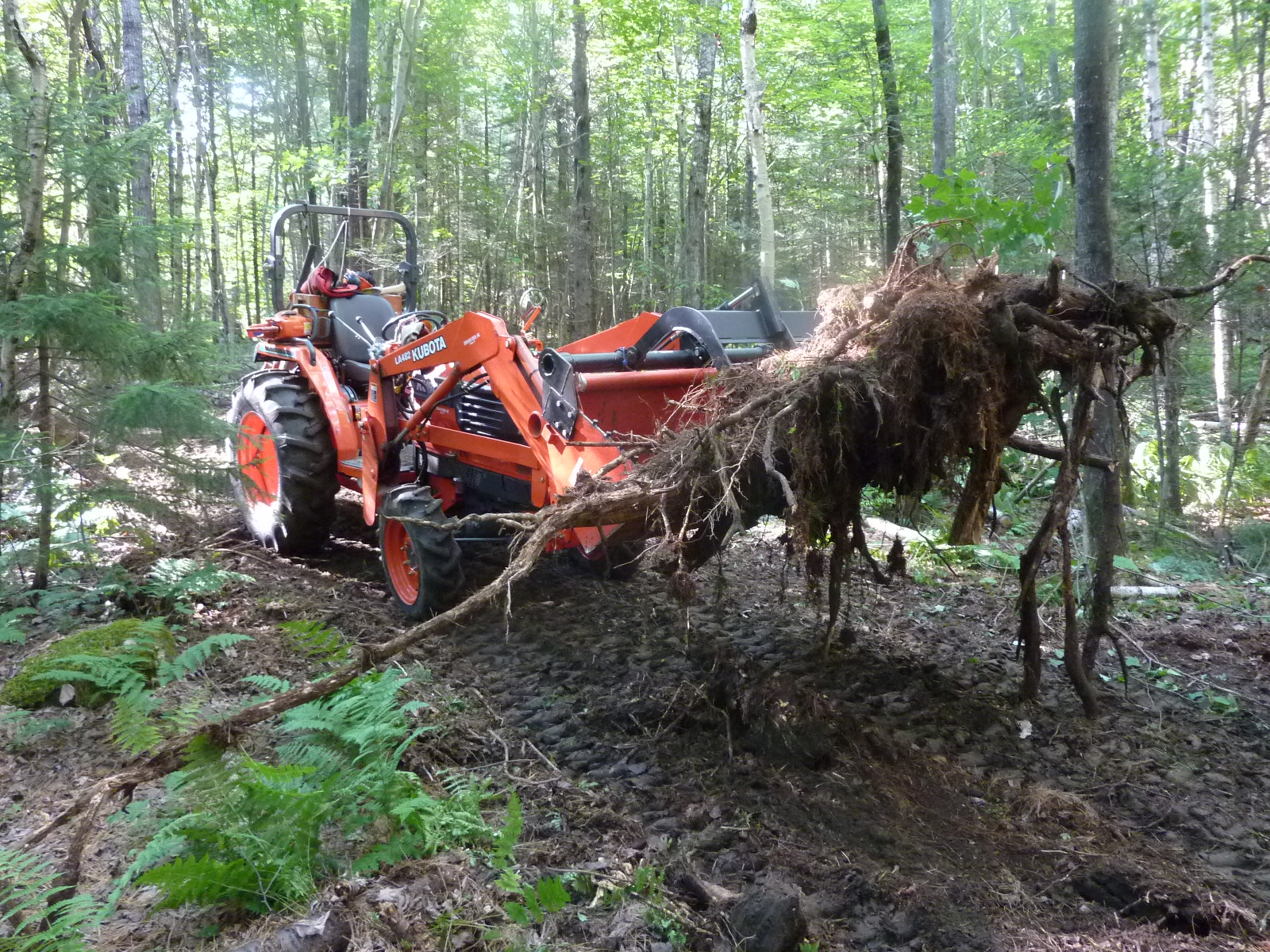

While I am here boasting about my grapple I would like to dispel another myth about single activated or single lid grapples. I have heard over and over that crooked logs are a huge problem and you need a two lid grapple to handle them. From my experience that is not at all true. I do not find strongly tapered or crooked logs a problem at all.
gg
   / Pin on Grapple? #17
While I am here boasting about my grapple I would like to dispel another myth about single activated or single lid grapples. I have heard over and over that crooked logs are a huge problem and you need a two lid grapple to handle them. From my experience that is not at all true. I do not find strongly tapered or crooked logs a problem at all. <img src="http://www.tractorbynet.com/forums/files/attachments/437398-pin-grapple-redpine5-jpg"/> <img src="http://www.tractorbynet.com/forums/files/attachments/437401-pin-grapple-grapplelog-jpg"/> gg
Yep. It is amazing that humans can also pick up irregularly shaped objects when then only have one thumb. Simply amazing.
