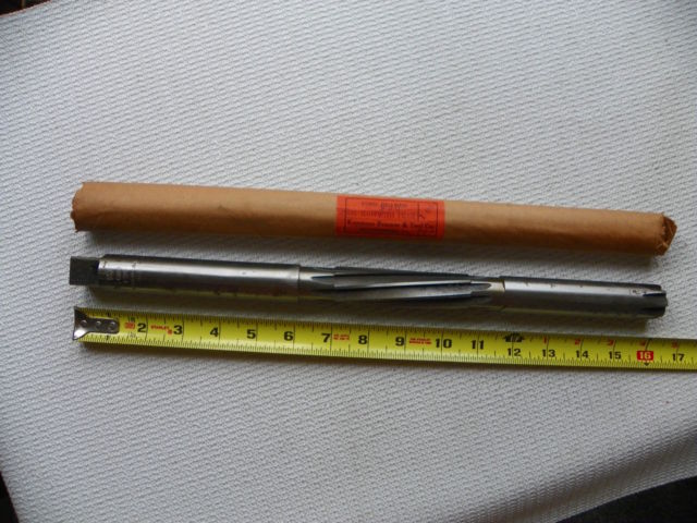

Ah, some more answers, bring them on. I have a leftover piece of DOM that I just measured. Turns out that its actually 0.995in on the inside and the pins are dead on 1.000in. I think that JMC is correct that I really dont need to ream through 3 pieces at once, just the outside ones. The idea of the shim stock and/or welding a length of bushing/DOM and then cutting out the center section are 2 more conciderations. Now about the "stress-proof" pin stock? I haven't heard of that before and will have to check around on that. I do have a old Sears (Atlas) 12x24 lathe to make pins with if need be. I found an interesting reamer today that measures 1.004in and is used for Ford king pins. The reamer section of it is pretty much in the center with with a nice straight section on both sides of it. Im waiting for a responce from him with more info. I'll let you guys know what I found out.

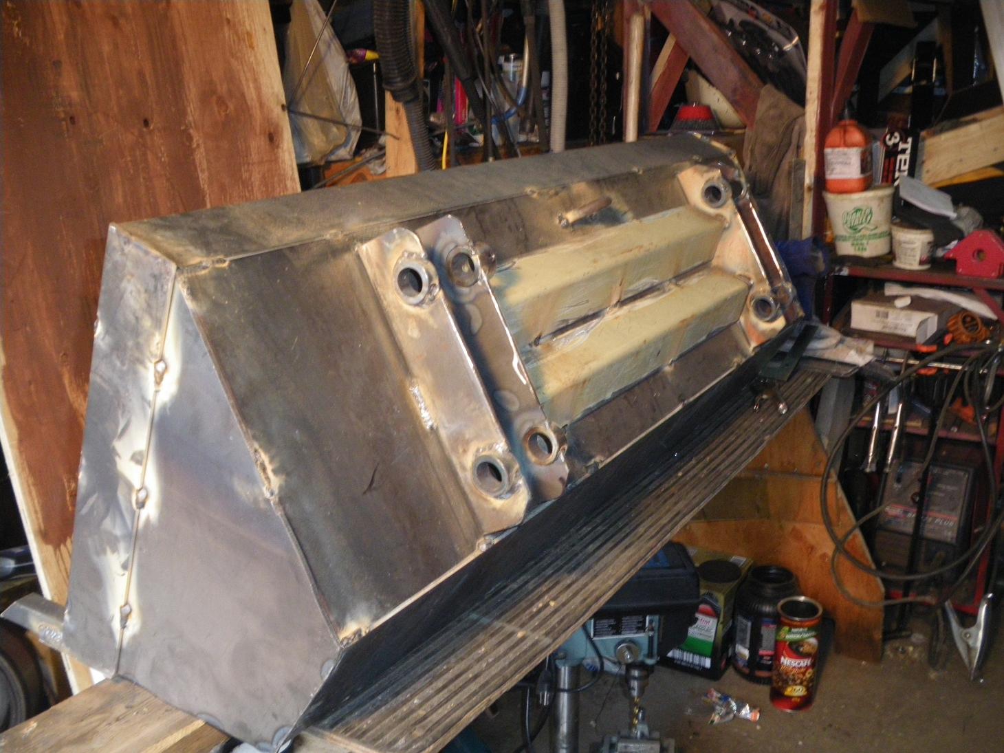

I have built a loader and a backhoe. I go to my local hydraulics place and buy their Pins and Cross tubes. One inch pins fit fine. It might be a little more expensive then just a piece of DOM tubing but by the time you buy a reamer you will not be further ahead. If buying DOM tubing is the route you want to take, why not buy much larger and add brass bushing. Here is a picture of a bucket I am making. I used one inch cross tubes cut down as needed.
   / Pin to bushing clearance? #18
I will also add that I have never noticed the effects of tube warpage and they glow red when I am welding them. Pins continue to slide easily. Just remember to have a pin handy so that everything is lined up before welding.
   / Pin to bushing clearance? #19
Note, 4.5 inch long, 1 inch ID cross tube cost $7.99 so I used less then $16 on my bucket, so you will not be saving much using DOM tubing and reaming it.
