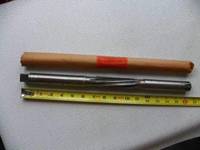

#29
As per David's suggestion, I went to the hydraulic shop to check out cross tubes. They didnt have anything in stock so I ordered 2 pieces of 1"id and 1 piece of 1-1/4id. I hit the poor guy right at closing time so I didnt ask him prices and told him to just put them on his next stock order and not to special order them. I didnt figure that these will put me in the poor house (I'm already there)and they will get used. ThomasH suggested McMaster Carr and had to Google them as I never heard of them. He is right, they have a bunch of odd size tubing and if I ever have to have a long piece to cut up then this is the way to go. McMaster Carr also has that same oddball tubing that I have which measures .995id. I didnt measure this stuff when I bought it and assumed that it was 1" id which is also why my 1"pins didnt fit and I had to burr bit the stuff. I still have a little bit of the tubing left and want to be able to use it and searched around for reamers and found one on ebay for $29.99. This is a Ford kingpin reamer and measures 1.004 so in theory it should work just fine. This reamer is NIB and is old stock. I checked around and to buy one of these new and fresh will set a person back about $100.00 bucks or more so therefore not worth it to have sitting in the tool box. Thanks for all the answers.
Steve
