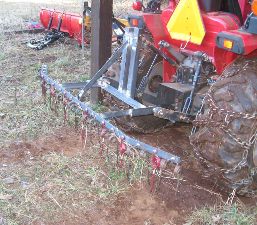

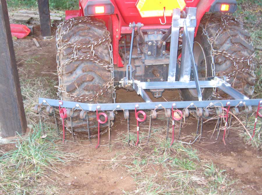

I wanted a way to rake up pine needles and saw the commercially available units that are for sale, They looked nice but the least expensive one would cost $350 shipped to California. So I looked at one others had made and came up with my own design. It seems to work well. I first tried it with 18 sets of the red single tines in place and it worked just OK, then I remembered we had an old hay rake in the back part of the property. The rake teeth on it had double tines and are made of thicker metal so I replaced half the teeth with these and it works way better now. My total cost was about $80 so I'm happy
Thanks for looking
Tom

Nice job.
How often do you have to rake the needles?
   / Pine needle rake
Around the house I rake up needles a couple of times in the fall and then once in the spring. out further maybe once a year.
