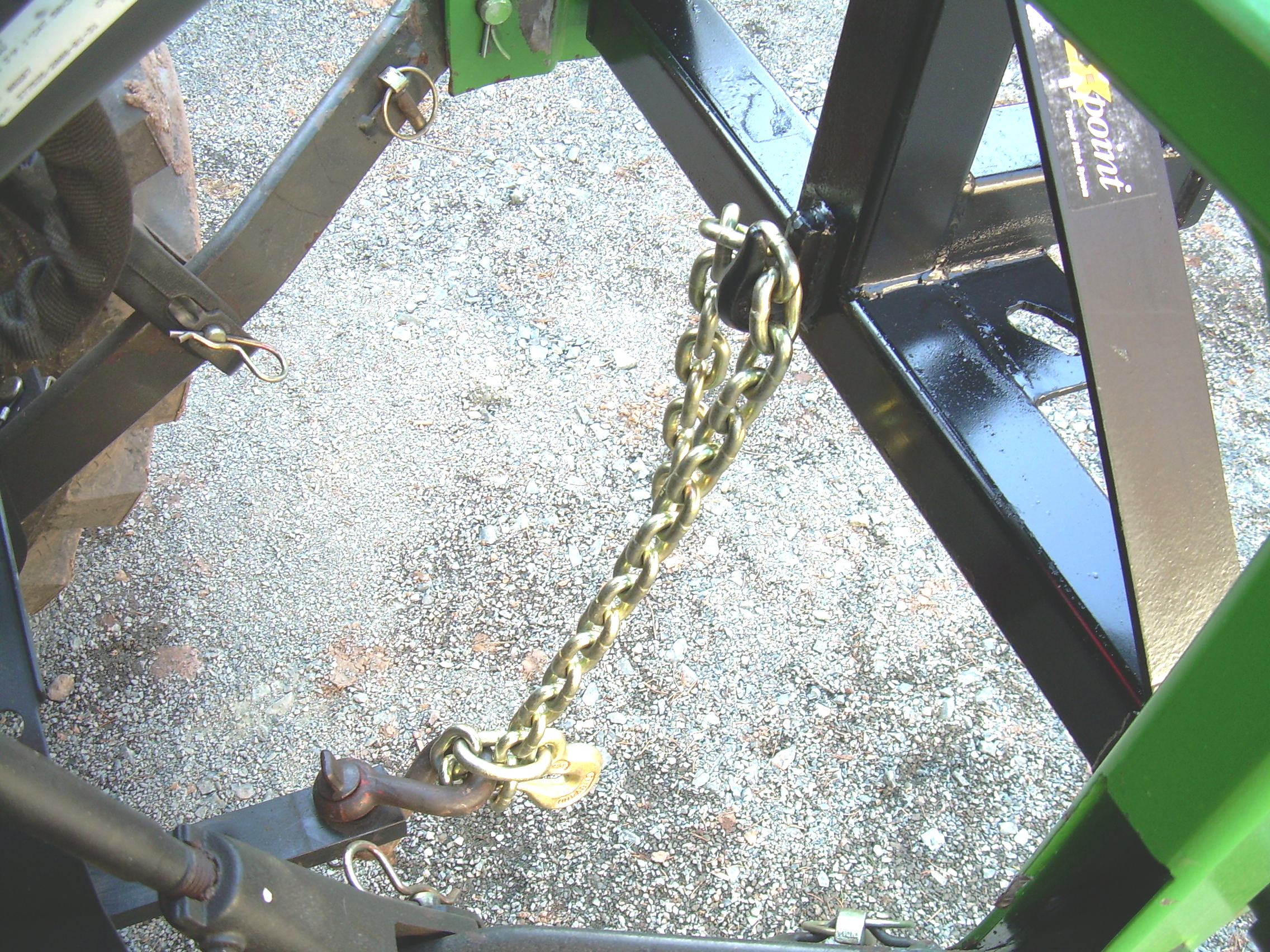

So go to a 2" receiver on your 3pth, but RAISE the hitch before you start to dump. Once its up, won't go any farther without lifting the tractor....
Eh, _some_ tractors have more free play to flop higher than what they lift, really mosy I'm familiar with do that but my experience is with bigger ag tractors. I'd be careful with this plan....
You can chain the 3pt hitch to the regular drawbar to limit it's upward movement.
Any which way, plan it out, think it through, don't assume.

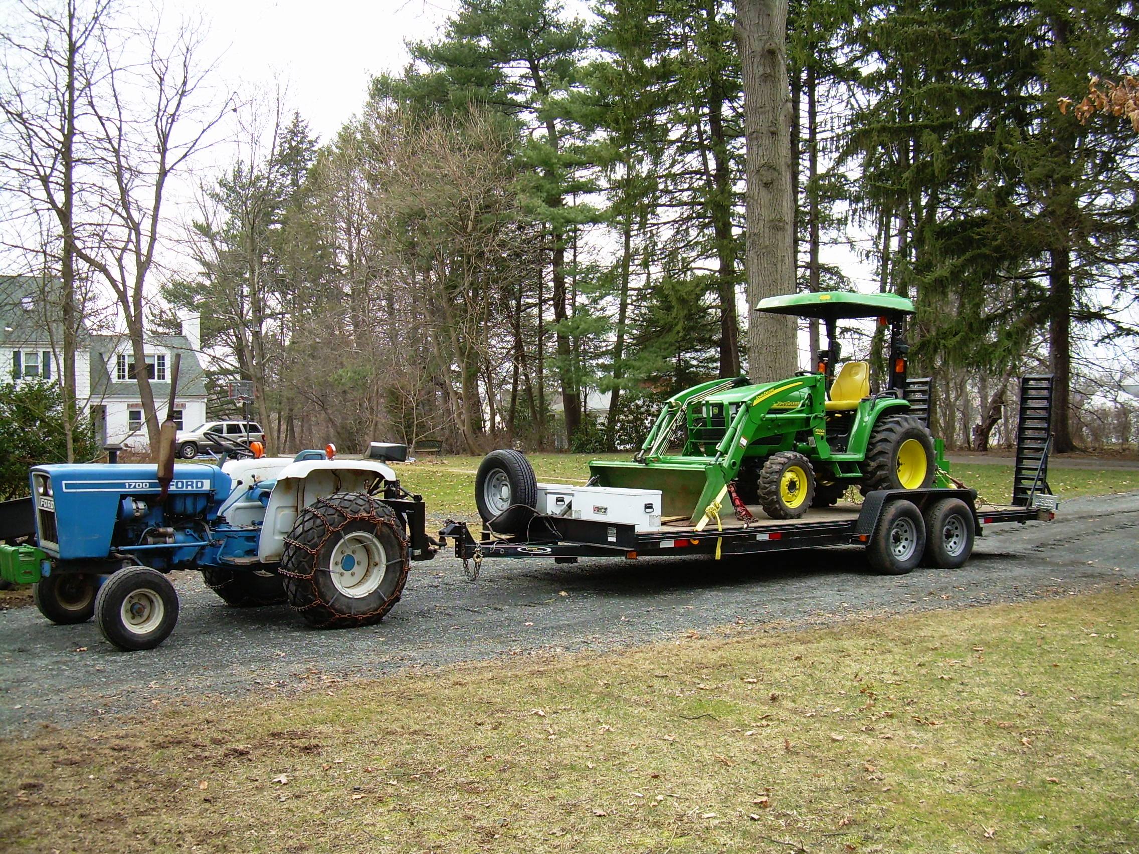

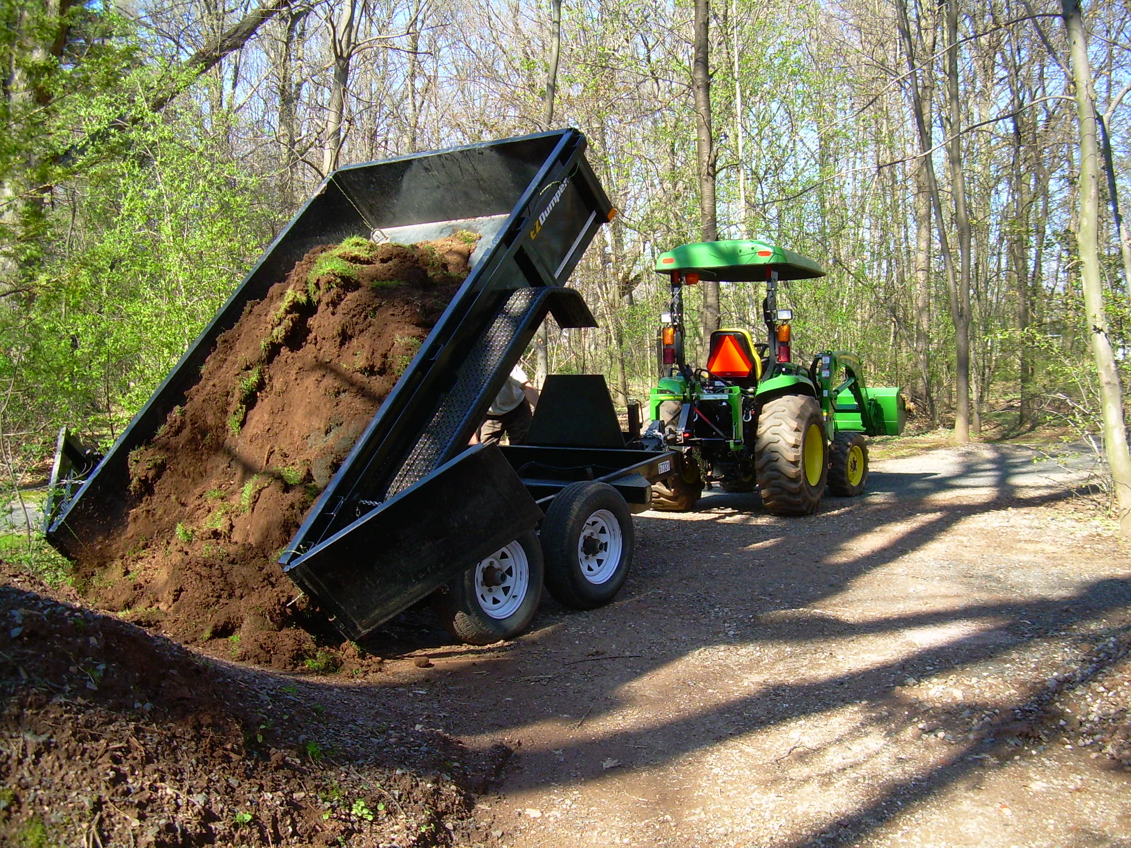

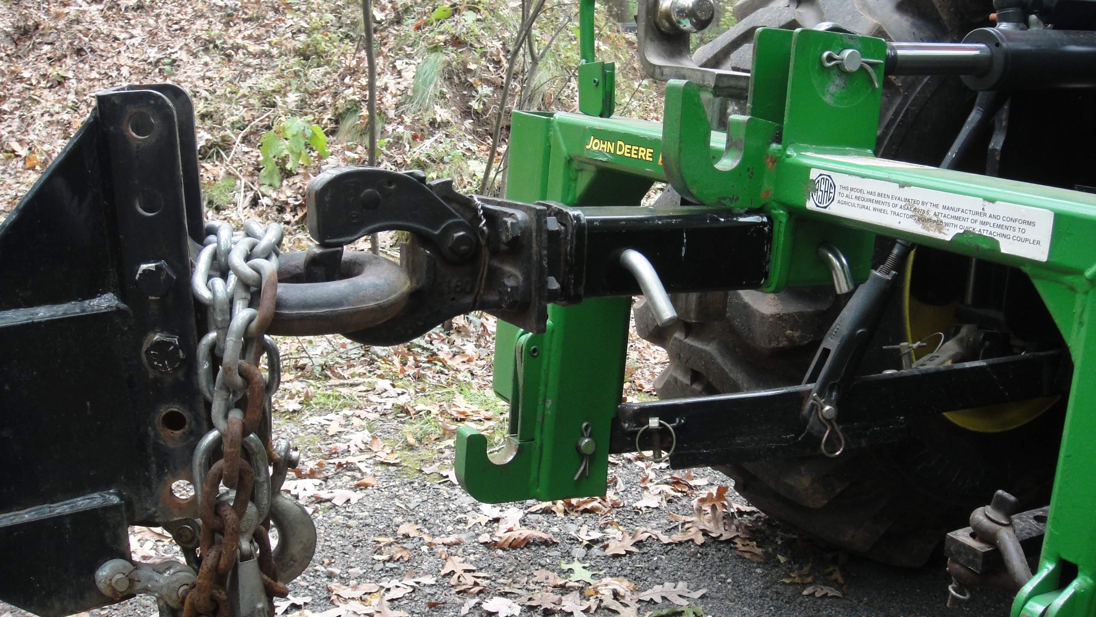

You would have to make a clevis fork permanently installed on the pintle eye to use with the draw bar.
But why????
Use your 3 pt as has been suggested, attach a chain from the trailer mover to your draw bar to stop uncontrolled 3 pt rise due to negative tongue weight.
I have a 5 ton dump trailer, and it works great. couple the trailer with out getting off the seat.
So much easier, and much more versatile and stronger. Do yourself a favor and forget about the draw bar. use the pintle eye the way it's supposed to be used
JB

edit: watch the tongue on the tires as your tractor can most certainly turn tighter than a truck towing the trailer. one of the fellas i work with found out the hard way when he took off part of some lugs.

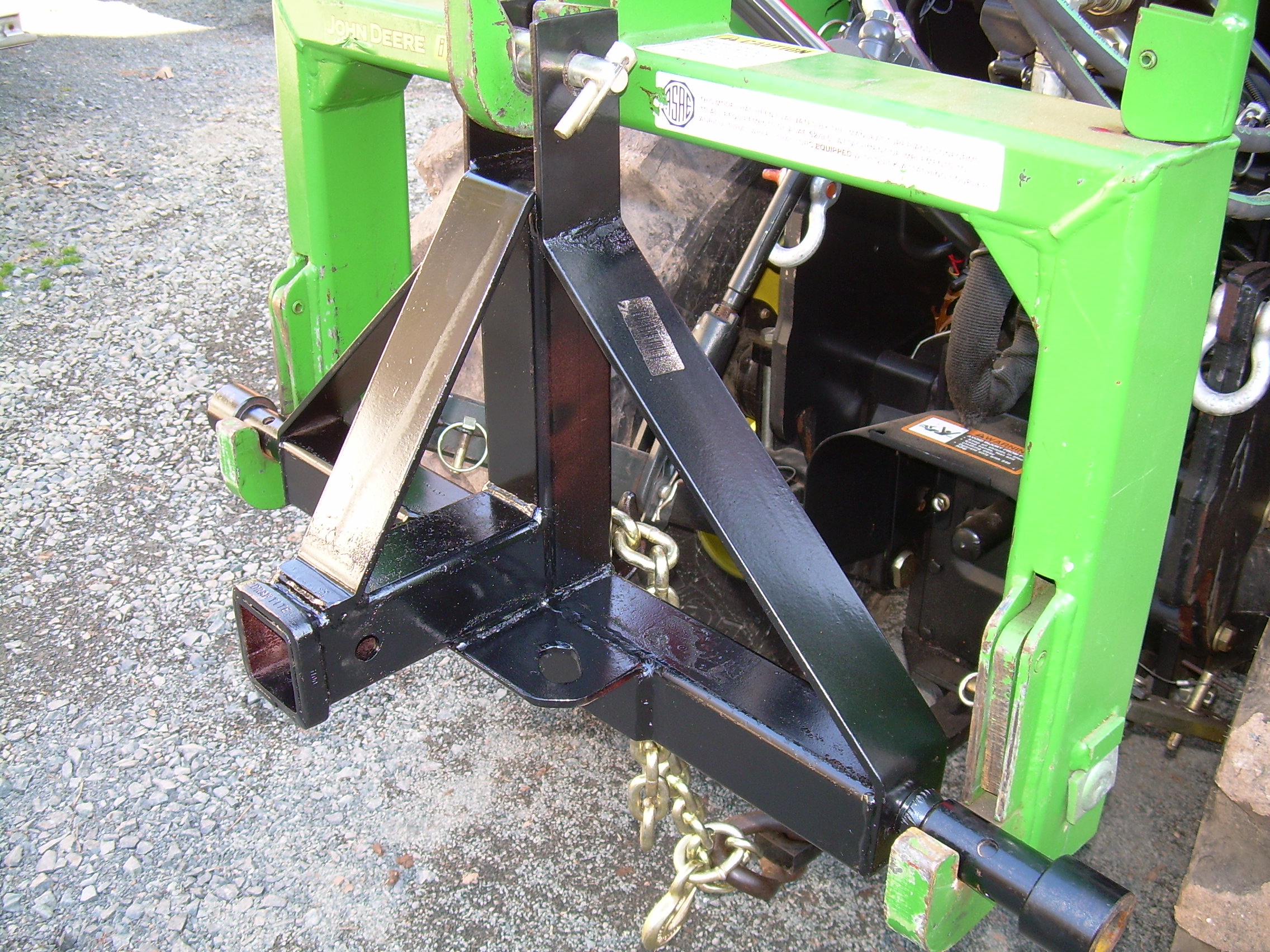

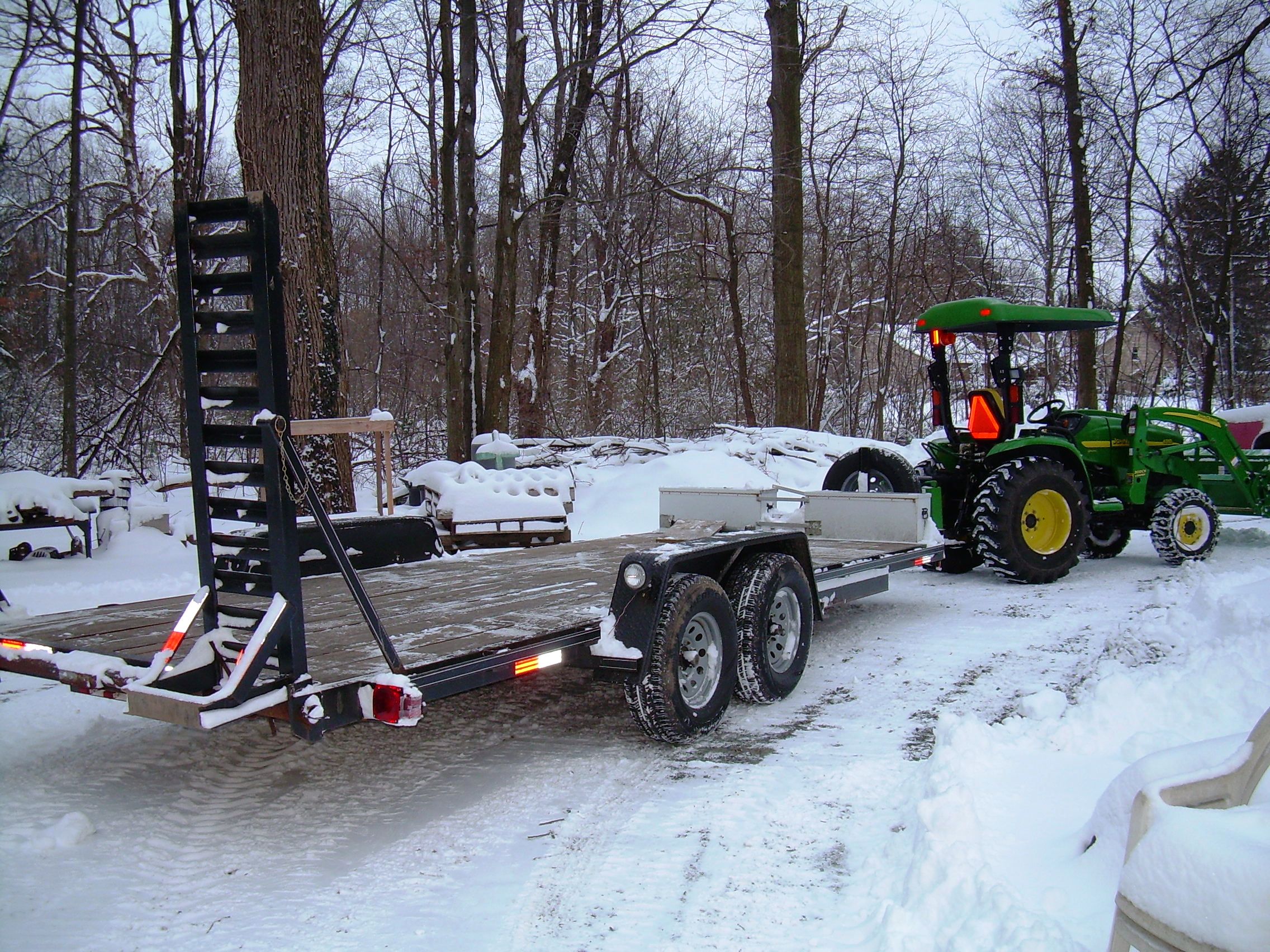

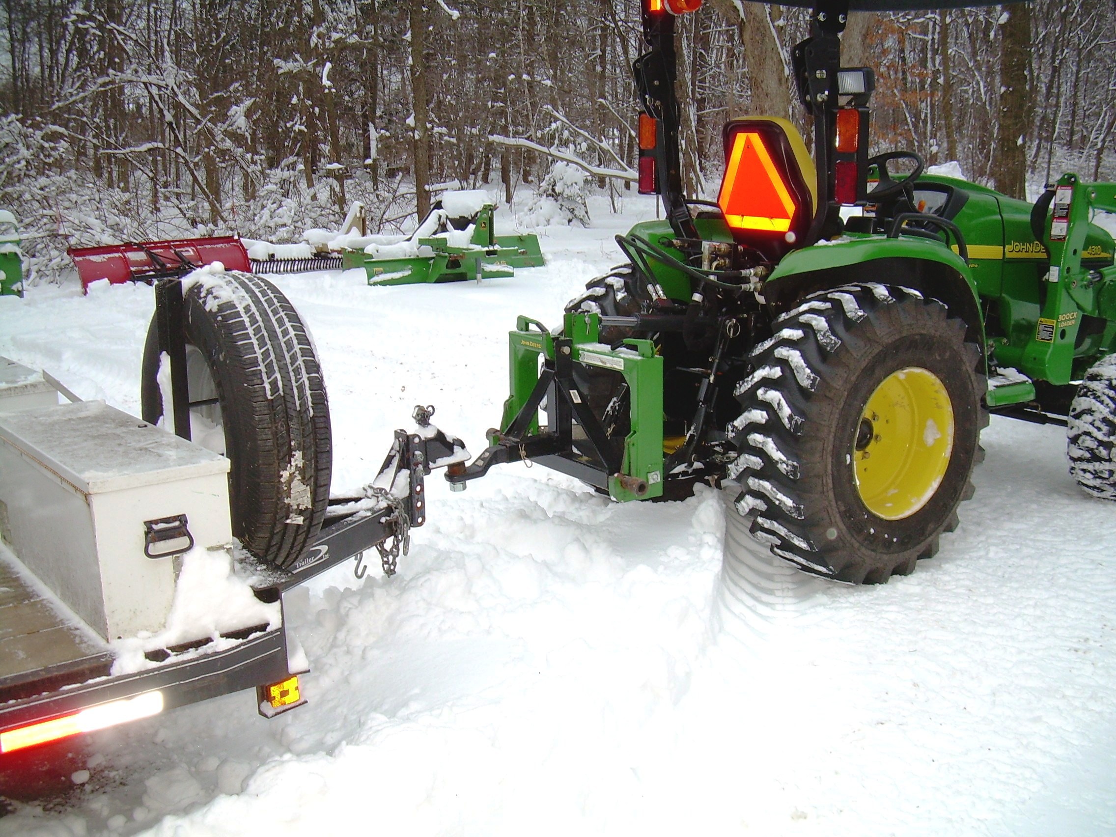

Another good reason to use the 3pt for trailer moving. plus the draw bar is too low for most trailers and a lot of other reasons.
Sorry if I sound so opinionated, I don't usually do that but that's how much I like using the three point hitch for trailer jockeying. 3pt hitch and trailer hitch is like a match made in heaven!

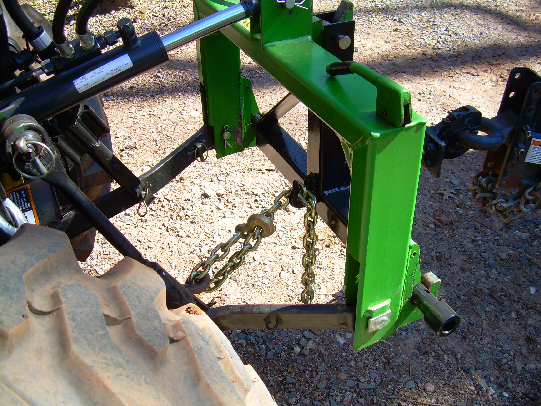

I use mine so much I eliminated the middle man (3pt hitch adaptor) and just installed the receiver tube right on my Imatch quick hitch, also on my HF QH.
