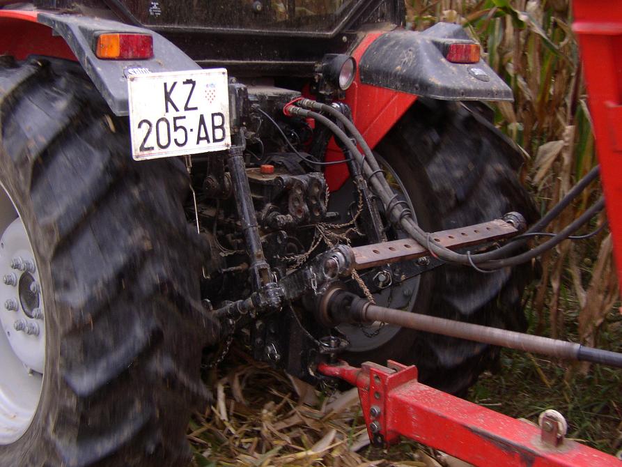

If I can admit from other side of pond; on this way is coupled 90% of ag trailors here. Ball is used only for car pulled trailors, up to 2-3 tonnes gross.
On attached picture are couplings on tractor for high and low attaching single or 2 axles trailors.

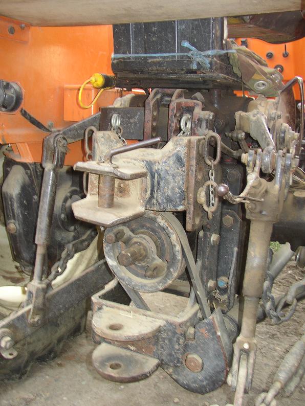

Another example. It can be attacher high or low, as on pic (I havent picture of high attachment).

Hmmm. There is no safety shroud on that PTO shaft, yet you are required to display a license plate? Your authorities have somewhat different rules than ours, it seems.
SnowRidge
/ Pintle ring type trailer #24
This WAS my only PTO shaft without shroud, because I didn't have time to rebuilt it before picking season. Now it is on /forums/images/graemlins/laugh.gif
We need to have registration plate here (only one, usually on rear side), and full signalisation like on cars, if tractor need to be on road, and all tractors are. Police punish very hard if they catch you without registration (about 250$ !!!). /forums/images/graemlins/mad.gif /forums/images/graemlins/mad.gif
Need to have done tech inspection every year, and payed liability insurance, similar as for car, just cheaper a little. Our tractors are used a lot for transport and hauling loads, as we don't use PU's here. Of course, trailors and attachments need to have lights, stop and direction lights, too. Just nobody ask for their registration (yet). /forums/images/graemlins/grin.gif
