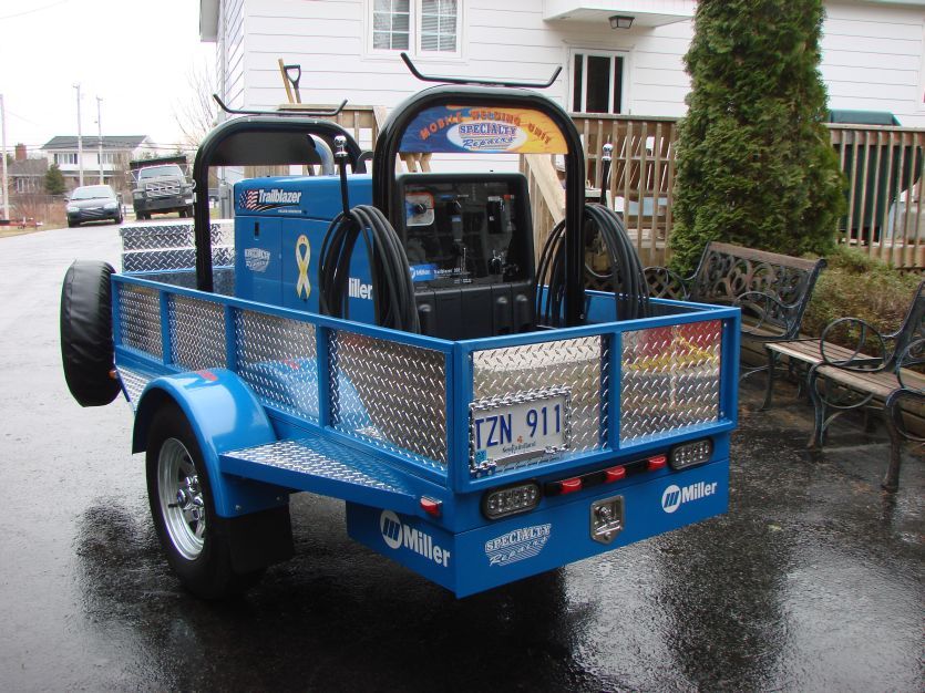

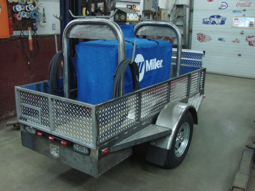

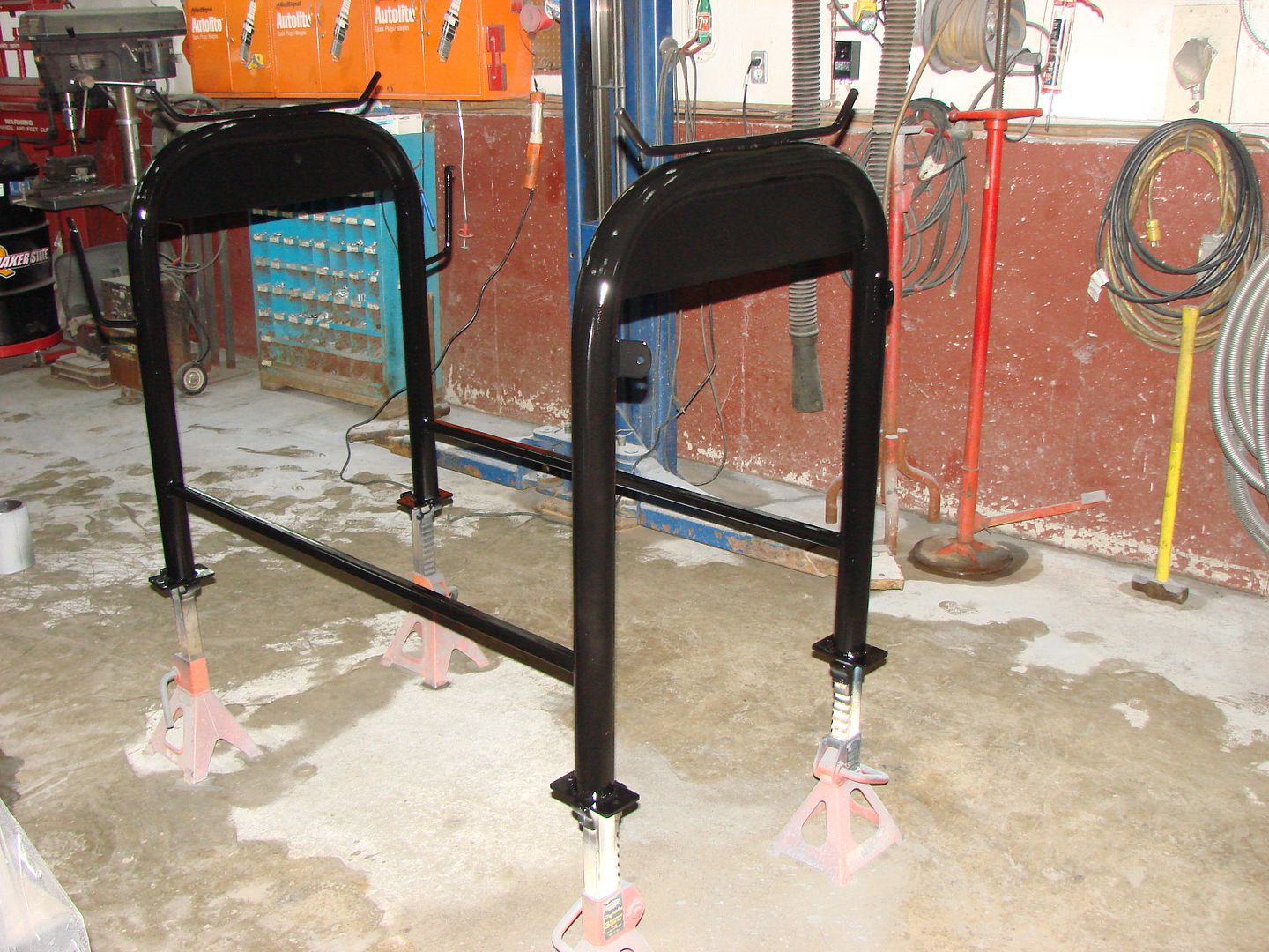

Nice, trailer, roll cage aand welder!!! Not to mention the shop! :licking:
Thanks. It took me a month to build that after hours but its been great. Here's a vid of the build. The shop is getting an expansion next summer but its comfortable and warm. I like warm :laughing:
welding trailer - YouTube

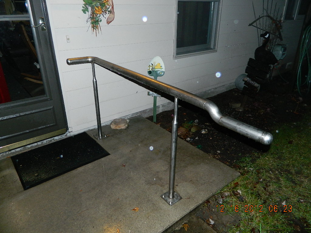

2 inch sch 40 buildin a heavy duty push bar for my 16 year old son . On a old blazer
If in fact he has plans on pushing or there it a likelyhood of some light pushing scrap the idea about sched. 40 and use sched. 80.
The heavier and larger diameter the larger the radius of bends also.
Not sure what you want it to look like.
For the grapple bar support on my bucket I used sched. 80
you can buy weldable caps, tee's, 90's... also check ebay for maybe for lower prices
Square tube might be another option.

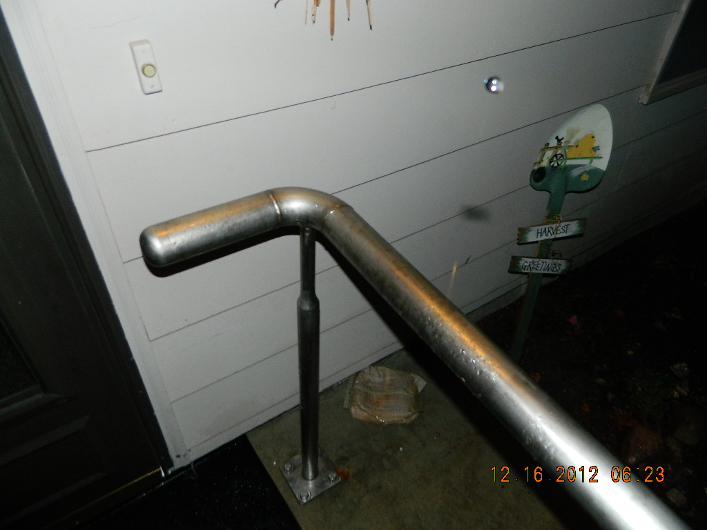

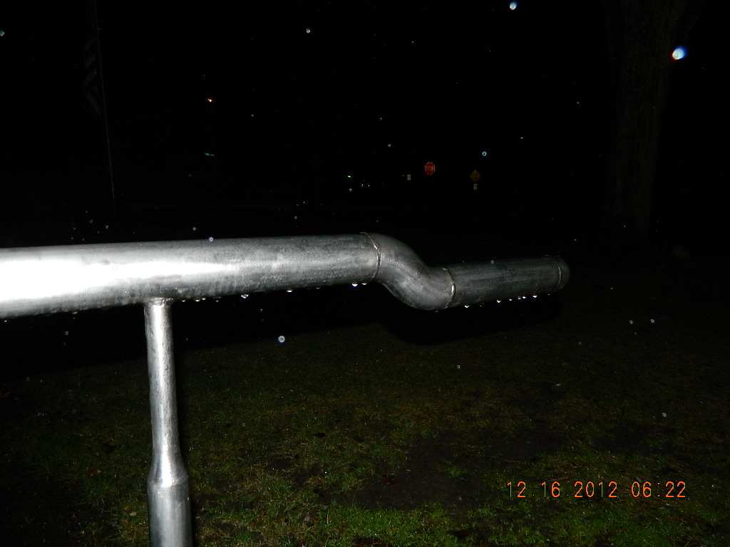

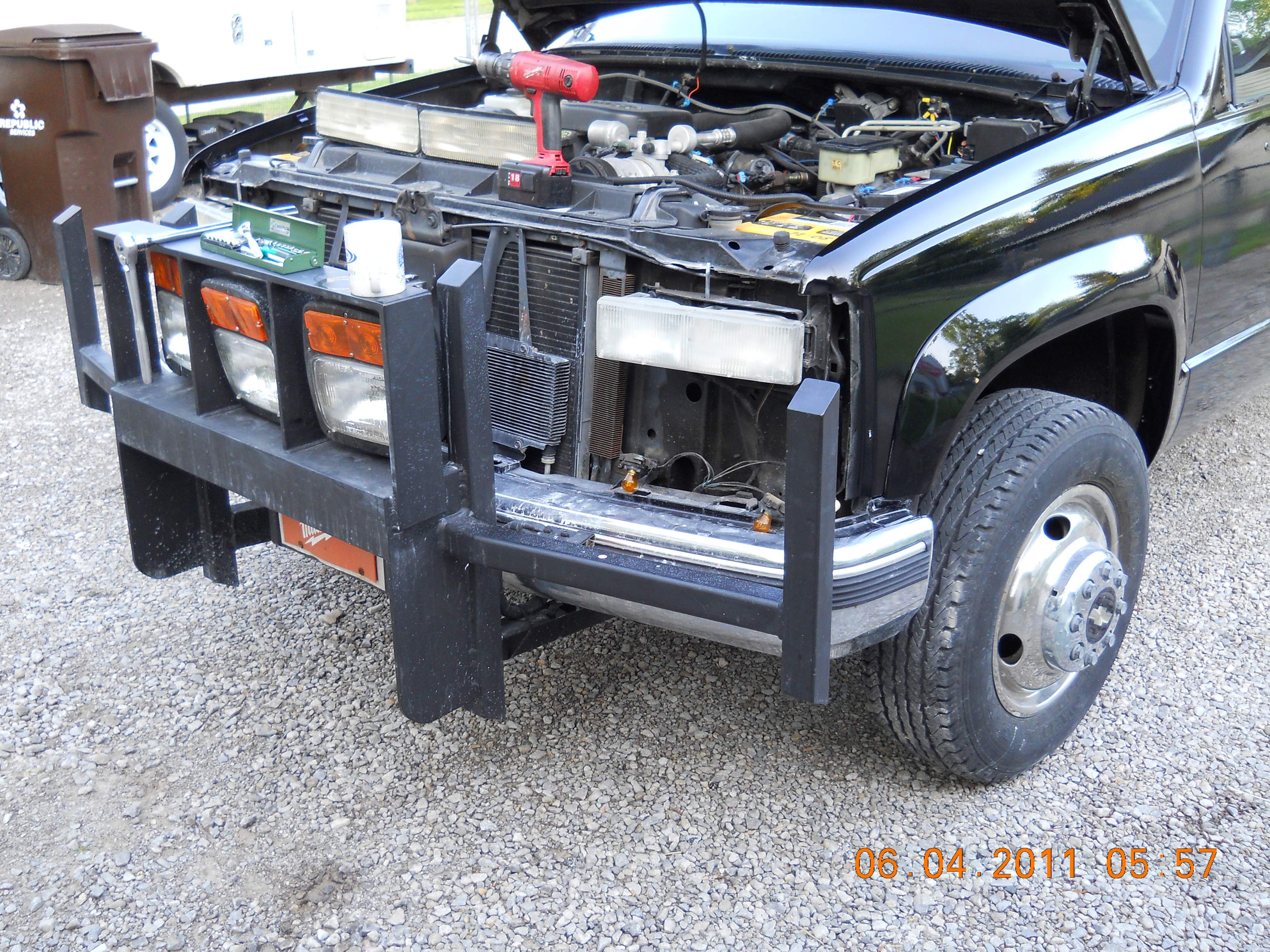

new tractor 475.JPG2011 CHEVY TRUCK PAINT 017.jpg2011 CHEVY TRUCK PAINT 129.jpg2011 CHEVY TRUCK PAINT 130.jpgHandrail 001.JPGHandrail 002.JPGHandrail 004.JPG
