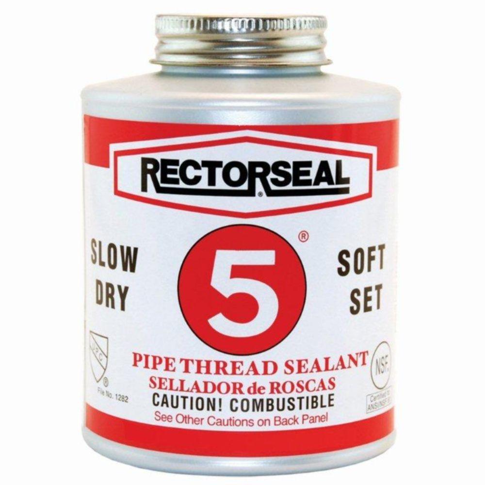

For NPT air water fuel (non hydraulic) I use this stuff. No idea what is in it but works fantastic, never had a leak.
