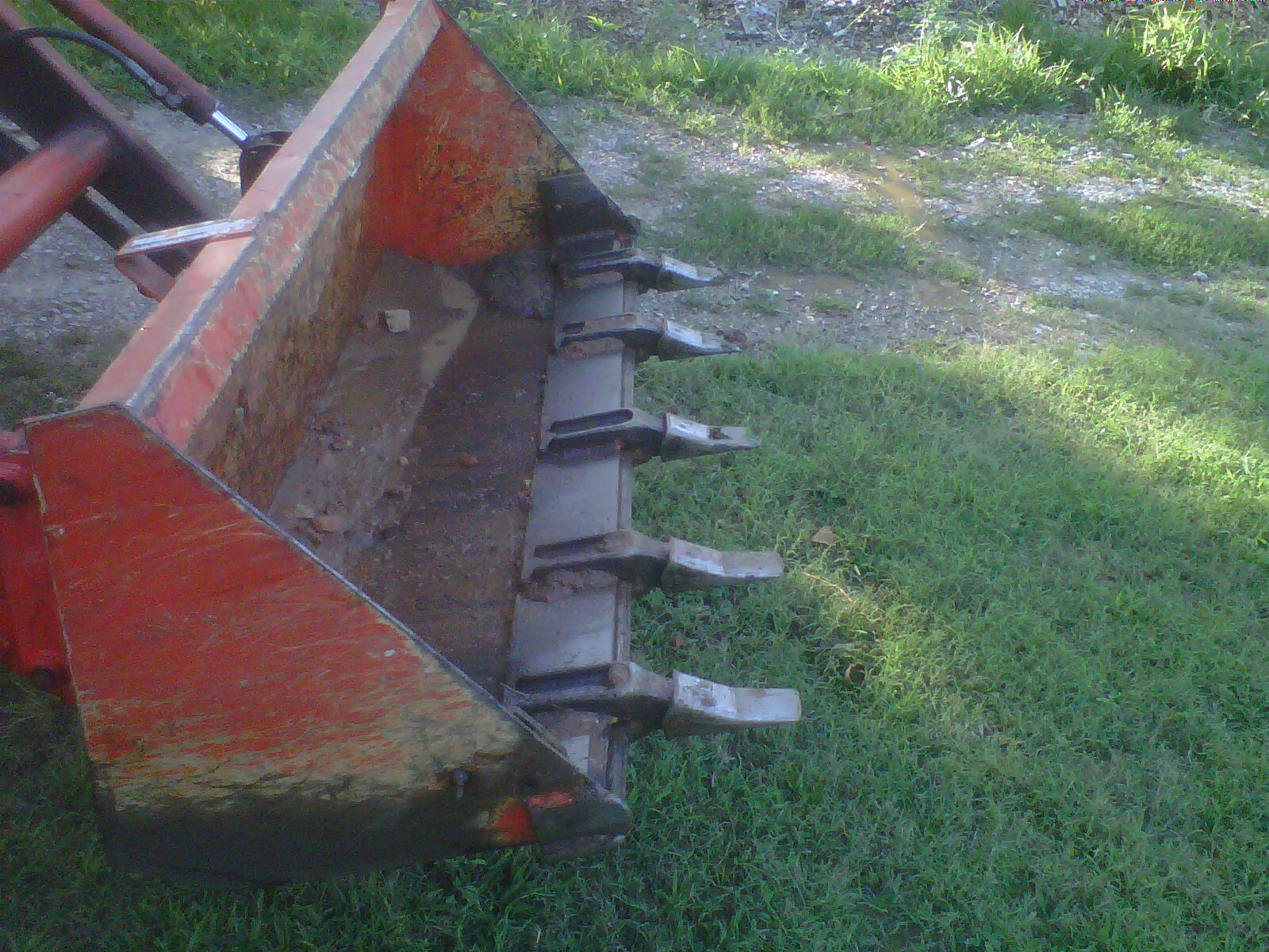

here is the one built, the length of the teeth helps in almost every situation. The only down side of the length is the weight is now transfered past the cutting edge when picking up heavy items.

I'm glad most folks are happy with their piranha tooth bars, but from a physics perspective, they will obviously be somewhat of a compromise for digging (vs a traditional tooth bar).
The ability to pierce undisturbed soil is a function of contact pressure. Traditional tooth bars, having just 5 to 8 teeth, concentrate the entire force of your loader/tractor onto a very small total area. Once the teeth penetrate the soil, it easily fractures the ground into clumps. The long reach of the shank tips past the bucket edge keeps the contact pressure with new undisturbed soil high as your plow forward.
The piranha has a much longer cutting edge, and thus less contact pressure with the soil. In addition, the short reach means you may engage most of the edge at one time when trying to cut forward. The serrated edge is what helps it work better vs. a smooth bucket edge though. Make sure you are pointing the tips into the soil when trying to get started digging.
   / Piranha tooth bar!!! #94
Deezler. Your point is well taken that the ability to penetrate the ground is (somewhat, not the only factor) relative to the contact area. The large teeth on the Piranha serve the major function of penetrating and disturbing the earth. You probably don't realize that the teeth are slightly narrower than the traditional teeth, making the actual contact area of the 8 teeth on the Piranha roughly the same area as 6 conventional teeth. BTW, That was not an accident.
The teeth on a conventional bar are spaced pretty far apart. Any dirt not broken in the area between the teeth, now hits the straight edge of the bucket. The small, sharp teeth on the Piranha penetrate this dirt and fracture it as well. Of particular note, any area with roots, etc. is much more easily cut. One of the many test prototypes actually had the small teeth omitted. Another had longer teeth. Longer teeth significantly reduce breakout force (important when clearing brush) as well as made it more difficult to cut level grade. We used the combinations that gave us the best overall results in building an effective and versatile attachment. The Piranha does much more than just dig.
It was immediately obvious, is that any tooth bar drastically improves the loader's digging performance. Also obvious, the ground being manipulated and the operator's technique made far more difference in digging than did the type of tooth bar.
Cheers!
Harry

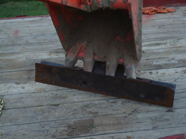

i might be interested in one that would fit over the teeth on a backhoe, maybe 24" long. i currently use a 24" blade over the teeth when needed. this is a great way to cut sod and do finish work after digging a trench. i do belive some people call them squeegies, i have also seen big hoe's use a 6" piece of pipe with holes cut in it for the teeth to go through. in addition the design should have "wings" at each end to assist in capture of the material
