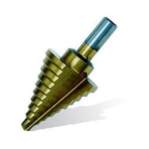

Just ordered one. Can anyone tell me what size hole needs to be drilled for the attachment bolts?
I think it's 3/4. Just buy a 'step' drill bit. I borrowed my neighbors and had the holes drilled in 1 minute.

Yep 3/4" it was easier to drill than I expected. A step drill is your best bet.
   / Piranha tooth bar!!! #107
I couldn't find a step drill bit @ Home Depot, so I just got a 3/4" bit.
It was harder to prevent it from walking than a step bit, but still worked well. The bucket steel is not super hard.
