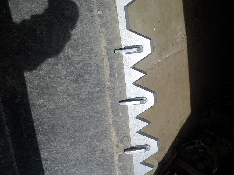

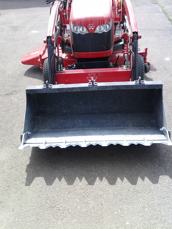

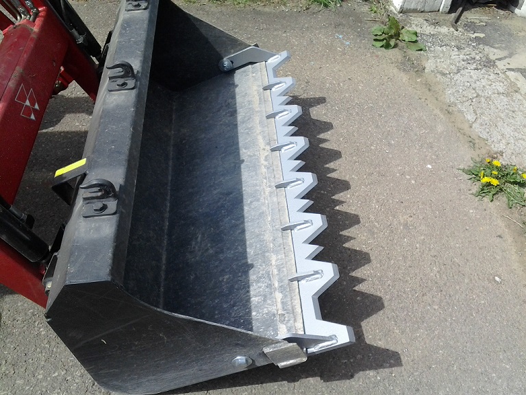

I also purchased the PTB.
I have found(like others on here), that it works great for cutting off brush just below ground level. I've been able to cut some bushes in half(leaving half to continue growing), by using the toothbar to cut through the roots.
Mine came sharp enough to cut through the shipping box, and I received several small cuts on my hands just carrying it to the tractor and installing it.(wear gloves when working with the toothbar)
It works great for spreading gravel from a pile. And after spreading soil, if you backdrag on an angle, it makes nice grooves in the soil to minimize water runoff and hold seed in place(much like the ratchet rake)
It doesn't dig in my hard ground as good as I was hoping for, but it works much better than the flat bucket edge.
I won't include video(not that I have any), but the request was made for BX video only. :)
