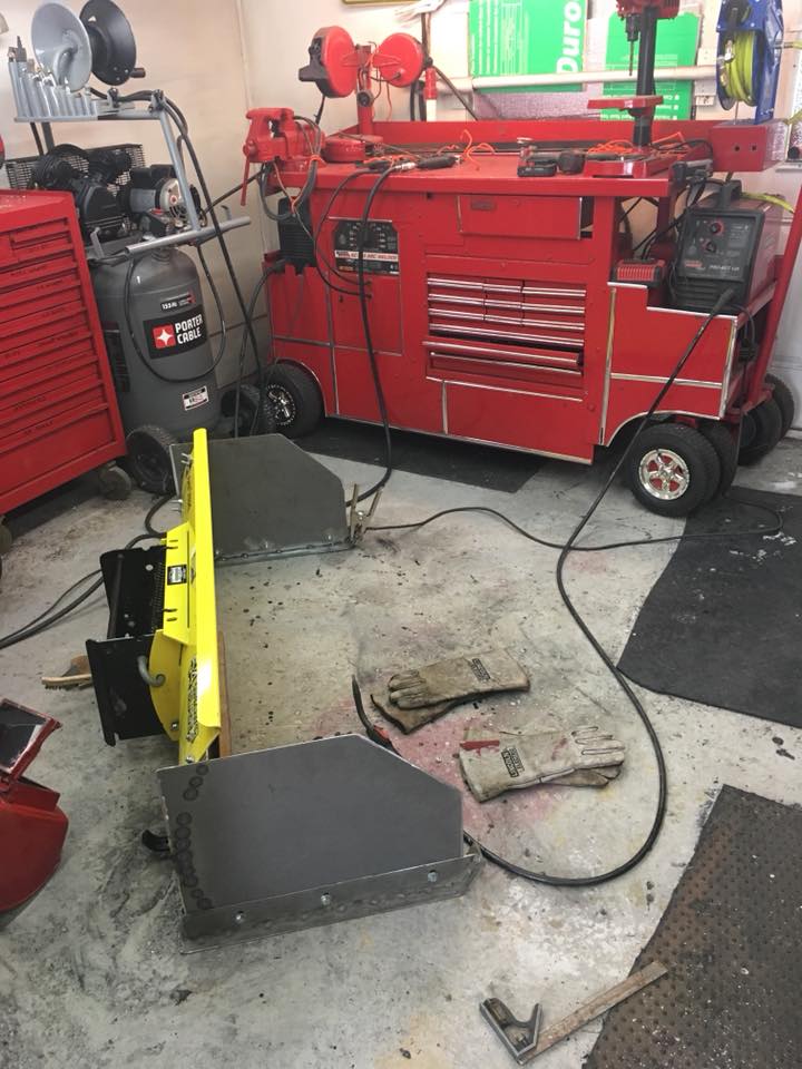

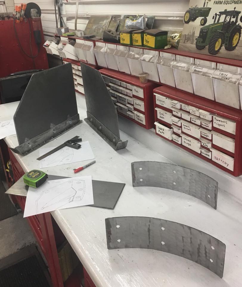

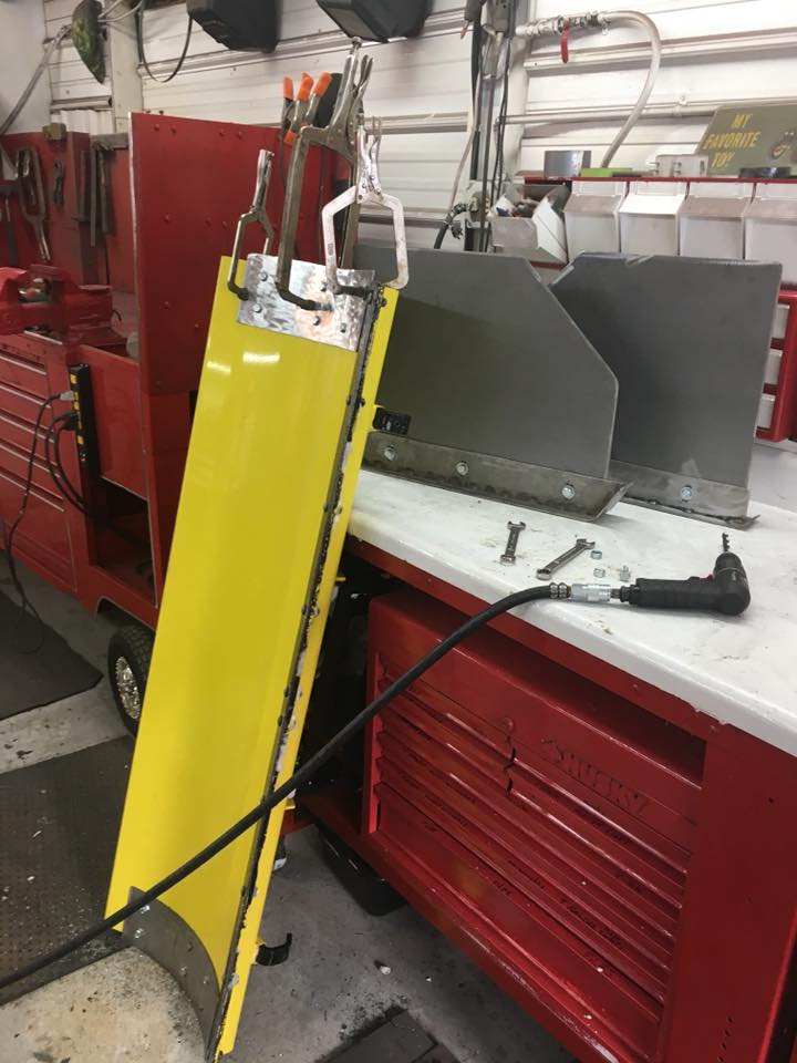

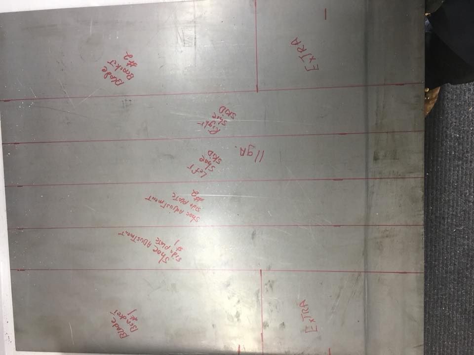

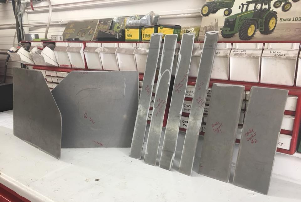

This morning I marked the lines on the steel for the side wings. I got busy with the plasma cutter and got all the edges cleaned up. I got the adjustable skids bent and welded up and bolted on to the sides. I just got the mounting brackets drilled and bent. So I got a nice start today . Our fluffy lake effect snow is easy to push around , I have actually used my 52" snowblower pushing the fluffy stuff a couple times and I saw how the wings on the blower carried a lot of snow. So I think these 20" wings will work very nice. wings 1.jpgwings 2.jpgwings 3.jpg

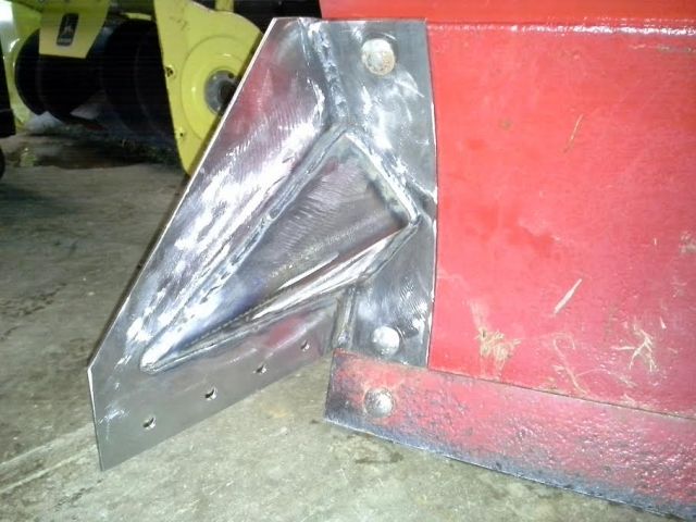

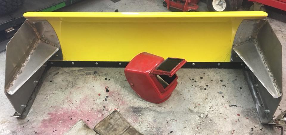

Because of the bitter cold temps I am not working too many hours in the shop but I did get the blade holes all drilled for the curved mounting plates. I welded two of them on each side so they will hold up the wings when mounting them each time. Once U got the curved plates bolted tight I squared up the side wings and welded them in place. Tomorrow I will start cutting out the gussetts.wing bracket 1.jpgwing bracket 2.jpg

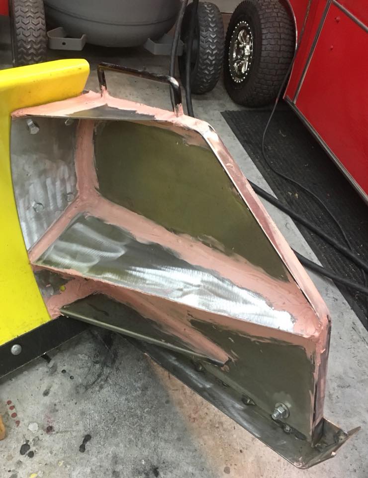

I got the center braces welded in today , just got to cap the front tips. Tomorrow I will cut four 5"x8" gussets for the top and bottom corners and weld them in place. Then a little 1/2 " steel along some of the remaining edges and it should be very sturdy and not too heavy. Should get it done tomorrow and painted. wingcenterbrace.jpg

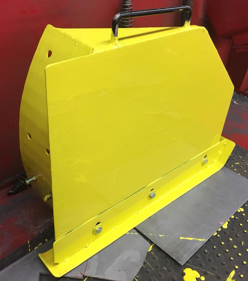

I got the rest of the gussets all welded in place . Also got the front 1/2" lip welded on. Got filler on both wings but only got one sanded and painted. Nothing fancy but better than bare metal left to rust.painted wing 1.jpgpainted wing 2.jpg

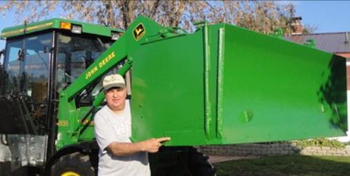

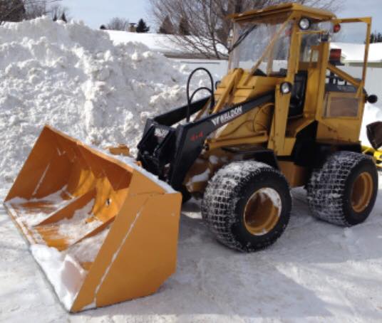

SNOWPLOW WINGS- Its been 18 years since I built these folding wings for my 5000 series John Deere , they worked great. The blade on the Waldon photo used to be a rear blade that I made. Then I converted it to this front blade. Then I built wings for it and decided to put a floor and top on it and ended up with a light duty snowbucket. It has worked great for 5 years now.wings 6.jpgwings5.jpgwings6.jpg

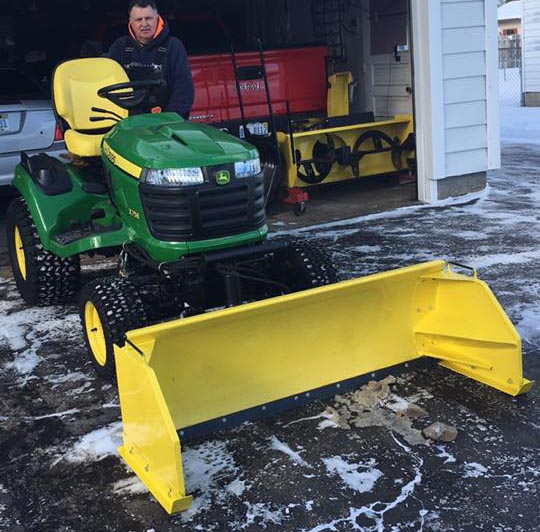

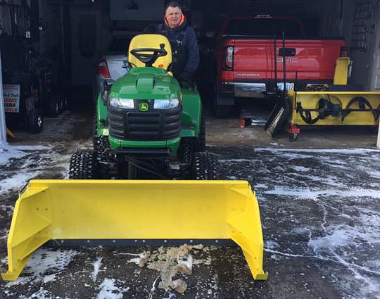

JD 54" Snowplow Wings- Today I got to try out the new wings. They are 17" tall and 20" long. I can't believe how great they worked. I can carry three times the snow now as before. A week ago I had no idea of making them and now here I am using them. That is the fun I have of puttering in my little workshop. My wife just downloaded two You-Tube Videos today of me plowing with the new wings. I really like the way they mount on and off the blade. No center braces to attach. Something so simple to make that work so great. wing plowing 1.jpgwing plowing 2.jpgwing plowing 3.jpg
