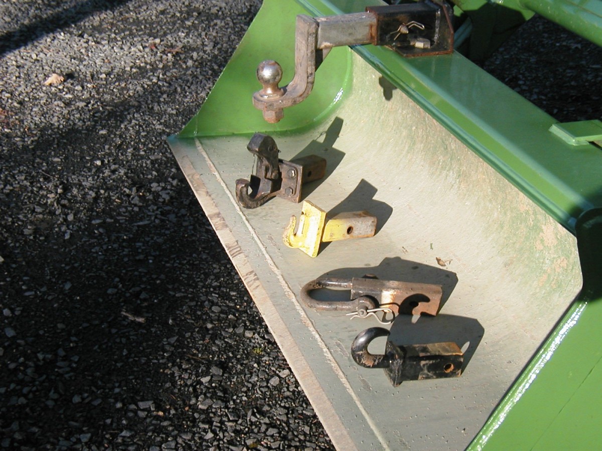

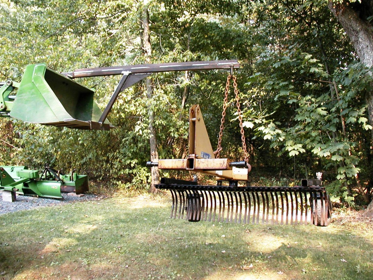

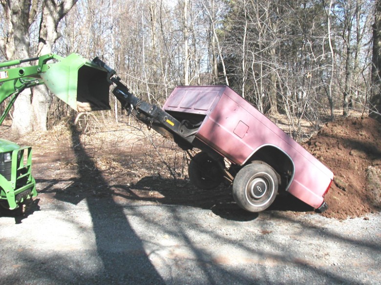

I have a receiver hitch on my bucket that is a must IMO. here's some pics,

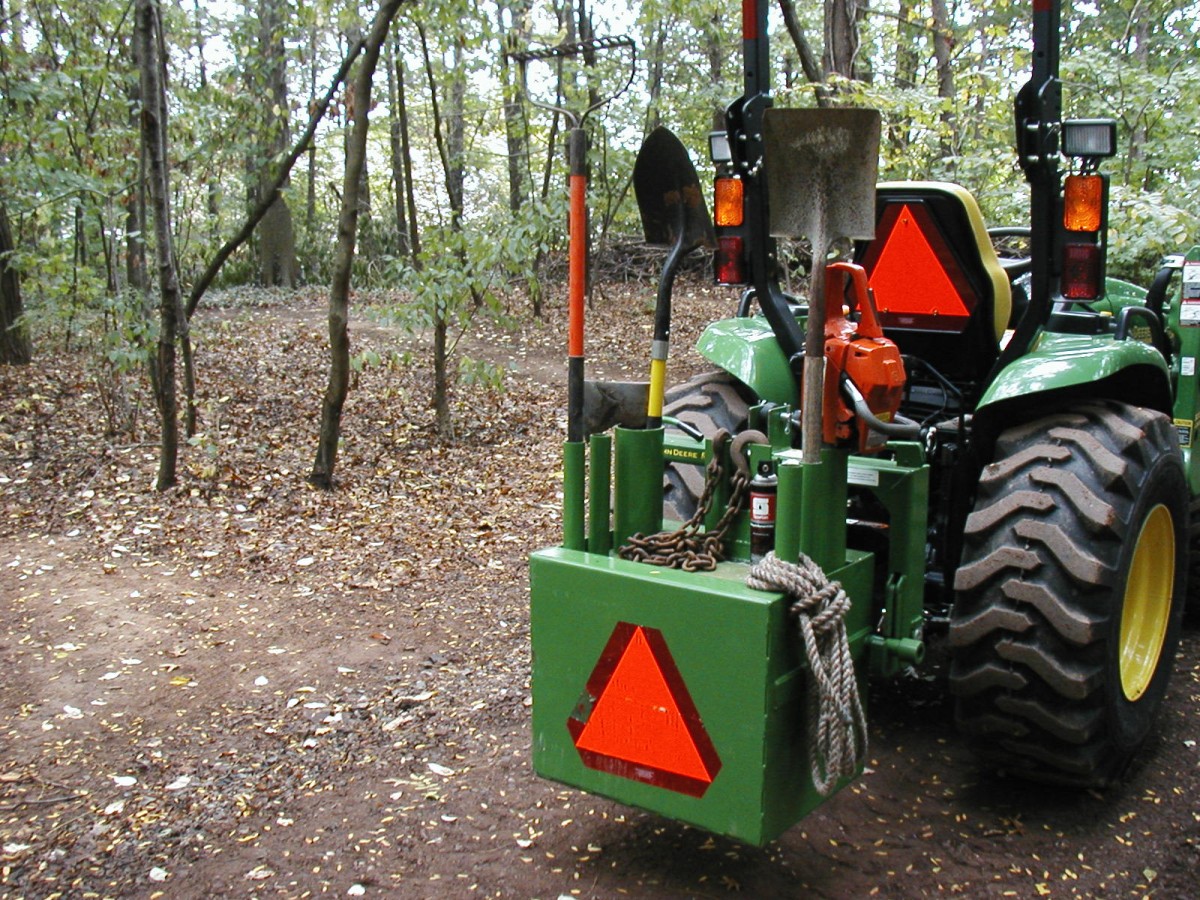

one more pic of the box at work

what if instead of putting pipes in the box, you welded some on the outer edge of the box? you could put caps on the bottom ends to keep your tools from going through, and it would leave a nice level area to haul anything else in the box...
   / Pix of concrete filled ballast box #28
JDFANATIC said:
JB,
Nice job! You'll notice a lot more stability with the concrete-filled box. I just wish I had thought of putting in the pipes before I filled mine! :)
Why not weld 2 or 4 pipes with a washer in the bottom to the outside of the weight box then paint them green to match. If I recall you have a guy next door that could do that. It would still work well and would be thinking outside the box. As another poster said.
