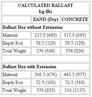

Ballast box weights from the Deere 300CX manual.

These numbers seem high, it shows over 800# for concrete, mine took 6-80# bags=480 + 50# for box = 530# total, leaving 3 inches for shelf storage, seems to be the right amount of ballast for my needs. I to didn't want to limit my options at first, but after 3 years of not changing the level of the stone for different needs and the fact that I needed more traction in the snow, I now think the concrete is the way to go.
