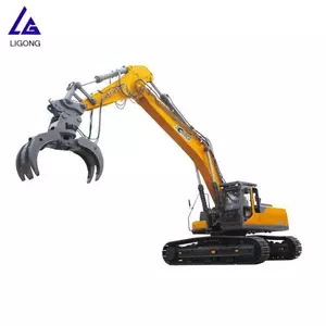

This kind of attachment looks like it would be pretty ideal (with a couple of simple mods) without breaking the bank. The claw can be attached to an excavator or possibly a backhoe.
