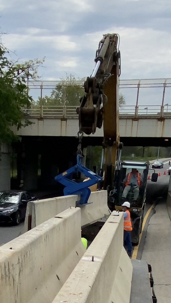

Do you have an Avant tractor dealer anywhere close? They have several different attachments that would do the job. The boom extends, and the mid and large models would reach.
I have never priced out a rental or lease on one of those compared to a telescoping forklift.
   / Placing earth bags #12

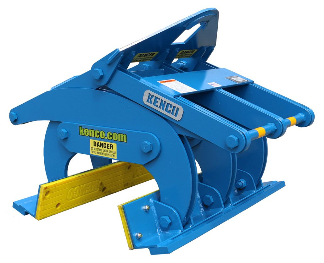

Oops, I missed the backhoe attachment part in your post.
Depending on the durability of the earth bag material, you could use a barrier clamp.
#13
Thank you all for your input! It is looking more and more feasible, but I still have a lot of homework to do. The common size is a 60 pound earth bags - I think 24" x 14" x 4" and would require using 28K bags. Using 36" by 18" x9" means about 7,000 bags in total, but it also requires heavy equipment (machine to place each bag and a pugmill mixer to mix the fill) - each bag weighs in at 250 pounds. These bigs are 15% bigger than the largest bags that have been used before. Why am I doing this? Earth bag buildings are fire proof, earthquake resistant (if designed properly) insect and mold resistant, quiet and MIGHT be cheap. I did not have time to do a proper soil test 2 years ago when I bought the property, but using info from properties around it, I might only have to add about 10 pounds of Portland cement to each bag to stabilize it...actual numbers will come when I can get home and do the test.
