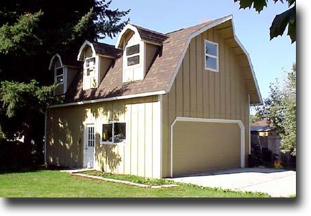

Here is a picture of the barn/shop I am building with dormers. I will only have two per side.
