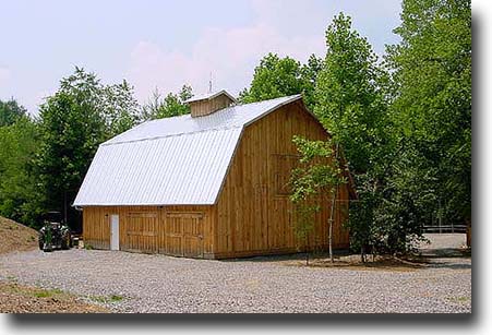

Gary, I'm about to build a barn from barnplans.com, too. I have the plans for the 32 x 40 barn/shop, and would like to extend it to 32 x 48 if the budget allows. The plans are excellent, but believe it or not considering the plans are from Hawaii, they won't pass wind load requirements here in Florida. The plans are rated at 80 MPH; I need at least 110 MPH. Since I was planning to have a local truss plant buld my trusses anyway, I'll have their engineer re-design them to 120 MPH. Dano agrees.
Attached is a barn from his gallery that is similar to what I will build, except that I'm going to have a shed roof down one long side.

You do get some big winds down there in Florida. I was more concerned with earthquakes. I have not talked to the truss people yet. I have to get them to sign off on the plans also. I'll post pictures when I get going on it. Not a high priority project. Good luck with your barn...
