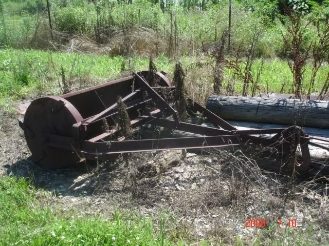

Here are a couple of pictures of two scrapers I have. The first one is the old roll over type. Handy if you don't have anything else.., LOL... And if where you are moving the dirt, don't care that it get torn up from dragging it along. Of course, these we built for tractors pre-3 point hitch...

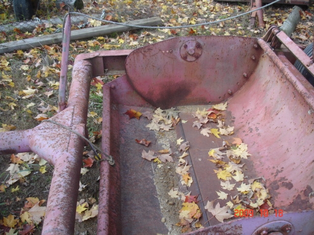

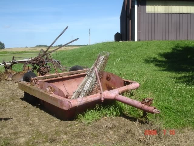

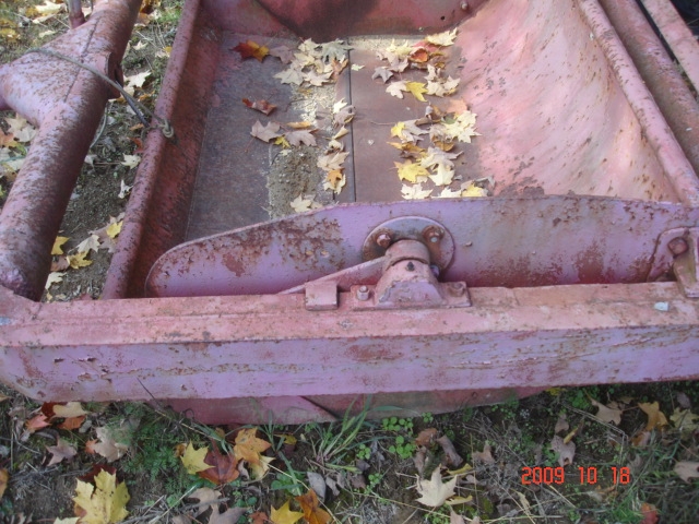

Here are a few more pictures of the old Overland I have. Maybe it will give you some ideas to work with.
The cutting edge is at a 35 degree angle. There is a brace so to speak, to back it up. It goes from near the lower edge, and is welded to the bottom of the bowl. "U" shaped cutouts at the bolts allow access to replacing bolts on the cutting edge. I earlier stated gussets, but must have been thinking of something else...
I think I do like the cable operated apron. Again, I need to update mine by adding a cylinder to pull the cable. It does allow the apron to float when loading. It will let rocks, or larger clumps to go in, instead of dragging it along. Also if there happens to be a rock at the cutting edge, when your finished loading, it may save the apron, or linkage from getting damaged when applying down pressure to close it. But that's just my opinion. The old Terex TS-14's ( green weenie's we called them) we used to run had hydraulic/cable aprons. They would float up and down quite a bit when loading. But we loaded some pretty gnarley stuff. Plus the fact we had a D-9 pushing.. It was going in the bowl, or else..!!

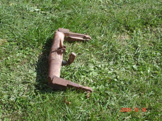

Lastly is a picture of the hitch. Just a simple loop on the front of the scraper to hook into. And something similar to a pintle hitch, on the tractor end. In fact I use a cheapy pintle hitch on my Super C Farmall when using it to pull it.
