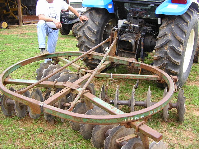

Here is one my BIL bought, $800 I think, 8' if I recall, maybe 9. He calls it a banjo disk. Totally adjustable. You can straighten out the gangs where it'll do nothing but slice straight lines in the field. Turn them in to make a terrace.
