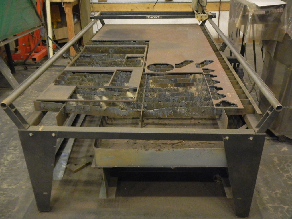

On a few occasions I've played with the numbers on my CNC table, and had it cut with in .007 of an inch. Somewhere around here I have a chart that tells me how much to add to the cut for what size nozzle I'm using.

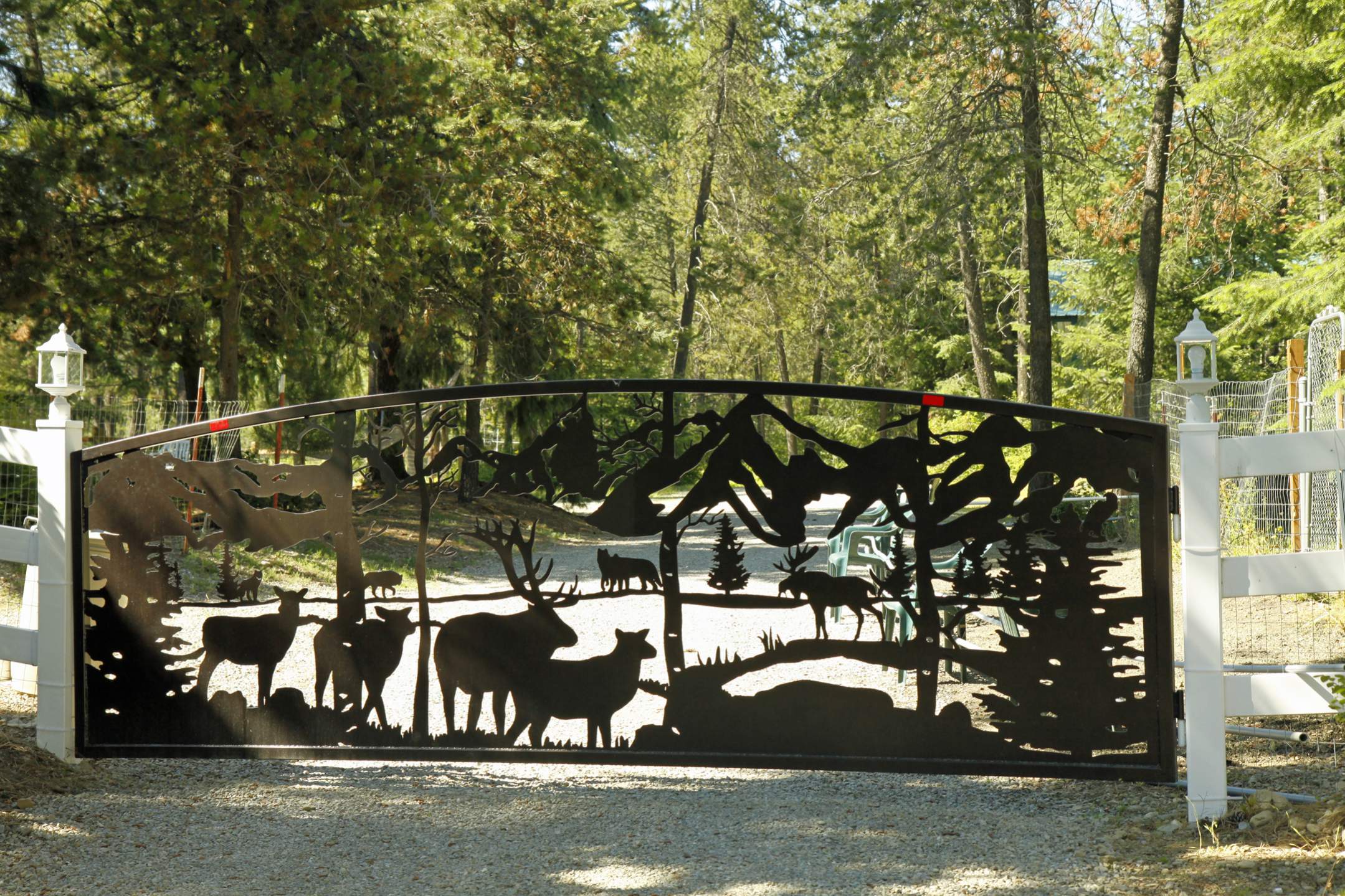

gate reduced.jpg I've also seen the same/similar units used with cutting torches. Ive been spoiled with my plasma table though. I made a chart of kerf thicknesses a long time ago, made it by cutting thru actual different thicknesses of plate metals with different cutting tips and amps/speeds.
The current program that i use to produce my .tap files that control the plasma cutting automatically adjusts for kerf thickness as i render the drawings.
its sure easy to get spoiled.
