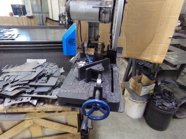

I use a band saw for 90 degree cuts.
A cold saw for angle cuts.
Do not have a oxyfuel. Cost is to high.
A sawsall is for mistakes after it is welded together.
While 95% of my plasma cutting is done on a CNC, I will cut over 1 mil inches this year with one.
I have a jig for my table, that I can cut designs on the flats of angle or tubing.

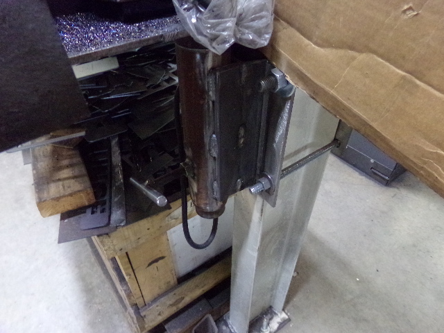

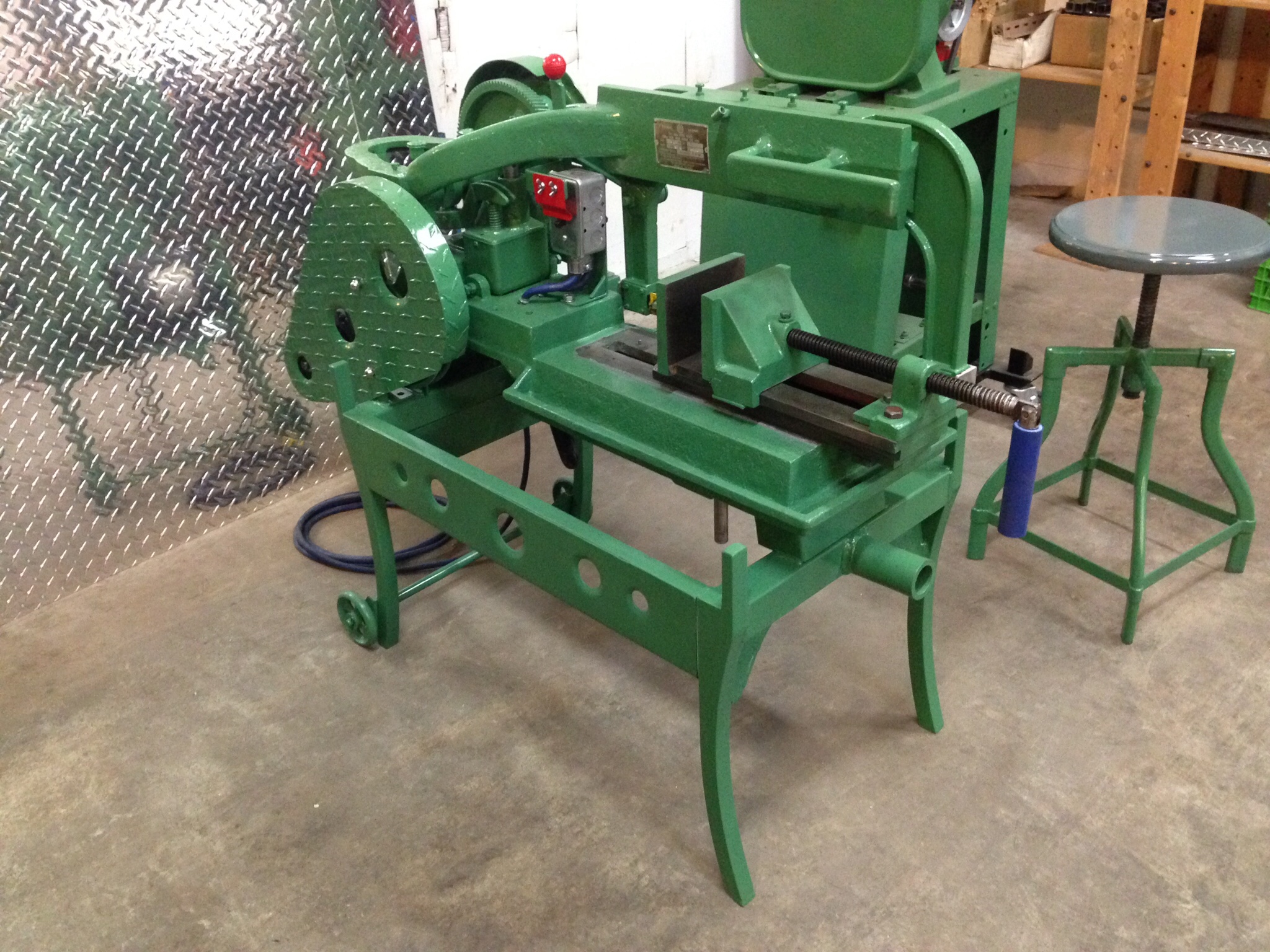

Here how I have my saw setup for angle cuts.
It is on a swivel and I can also change the height.

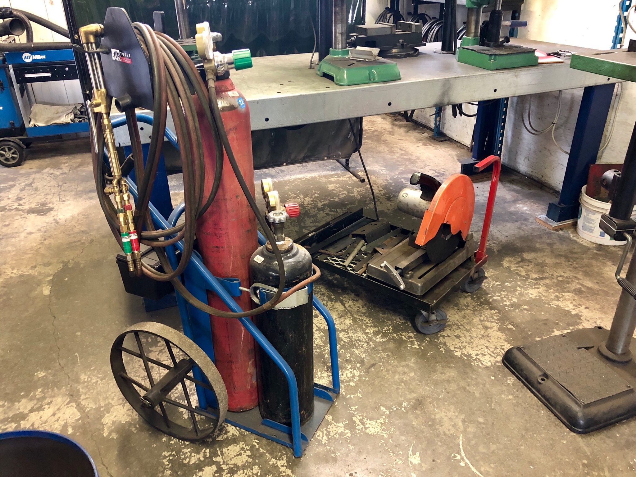

I don't have a bandsaw or a plasma cutter, only a chop saw, cutoff wheels for my 4.5" grinders and of course my OA torch. I have a Sawsall but never use it for cutting steel in the shop. If properly trained in using a OA torch, there isn't much one cant do with them. Cutting expanded metal, aluminum and SS is great use for a plasma torch IF you cut a lot of it but not so much as to make me buy one.
I don't understand why folks say OA is expensive. The gas lasts me for months and even years with my occasional use and it requires no other consumables like a plasma cutter AND I can braze, heat and weld with my OA torch.
