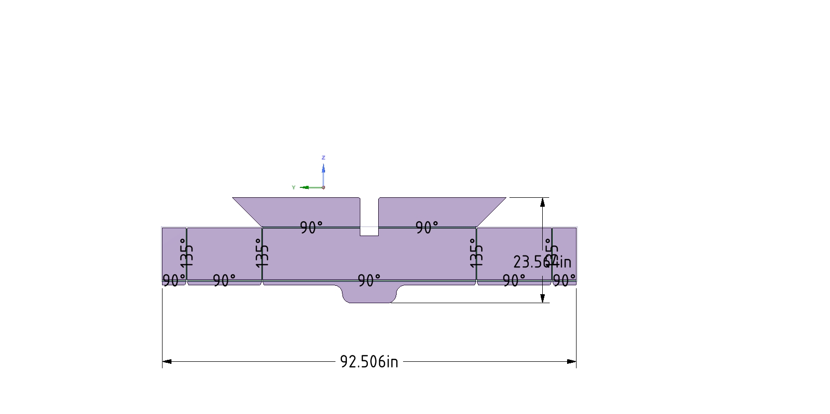

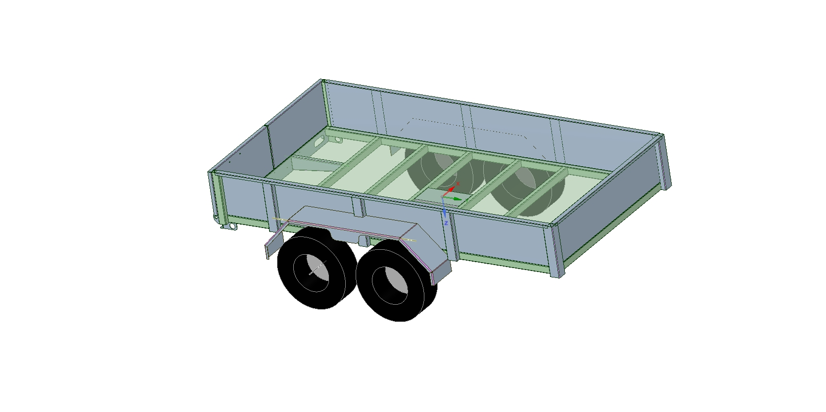

I'm rebuilding the dump box for my trailer and had this idea to make the fenders out of polycarbonate (Lexan). Reason being is I often hit the fenders with the brush guard when loading wood and brush with the grapple. Thought I could get a sheet of say, 3/16" black, and water jet and form it up. Any thoughts or advice?

If it's flexible it might work. If it's rigid and will crack, I say no. Mine are 12ga steel and I have dropped some heavy oak rounds on it and although it bent, it still functions.

If what you were trying bend shattered, it wasn't lexan . I've cold formed 1/8" in a press brake, having to bend it to sixty degrees so it would spring back to ninety.

Same here. Have bent up to 3/16 in a sheet metal brake. When new you won't shatter it. Standard poly-carbonate is soft and scratches easy and not sure how it will hold up in the sun long term. I had coated stuff in my stockcar and the coating started to flake off but the plastic was still pliable.

I'm a BIG fan of plastic parts and black HDPE is what I prefer to use. As I understand it, HDPE is better for impact over Lexan. HDPE and ABS is all I've used.
Here is a tandem axle made of some sort of plastic for $90.
Black Plastic
Universal Tandem axle Trailer Fender
Thanks for this link, ArlyA! I think this is the answer to what I'm looking for. And for the price, I'll buy an extra pair to have on hand.

I was thinking HDPE or ABS--I believe the "polar circles" salmon farmers use up here are welded out of the HDPE and they get bumped and pulled in all conditions 24/7/365 without incident. Lexan is tough but brittle--I think you'd crack it where HDPE and ABS would just lose some thickness.
